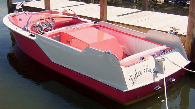

Bell Boy Express 20-23 foot 15 years 2 months ago #32821
:unsure: I bought at a auction a bell boy cruiser with merk cruiser I/o the out drive is very different than any i have ever seen it has a large crank that you crank to turn the out drive clock wise raseing it out of water flush with transome. In a bell boy brousire they say that they used vova penta out drives. I do not know what engine was orignal to boat but it know has a three hundred fifty horse power merk motor that they tell me by the serial number is a corvette block. I belive the out drive to be orignal. this is a very well restored boat. but i am not sure what i have as it looks like a model 404 express cruiser shown the libary site bell boy b58006.jpg but mine is deferent as it has the cabin escape hatch or vent in the center of front cabin window. It also has resed 6 inch lites on each side of bow. it is tilted as a 20ft Bellboy serial number mtz10683e090 year 1960. how about it Bell Boy experts?

Welcome aboard.
I can't help you with the propulsion unit.
The "MTZ..." serial number is a state of Montana assigned hull ID. It has nothing to do with the manufacturer of the boat. So disregard it when trying to ID the boat.
To determine the correct dimensions, measure it. Don't pay much attention to what some paperwork says.
Andreas

Re:Bell Boy Express 20-23 foot 15 years 2 months ago #32848
  • Mr. 88
  • Posts: 547
  • Karma: 13
You have the original Mercruiser out drive.Has the cable instead of hydraulics.Parts are probably impossible to find.Hopefully the seals are all good. The housing if pitted around those will have to be flashed and remachined.Pressure or vacumm test it if questionable,like a car radiator,6-7b lbs and see how long it holds that number. If you search for a older SELOC manual you will find that model listed, thats where I saw it listed recently as I was working on mine.I borrowed it and have since returned it so I am not sure what years it covered. I have a 67 outdrive which I believe is the next generation after yours.Hydraulic with rubber oil lines and a manual reverse lock on the outside of the drive.
