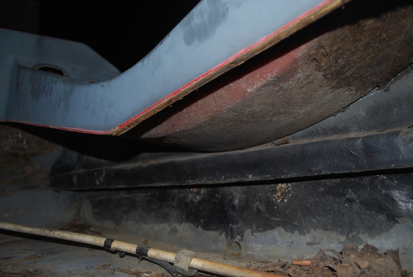

I realized Mark S and I lived within 1.5 hours of each other and bought his 1962 Custom Craft Sea Ray project boat. (It was a pleasure to meet Mark and look at his Glastrons. I guess he and I are the entire Northeast Georgia Classics Chapter!) Mark already had posted pictures on this site of the CC-SR and I will be adding more. Started surveying the boat last night with my untrained eyes and,as Mark stated, lots of work to be done!! My first question: separating the deck from the hull. Is there any reason NOT to do this? The transom is shot and will be coming out. Lots of work to be done on the floor (Mark had already started). Basically everything imaginable needs to be done. I ask this question about separation because someone stated, in regard to this boat in an earlier post, that he was not a big fan of removing the deck from the hull. There are about 300 staples (steel apparently) that need to be removed. Does anybody have a trick for that? I just don't see anyway to do the work on the boat that needs to be done without taking it apart. Also, if I take the boat apart will I need to run straps around the hull to help maintain the shape, correct? I need advice from people who have done this. Will try to post some pics tonight.

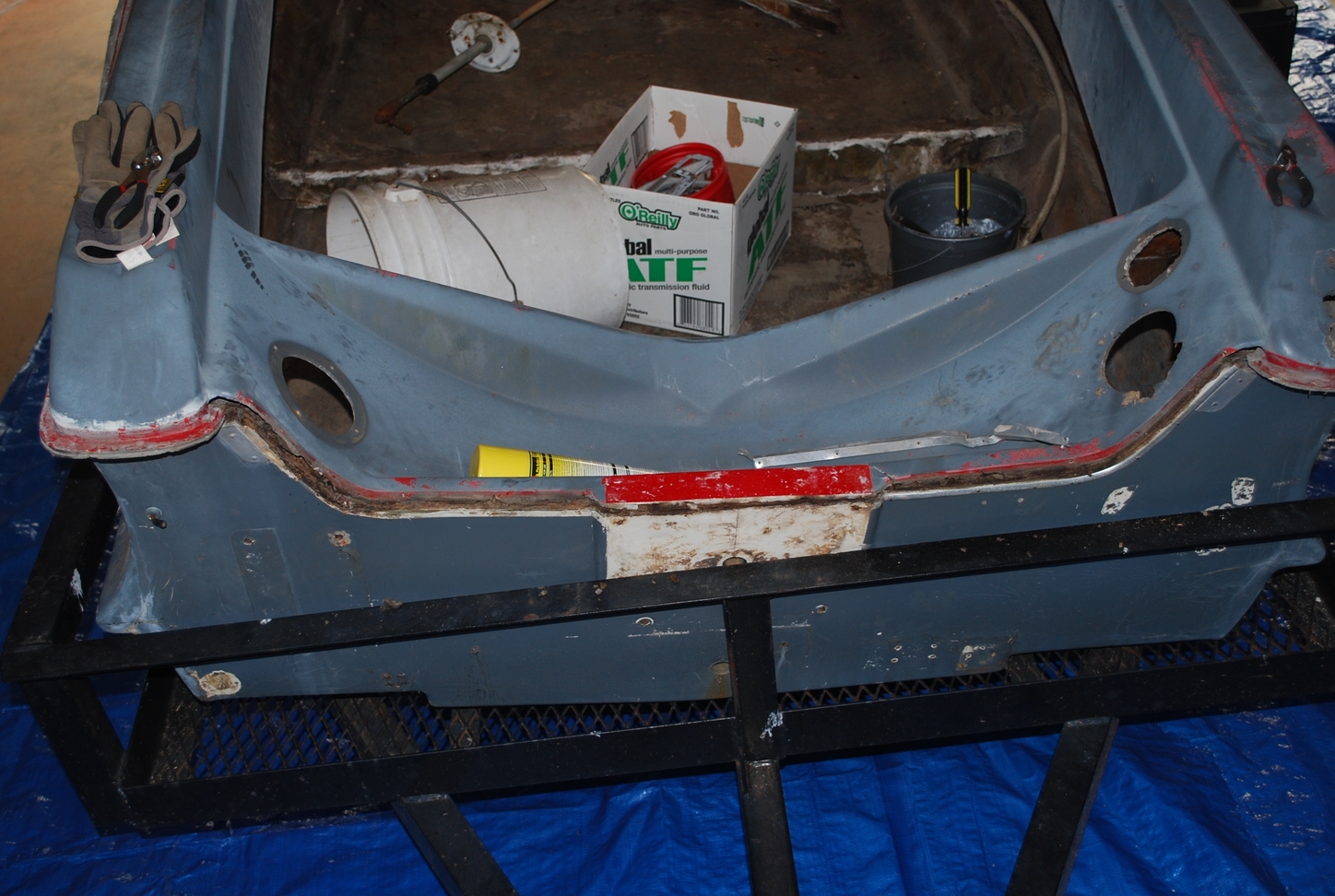

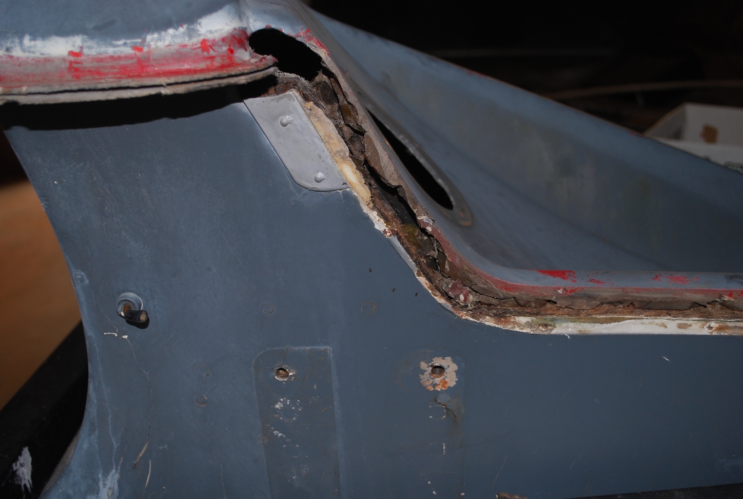

Update: 5/25: All staples were removed last night, but when we started to lift off the stern we realized the deck was glassed to the hull at the splash well/transom area. I bought a key hole saw to take this off tonight. I am concerned about trying to rebuilt the transom. I do believe we will be able to use the dust-vac to take it out; certainly don't expect anything that would be usable for a pattern. Advice at this point? Also, what is the black 'bar' running under the splash well?

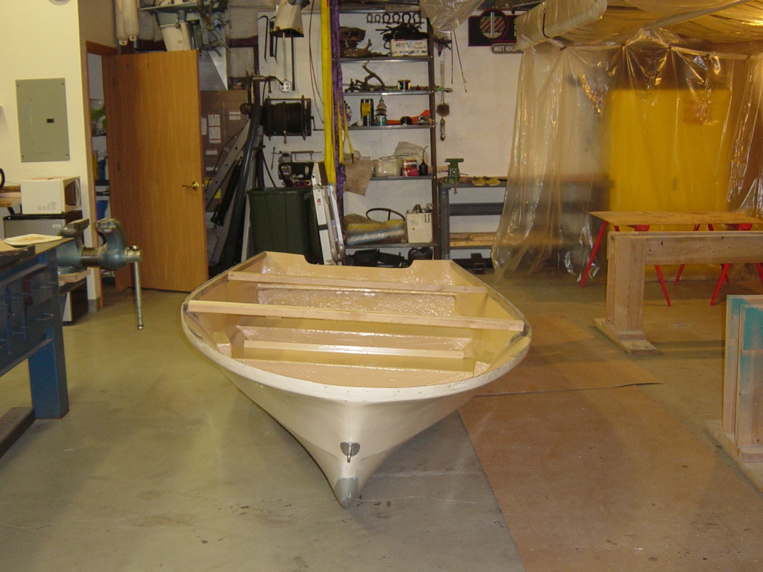

After removing the top I cut two 2X4 to the correct length and screwed through the rub rail area into the end of the 2X4

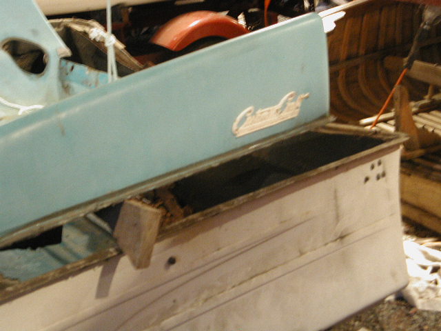

U.G. CONGRATS from Chattanooga.. YES, I believe I used those words
on transom activity.. Each mfg or even model is different shape, so
the owner really needs to balance time , money & final usage.
Items like a orig 16" short shaft transom , going up to modern 21" transom.? not needing the both side holes for pully system steering,? & splashwell cond will factor towards a transom replace with the deck still attached..
Andrew has a 61 custom Craft up here, where we started to cut a feew different angles into the splashwell, so it will glass back into a clean design. Some of us Glasspar members will have a gathering up here July 8-9 & you F.G.ers may enjoy attending / displaying... Before that need to contact Andrew G. as his commercial ship schedule can change every 4 - 5 days.
Again CONGRATS on your collection, Write anytime.
. PS always looking for Glasspars if you get a lead.
Did not have a good pick of removed Splashwell.

Thanks for the picture. So, as long as I properly brace the hull to prevent inward/outward movement I should be able to keep the deck off as long as I need to to do my work?
