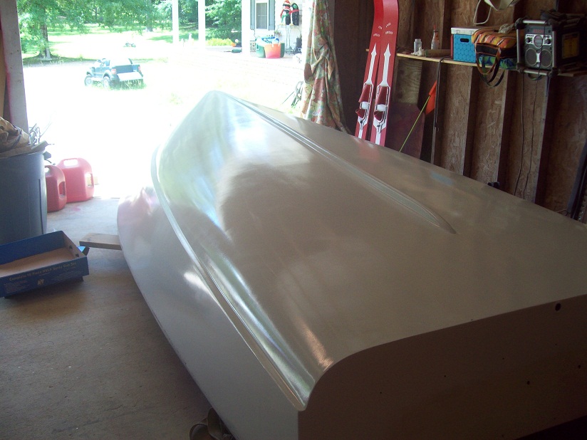

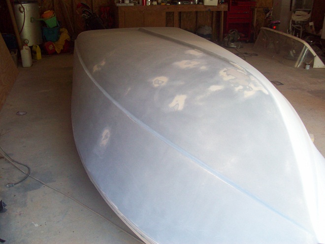

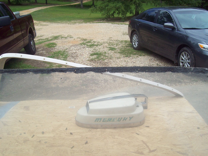

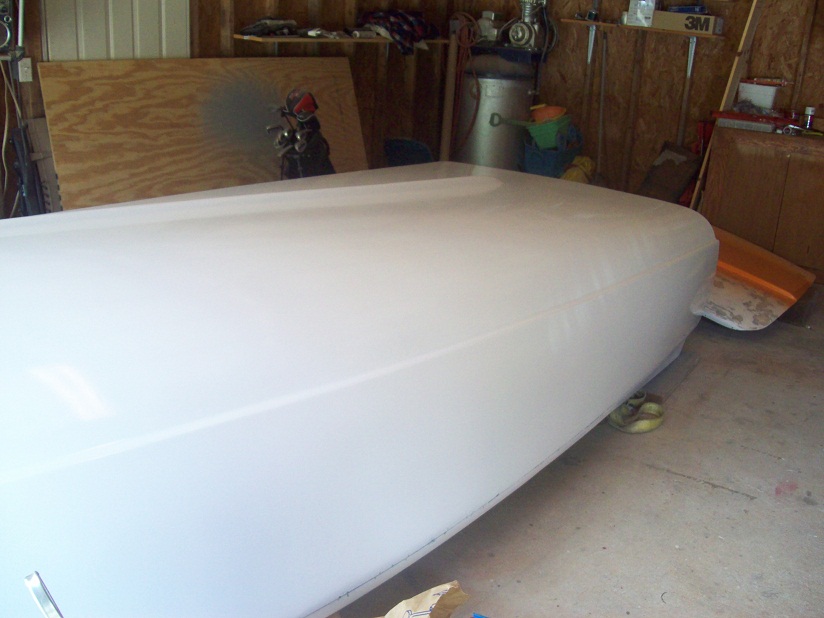

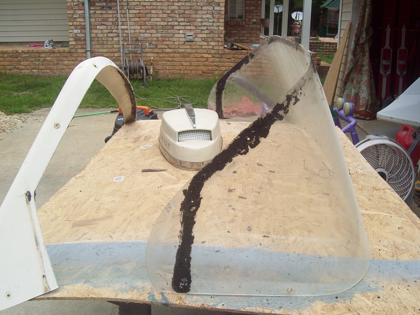

Bottom is looking good with 3 coats of brightside. Might put one more before flipping. The other pics are of the windshield before I stared scrapping and sanding. I guess the person thought more is better!!! What a mess.

Hull is looking awesome. I used Brightside on the interior of my boat and loved it. Went on easy and looked great when done and I used a brush! :laugh: The windshield on the other hand, WOW, don't envy you with that one! :S
Re:Invader Bottom and Windshield Mess 15 years 3 months ago #32248
The hull looks great Joe, nice work. I don't envy you the work on the windshield, but at least it's in one piece, right!? :laugh:
Re:Invader Bottom and Windshield Mess 15 years 3 months ago #32249
Smooth but thatis a mess on the windshield .

Thx All, Well quite to my suprise the goop on windshield came off easier that I thought. Scraped the stuff off with a 5 n-1 and then wet it with goof off and let it soak and then came back with 00steel wool and it came off pretty easy... Now have to try polishing it up..

Wow! That looks great. What condition was the bottom in when you started?. Also, would you mind sharing what your process was?

Thx, It wasn't in bad shape. I had to fill a couple of places where cut off wheel went through hull. Just sanded with 80 then 120 and primed and painted.
