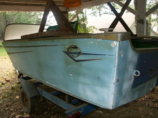

Metallic gold? boy can I relate. As a young 'un, I desecrated my dads boat by "making it cool" with metallic gold spray paint over every inch of aluminum trim. So I was extra regretful, when some thirty years later, I undertook the task of getting it all off there. I guess I didnt prep to well, and nature had already started the removal process.

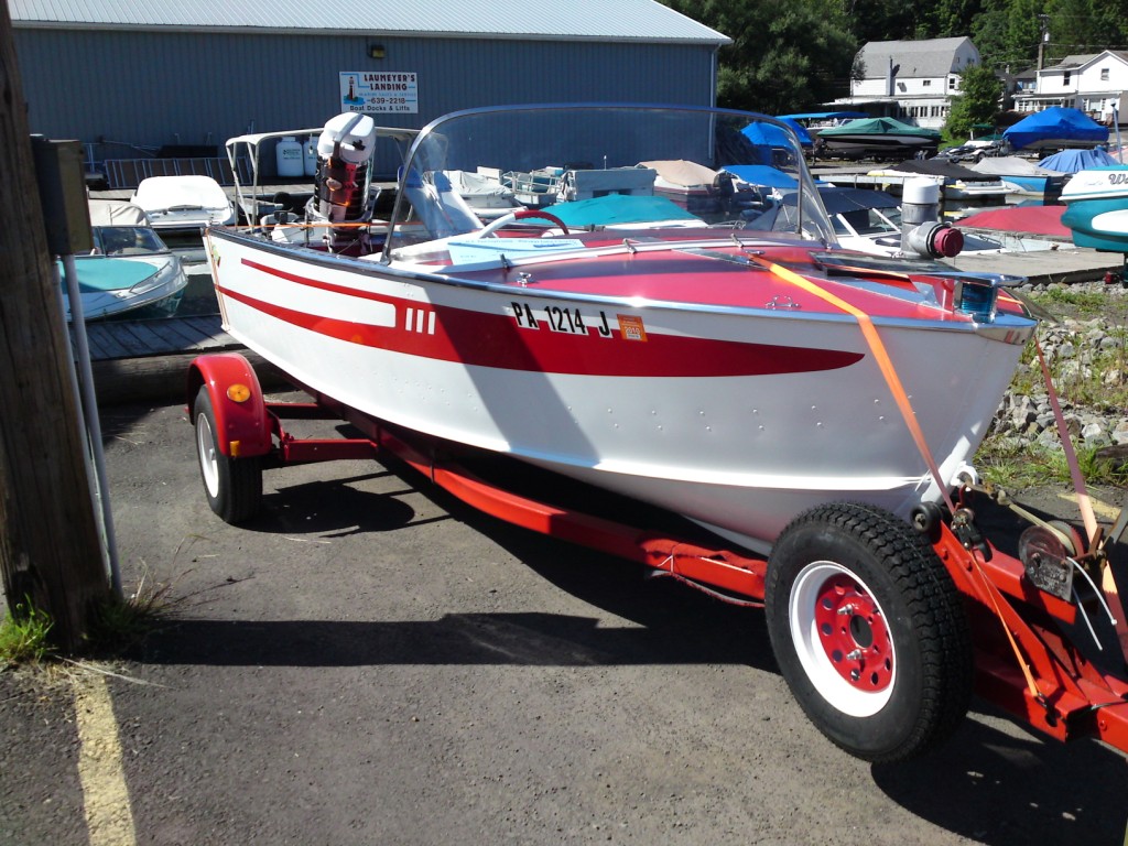

I soaked it pretty good [along with the entire hull] with paint stripper, then what remained on the aluminum was taken off with a wire wheel on a drill. The softer brass wheels were less abrasive, and I worked toward finer grades, then to sandpaper, then to various steel wool and buffing wheels. The end result was worth it. The aluminum shines as new.
Before:
After:
Re:Chrome & Aluminum Cleaning. 15 years 3 months ago #32608
