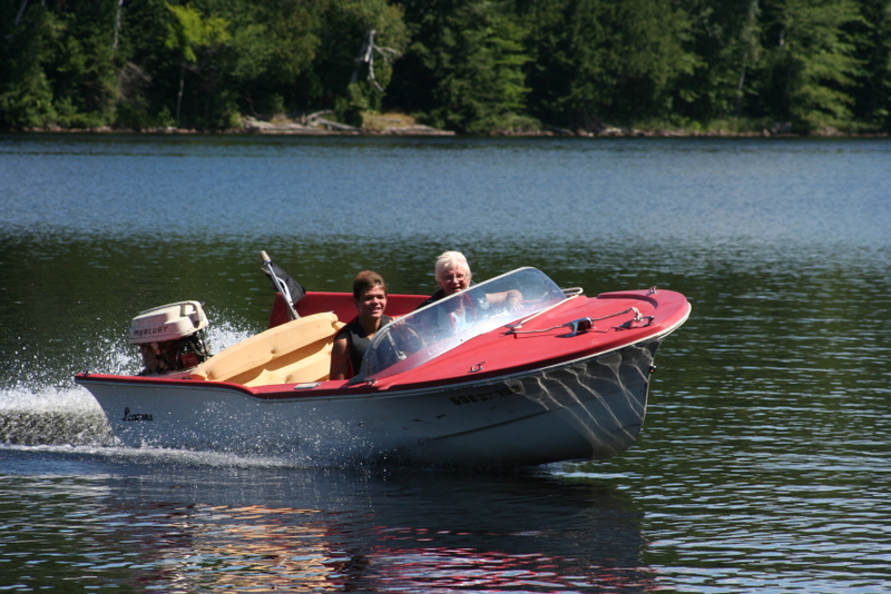

Over the last 20 years it has gone in and out of service for one reason or another and now I want to bring it back. The picture doesn't it show it well, but it has great bat wings. The wake/splash it makes has been the most unique on the lakes we have been on—you can identify it from miles away!

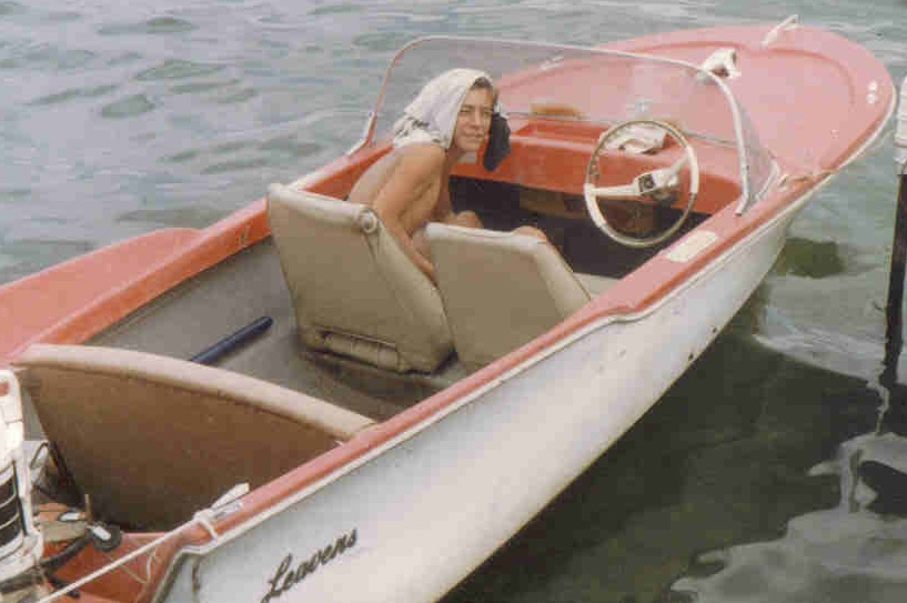

That's a cool boat and the family history make that more special(is that you shivering in the picture?)

Thanks for the input everyone. Im looking forward to starting work on it. Yep, that's me a long time ago! I'm in the middle of a move now so I'll have to wait a couple of weeks.

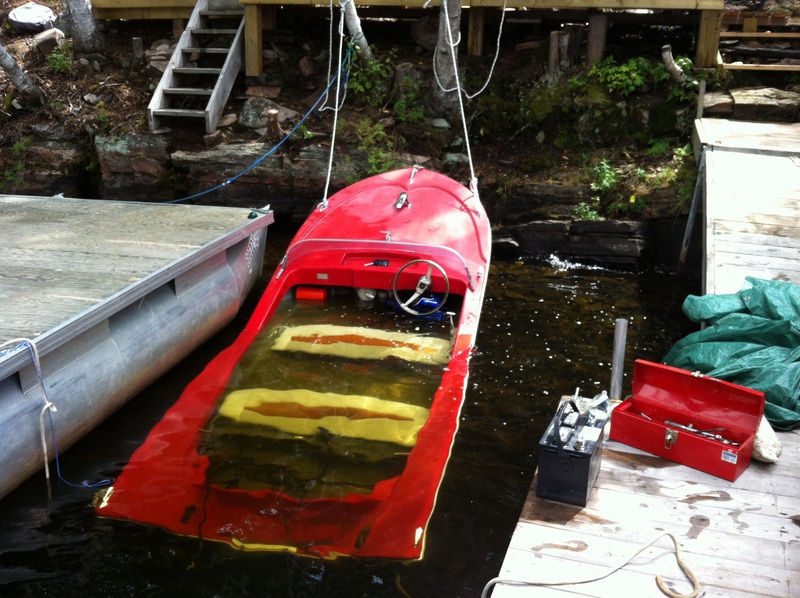

I never did get to the point of working on the gelcoat. I did sand and repaint the hull though. After that, we had it back out on the water for a summer (see the pic of my kid and mother). Then, near the end of the summer there was a heavy rain and the bilge stopped working...and of course it sunk(see picture, this is after pulling it to shore). After that it was neglected for yet another summer.

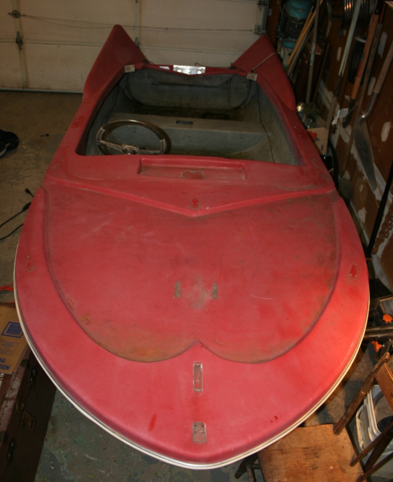

But.....now I'm back at it, only now I have the engine to rebuild as well. It is in the garage (getting the garage cleaned out was a major task in itself!), naked and ready for gelcoat work.
