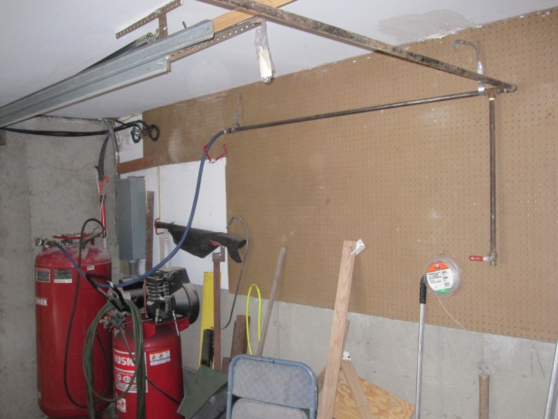

Worked on this yesterday afternoon, finished this a.m. and tested for leaks. Found one, fixed it. Got almost 40' of black pipe before it gets to the outlet nozzle, and as you can see from pic 1 to pic 2, have a substantial drop across 24' (width of my garage) with a drop and valve at the low end (on the pegboard) and another short drop just before the outlet nozzle.

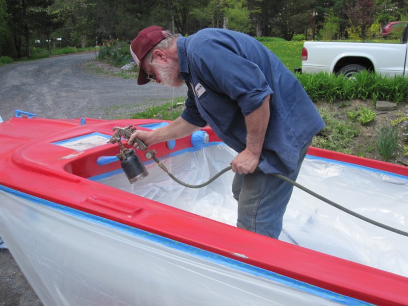

Paint on deck! 15 years 1 week ago #31699
Along with a bunch of dandelion fluff!
Thanks to Dave Cummings (kingdve) for driving over and spraying the deck for me. He da man!
Frank

F - Got your Manta money. Dave want to spray the 18DC too?! Working on sanding and prepping, but don't have a lot of time to devote to it.
OMG! Just saw Gail's Subaru in the background and hope you moved it before spraying!
B
Re:Air system set up for spraying paint 15 years 1 week ago #31727
So I understand B. Maybe get together sometime this week?
Gail's car was well away (up by the road) when Dave got here, but I liked that "OMG" thing. :)
Frank

i have a small suggestion ,if you havent already put a water trap on your system,i suggest that you do,i learned that the hard way when i first started painting,also drain your system after every use.

John, I think I have a water drop in the first pic in the 1st post above. You can see where my 24' line drops 12" to the west wall of the garage and there's a drop right there.
Yes, I am religious about draining my compressor after every use, but it's good to suggest, as a lot or people don't do that.

Hey PC Looking good .I was looking at your setup there .Do you have the compressor pumping into a secondary tank ?? If so thats a great Idea .Ive got 2 60 gallon 6 HP compressors . I plumbed the pair together with a shut off between them so I can opperate each together or individualy .When I sand Blast I run them both and have tons of air . If Im painting Ill run 1 and have it pump up both tanks .When the air from the first compressor hits the Cool tank of the nonrunning one your water will condensate and drop out of your air .If you draw off of that cool second tank threw a good filter Youll be clean and dry .I helped set up a couple of Body Shops I worked at this way . Another Tip is to run a air intake for your compressor head to the outside of your shop .Just takes some PVC pipe and a couple of fittings .Youll get cleaner air going into your compressor and it will live longer , Your filters will need ALOT less cleaning and youll be surprise at how much Quieter your shop will be .Not trying to be a smart butt . Just some tips for those that dont know .
Re:Air system set up for spraying paint 15 years 1 week ago #31765
Yes B, I have a 110V 26 gallon belt driven compressor that fills my old 220V 60 gallon tank. That was a noisy one. 2nd time it threw a rod I tore the motor off it and set it up as a spare tank. The 26 gallon one is on an integral two wheel cart and can be disconnected and rolled wherever I need it. I have a filter for it, but didn't have time to run to get the right adapters to plumb it in Saturday. I will soon. Plus I want to get a few of those little filters that fit right on the gun to have around.
Got a picture of an air intake set-up? Sounds like a neat idea, but I'm having a hard time visualizing it.

On most compressor heads you can unscrew the Air filters .I just got some treaded PCV pipe the same tread as the air filters Screwed them into the head .Then with some PVC pipe and elbows brought it up close to the cealing with 1 inch PVC and drilled 1 inch holes threw my wall Just below where the eves would be . Ran the PVC threw the walls .Once outside I got the treaded female end of the PVC pipe then screwed my filters back onto them .A good share of Compressor noise is from the air intake .Quiets the shop down Ild bet 75% .When your spraying paint if your sucking air Threw your filters your Clogging them up with Over Spray to . Not to mention Dust and crap when your sanding .A compressor drawing clean outside air Threw Clean filters is a effient , Long Lived Happy one ..If you put a Electric house fan to blow on the compressor head to cool it that will make them live longer to and probaully help cut down on water .Cooler the head is the cooler your air output will be and the longer it will last .Ive had both of my Cheaper Fleet Farm Compressors for over 16 years .Besides a couple of drive belts and some New preasure switchs they still work as well as the day I brought them home .And when they say drain the tanks often Please do .Tanks can rust from the inside out and weaken .Do a Google search on Exploding compressor tanks once and see the Damage they can do .They could take your life .Imagine all of the Energy Stored in a 60 gallon tank at 135 PSI being released in a 1/2 second ..I dont want to be standing next to it .Sometimes we take our Equipment for granted and dont think about the forces around us . A friend of mine hired a Summer kid to work at his tire shop .The kid tried to put a 16 1/2 inch tire on a 16 inch rim .It went on but when the bead tried to seat ...Well they Buried him 3 days later ..Not trying to be preachy here just saying for those who might not know .Ild hate to here any of my Fiberglassic family getting hurt or worse .Now dont even get me going on Cutting Torchs ...L.O.L..
