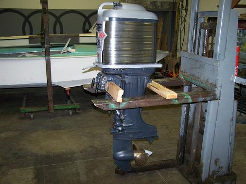

My mind says I can but my body says no way.
Be careful guys, these old motors are just flat dead weight.
First thing is health and the second is dropping one of these old girls and breaking something.
Be safe.
This guy helps me out a bunch.

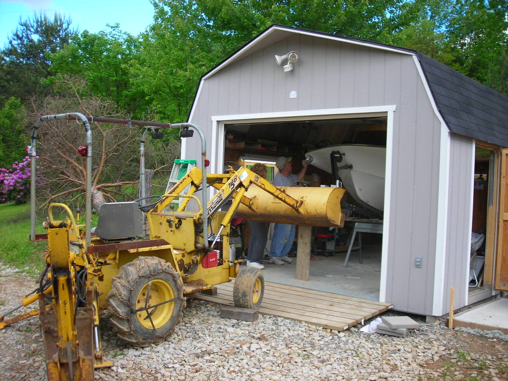

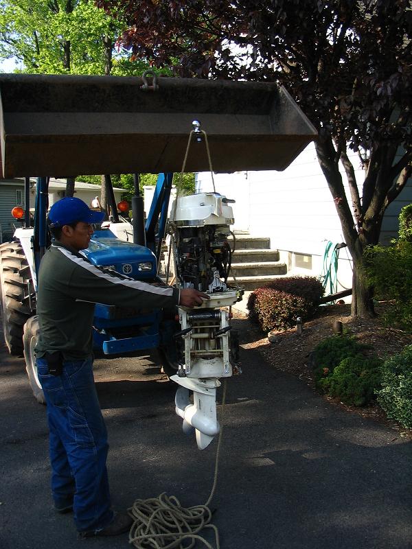

I use a block and tackle and if I can get to it I go with the front end loader.. Thats my Favorite way to go ;-)
WHOOP WHOOP!

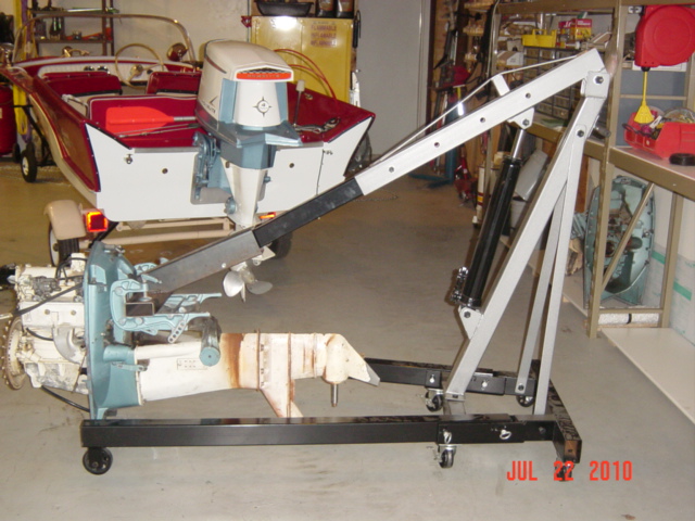

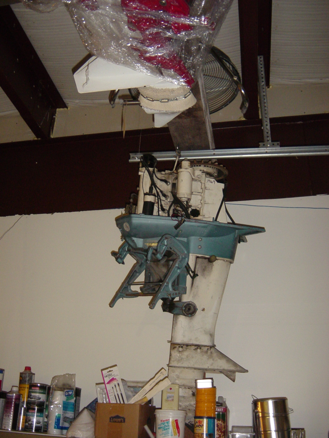

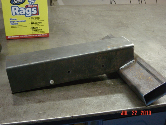

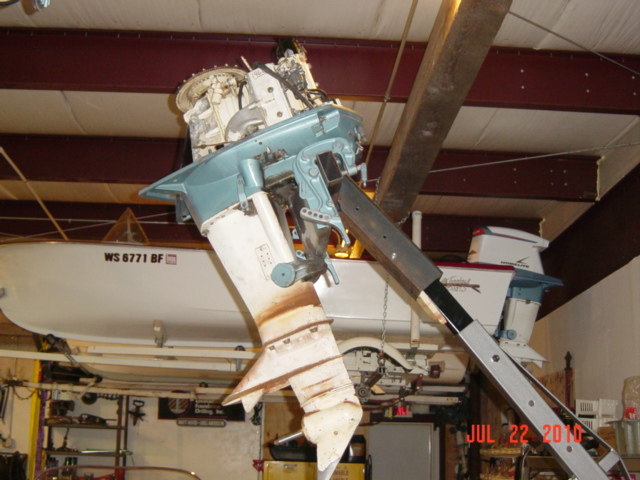

To help save my back and create space I hang most of my motors from the ceiling. I laid awake nights figuring how to be able to do it by myself.

Greg, that is awesome! Really clever. How do you get the engine off the lift and mounted overhead?
I have a 13' overhead (exposed trusses) in my garage and have been trying to figure out how to hang my projects overhead and out of the way. Can you post a photo of how you rig the boat/trailer?

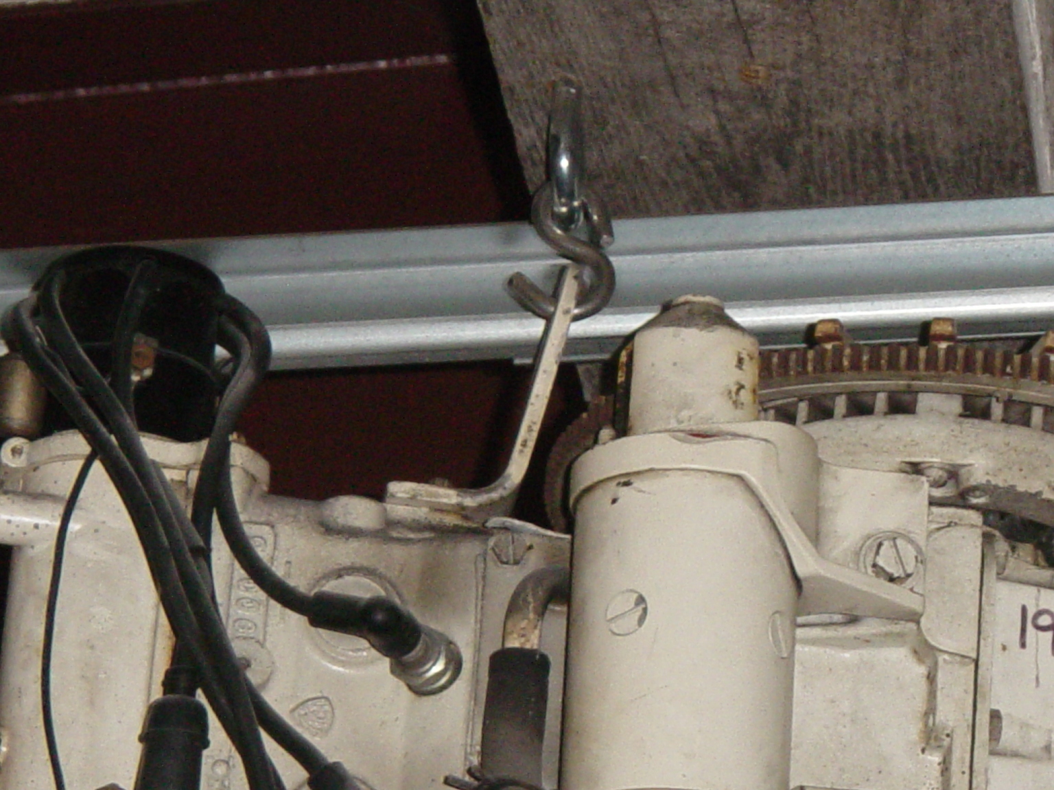

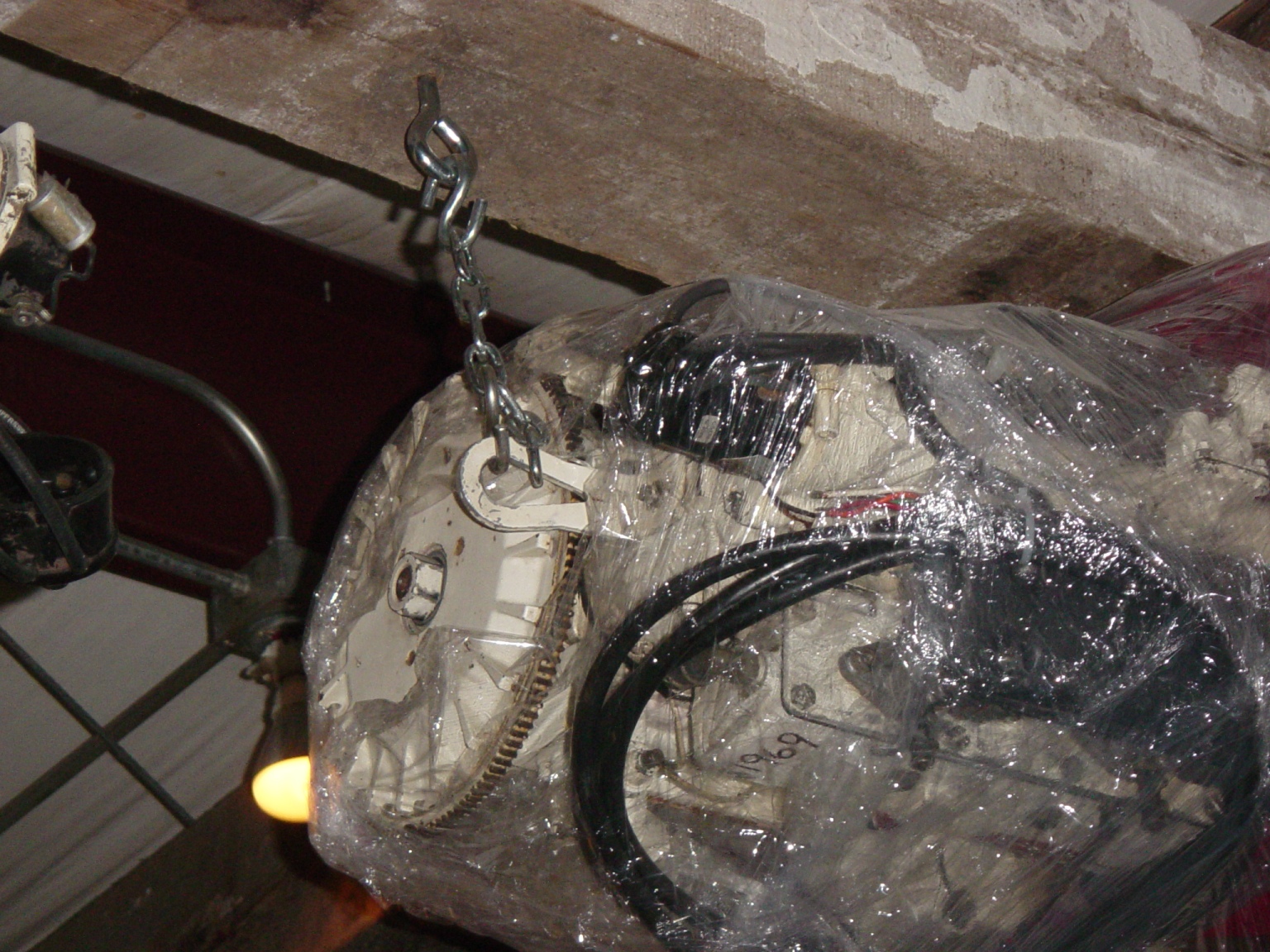

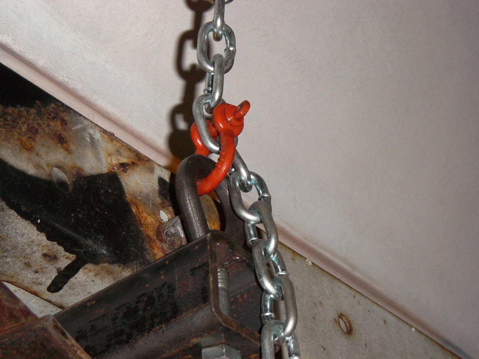

The motors are lifted up to the beam and hooked to a 5/16" lag eye bolt pre-drilled and screwed into the wood beam. Most of the motors hook directly between the motor lifting ring and the eye bolt or lag hook bolt. If they don't I use a short length of chain.
Hooked with a chain.
Hooked direct with "S" hook

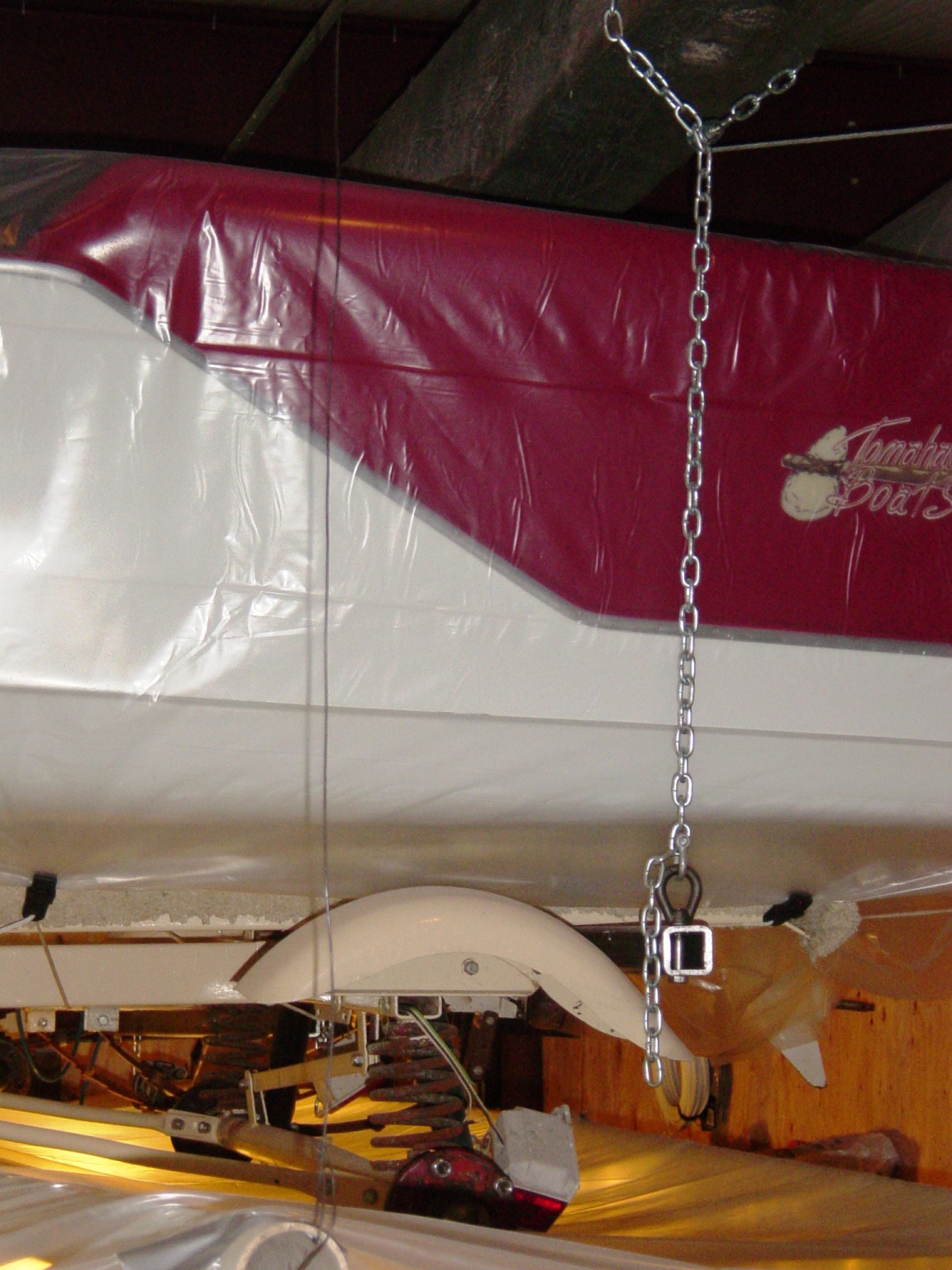

I have three boats hanging from a set of wood beams with room for one more. Each boat is hung with two length of chain from the wood beam to a 2"X 2" X 1/4" steel tube running under the trailer at the axle. At the axle assures the same hitch weight as if was hooked to your truck. I have the boat trailer hitch hooked the a piece of u-na-strut connected to the ceiling.
I lift them with a bobcat with fork extensions.

Greg,
This is very impressive. As I have been scratching my head trying to figure out how to sling the boat and raise it up into the overhead, i never considered hoisting the whole trailer/boat package. I have wood trusses, and planned to spread the load with 2-6x6s laid over several of them. It makes a lot of sense to run a 2 x 2 x 1/4 square tube under the trailer frame next to axle. Unfortunately, I dont have a Bobcat or fork lift to hoist the boat up, but I have access to a couple of chainfalls, which could get the job done.
I think i will leave my motor on the ground though.
Thanks for the reply and the photos... very cool.
