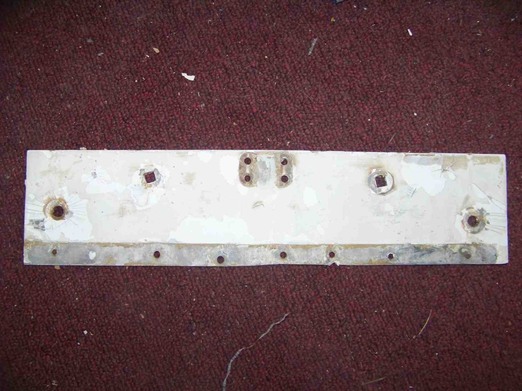

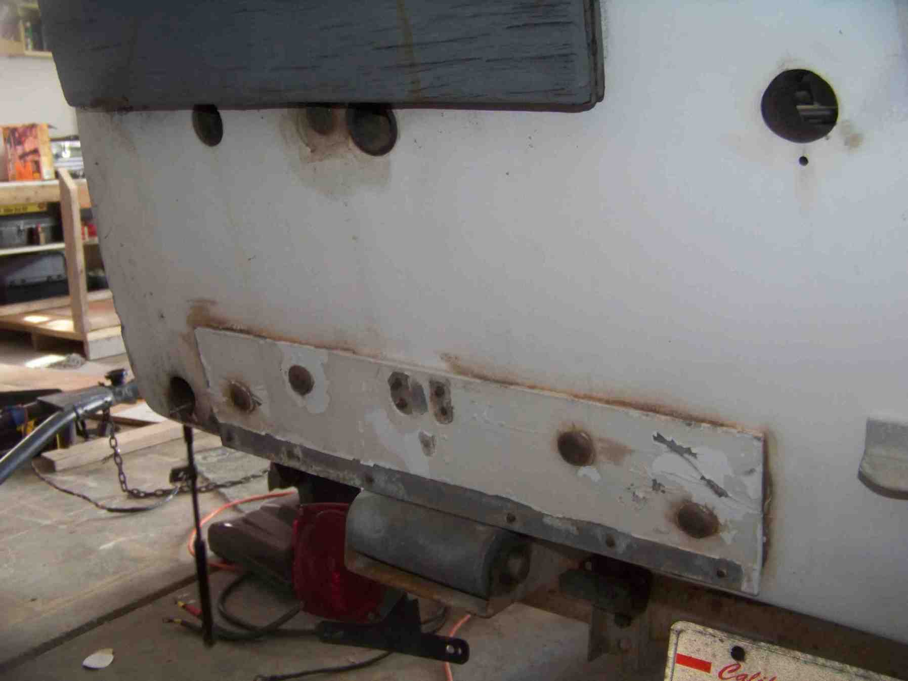

If it worked right, I attached a picture of the one plate which is still attached to the boat, and another picture of the other plate which I have already removed.

From what you can see of the plates, it looks like there was a hinged section that came out perpendicular to the remaining plate. And, it looks like there was a support attached to the top center of the remaining plate that I can only assume attached to the lower hinged plate. I'm guessing it may have been adjustable, retractable, or both.
I've had problems with leaking in the past, so if these are not necessary, I'd like to do without them and patch up the transom solid. But, if they have a truly useful function, I'll put something back there to serve the purpose.

yup, those are hull mounted trim tabs...just as i suspected.
Re:Anti-Splash plates 15 years 3 months ago #31433
I also agree that these are trim tabs. Someone was probably trying to stop the boat from porpoising.

So, if I'm understanding right, these tabs won't do anything to prevent the splash. If the boat has not been porpoising without the lower part of the tabs present, they probably are not of any use to me. Somebody may have had a larger motor on it at some point?
The best thing for me to do is get the distance of the transom to match that of the motor, seal up the holes where the tabs were mounted, and go from there. Right?
