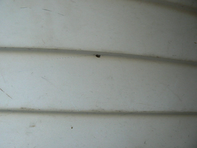

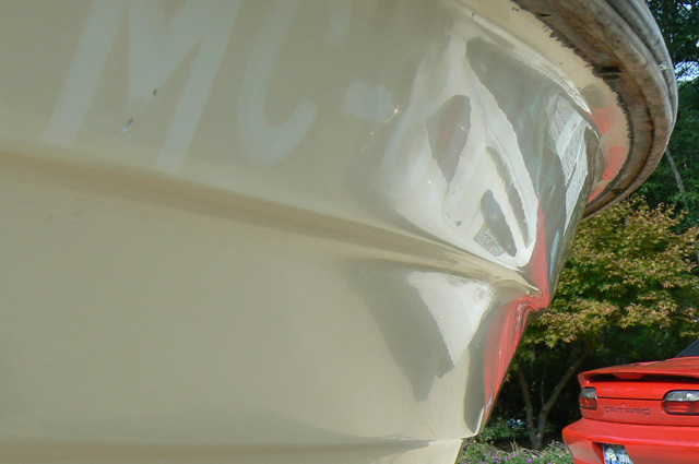

I agree with Professor and Madprops. Here are the before and after of my hull:
Before wet sanding and rub/polishing
After
Yes that's my grand Prix in the reflection, parked about 7 feet away. No substitute for the hard work IMHO.
