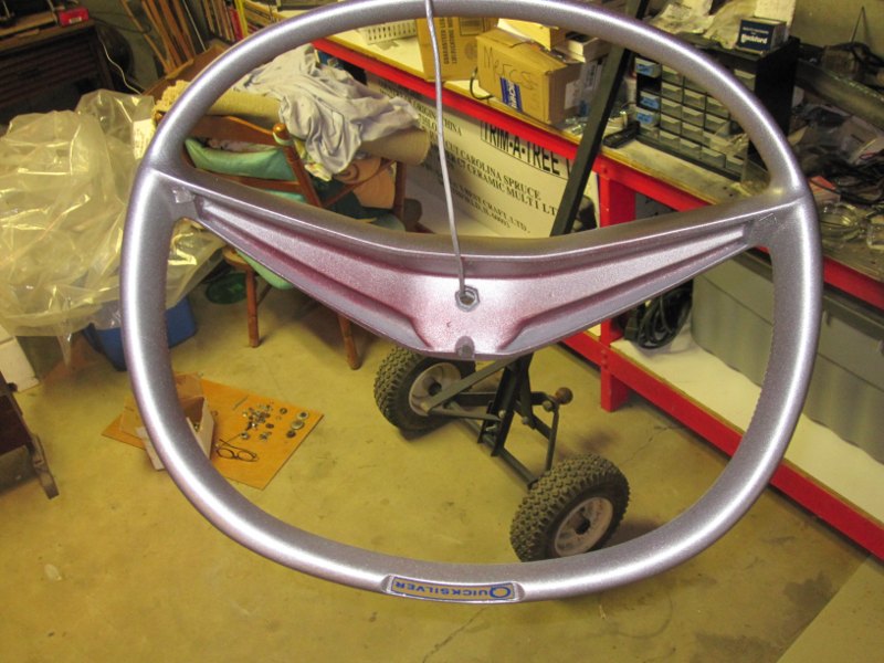

Changed the color of my steering wheel from red metallic to silver metallic today, then applied an OEM Quicksilver sticker right where it belonged and clear coated it 5 times. The red tinge in the center that you see here is covered by a black metallic plate, soon to have the Power Cat logo on it.

Re:Minor project 15 years 3 months ago #30571
looks awesome I wish I had your talents :)
Re:Minor project 15 years 3 months ago #30577
Gee thanks, but it wasn't too hard. Roughed up the old clear coat with some 220 (I think), cleaned it with acetone, gave it 3 or 4 coats of rattle can silver metallic, then 4 or 5 coats of clear. The stuff I use you gotta re-coat it before an hour, and after 10 minutes, so after sanding and cleaning, it took a couple hours to do with a bunch of 15 minute breaks in between coats.

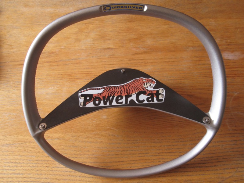

I made the faceplate from a thin piece of aluminum plate to replace the old cracked plastic one.
