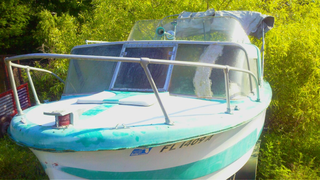

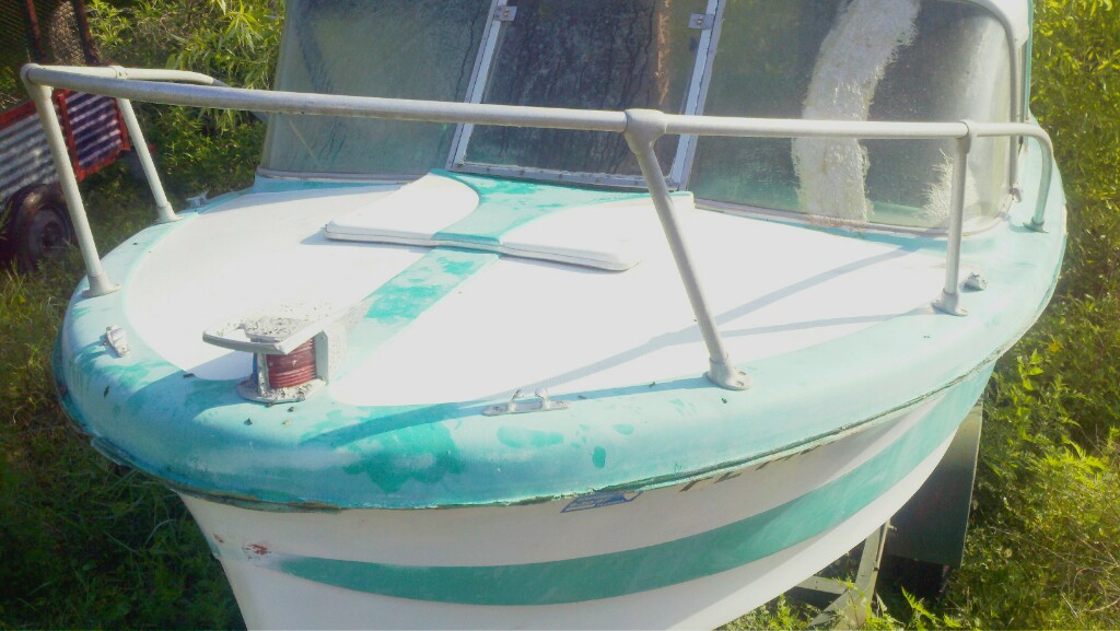

I am new here. Looking to restore a 1960 something cabin cruiser. I found this hull for almost free. I don't know what it is. Its worth restore and buying original outboard when I find out what it is.
[img] [img]http://www.fiberglassics.com/media/kunena/attachments/legacy/images/3kd3ma3p35V45X15R0b4f81ca37633e161dd7-20110423.jpg

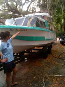

new pictures of boat, looked at it this morning looked solid, almost all there. Looks to be top piece and bottom. Held together by molding. A: is this molding replaceable? B: back half of boat was cut!? (knuckle head) can this be joined or will it always break? P.S. Not scared of glass work!

A: The water line graphic stripe is common to LARSON , Here is big LINK to our library www.fiberglassics.com/library/Larson
. We were just north of Orlando a few weeks ago with our mid 60 cuddy cabin at the Mt Dora show. You have a very nice hull there.
Any outboard that is reliable will serve you well. Does not always have to be from 1960, There are some factory brochures at the very bottom of the library LINK. A 70 hp from the mid 70's would work , as some of trhe early four stroke motors, to enjoy the chain of lakes in your region.
AGAIN CONGRATS
PS, Side moulding or soft Rub Rail can be re-ordered, NOS may be expensive, look for Old Stock , I had got some in Tampa DON SALVAGE, quite cheap... Back Cut .?? NOt sure your comment, early 60's were two different lenght outboard's. If your vertical height of transom NOW is about 16 INches , someone cut down for a Short Shaft version. Current standard now should measure 21 inches on your boat.

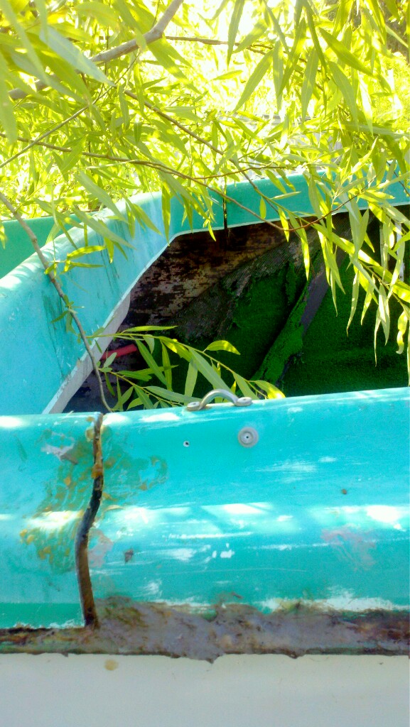

Here its the damage done by knucklehead. Hope they didn't ruin this boat. If some tells me this is fixable I'll bring her home.

A: Looks like someone was going to make a OPEN style sunliner style out of the cuddy boat.? Just a saw cut that can be glassed back together .? Tought to see in the small pic.
Re:Help identify this glassic 15 years 1 month ago #30543
it looks like someone cut that loose to get at the transom to fix it,the transom is probably soft,and instead of lifting the whole deck,they cut the gunnels,so check the transom for rot,if there is a motor on it ,then put it in the up postion,then push up and down on the lower unit,to see if the transom gives,then if you can stick an awl into the transom wood.
if the splashwell is cut loose like it looks like ,lift it off and check the transom from there,john
Re:Help identify this glassic 15 years 1 month ago #30544
Thanks so much for identifying this Larson!! knuckle head cut the top to instal inboard!!!???
Yeah, that's why I named him knucklehead, then shaved off curving glass (lip) that the molding went over. If someone with experience tells me this is fixable I'll do it!
p.s. I found this larson, the hull is different but the top canopy and windows are identical!
www.billscars.com/Boat%20Pages/1961LarsonSeaLionHTP.htm
Re:Help identify this glassic 15 years 1 month ago #30545
I think you are right about transom...not really scared of repairing transom, its the top deck repair that concerns me.will I be able to repair that cut and not have it crack in the future?

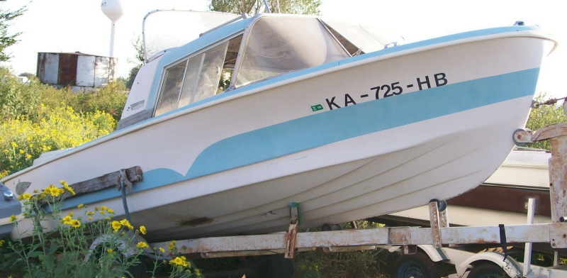

Here's a pic. of a 1962 All-American w/factory hardtop... :)
Re:Help identify this glassic 15 years 4 weeks ago #30606
Thanks knee boarding tom for the great pic! So iis mine an all american with cuddy cabin option, worth the restoration?

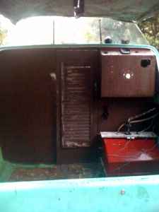

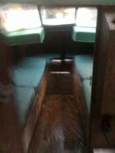

after a little more research I doubted this was an all-american because it's listed as 16ft, my boat is 19ft.?? bow its taller and longer than all-american pictured. Is the same hardtop, same hard top on sea lion. I believe the hard top is taller. Curves back just a bit to accommodate. The wood for back of cuddy cabin.

Mine is a 1962 model. I think yours is a year or two earlier than mine, and it could be a 186 instead of a 166. I'm not sure if you would consider it rare or not, but I've seen less than 4 or 5 with the factory hardtops.
