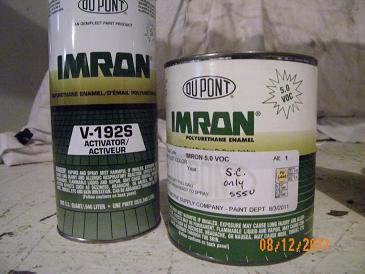

Thanks Larry, I do have the proper equipment, Teflon suit, masks with the proper cartridges, head cover etc. I'm going to experiment paint on my trailer and leave the topdeck for last. My mistake the primer I used on the lower hull is a urethane that I got from the paint tech at the auto shop. A gallon of that for both the top and bottom. It does a great job of filling those spider cracks. I got a qt of Imron snow white for the bottom but need to go a little less costly on top. Cash is running low for this build.

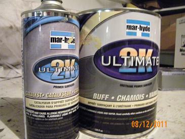

OK. Here's what I got for primer and bottom paint. The primer works teriffic for what I need.
