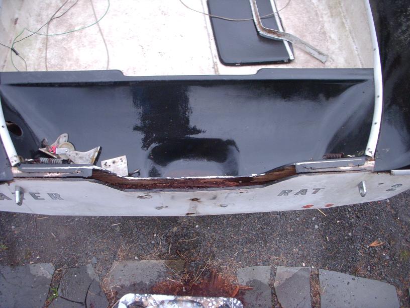

My father and I have begun work on the 1963 funliner, It is rough. I am wondering if anyone else has pics of repairing a funliner's transom.
Mine has been cut down I intend to build it back up. My main question is how to separate the splash-well and the inner transom. they are two pices at the top and the bottom but seem very fused. Well here are some pictures any input would be great, and pictures of other Aristocraft transom structure would be great.
Thanks

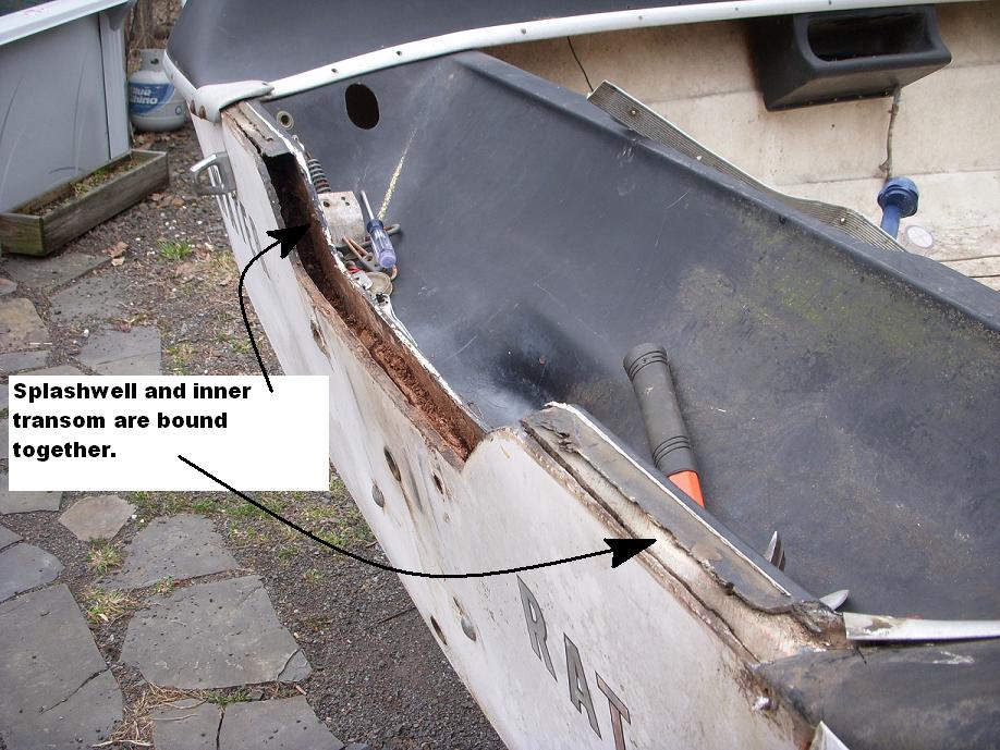

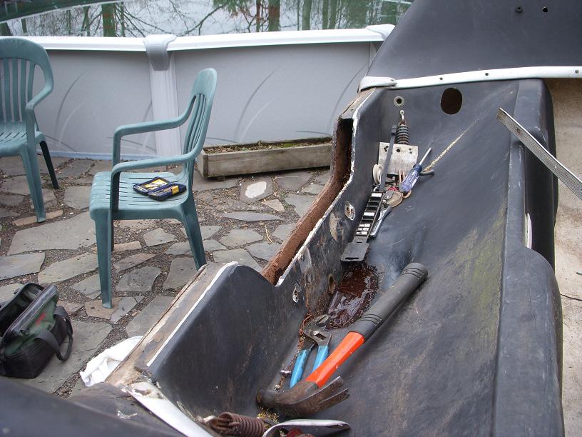

The splash well on our '63, which included molded in rear seats, was screwed in all along the transom and around to the rear fin area. It was also tabbed to the deck with a couple pieces of matt under the seat area, which required sliding a sawzall blade in sideways and carefully cutting the glass. Finally the drain tube had to be removed, then the whole assembly slid out. Our transom was fine, we had to remove the splashwell to access a steering cable guide pulley that had come off, way up inside.
Re:Aristocraft funliner Transom? 15 years 4 months ago #30359

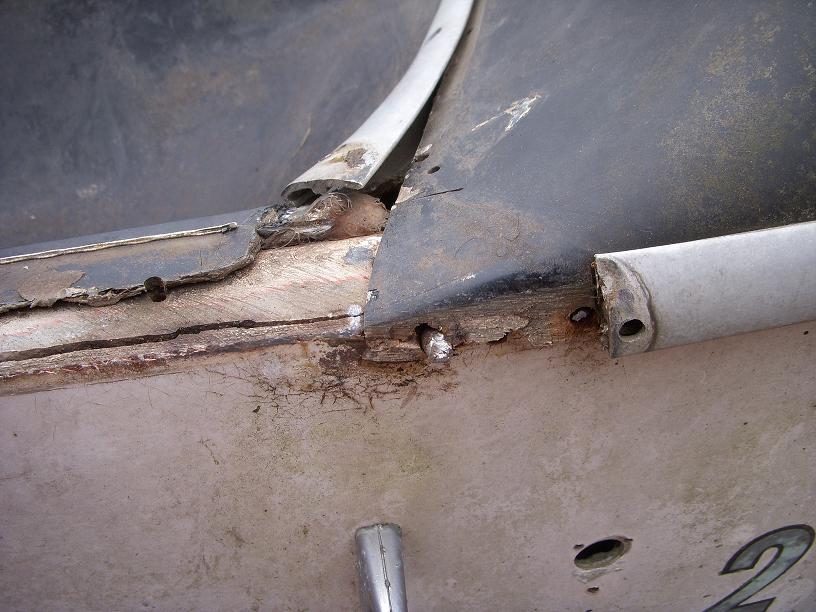

Thank you for the pic and information! Some one had "repaired" Mine at some point and bound the splashwell and transom so we will see how it comes out! most of the wood core just floated out of the transom when we were washing it...

Has anyone done a transom on an aristo? I want to do it and have it come out not looking butchered I would like to not have to cut the inner pannel all up but looks like it will have to be to get it right I dont think I can get the inner surface good enough for a clean bond just going in from the top..
Any ideas here?

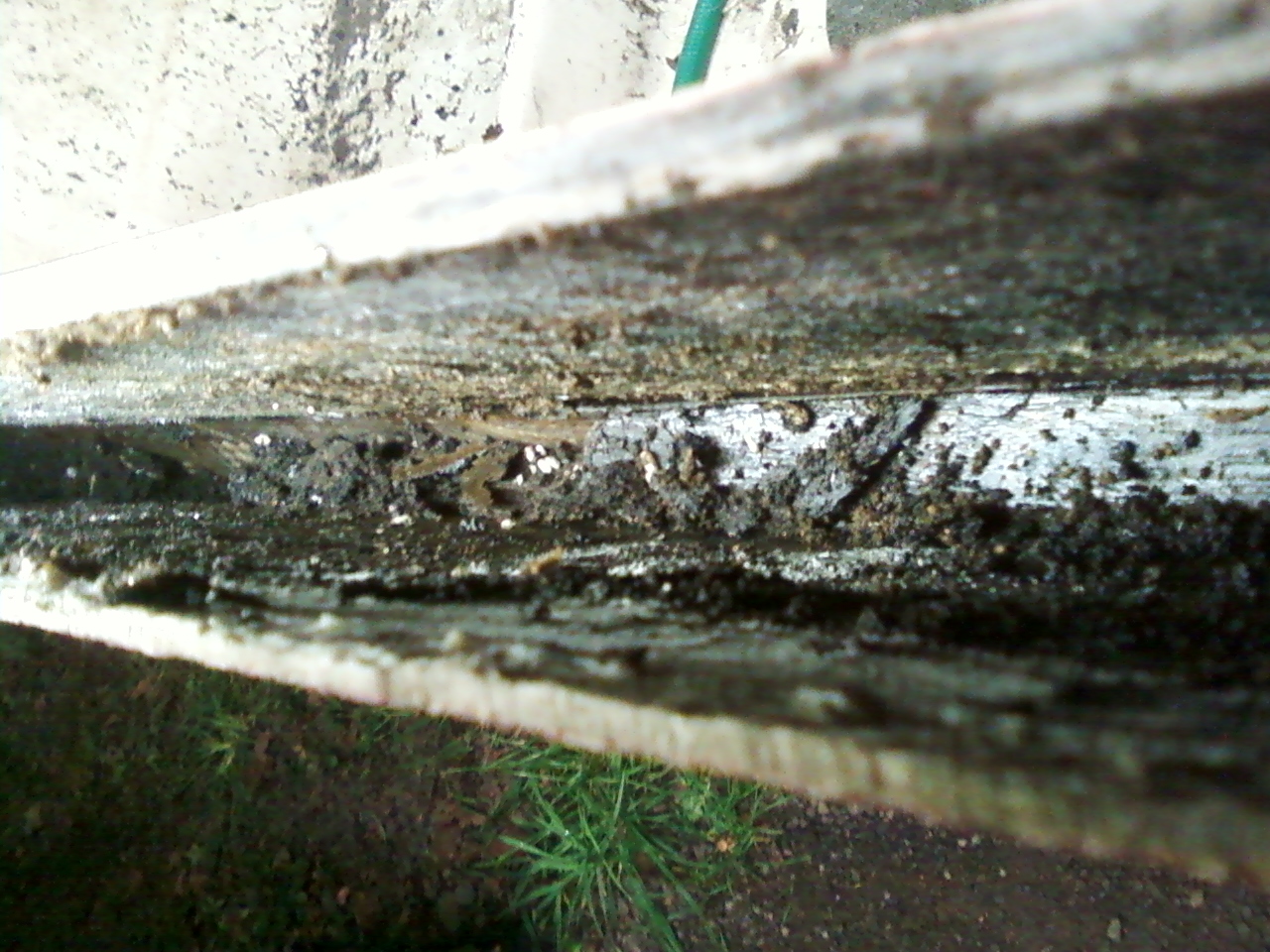

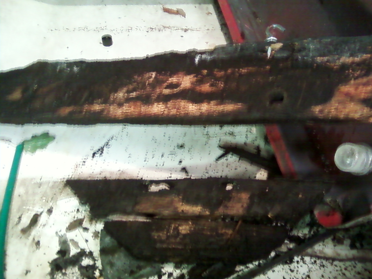

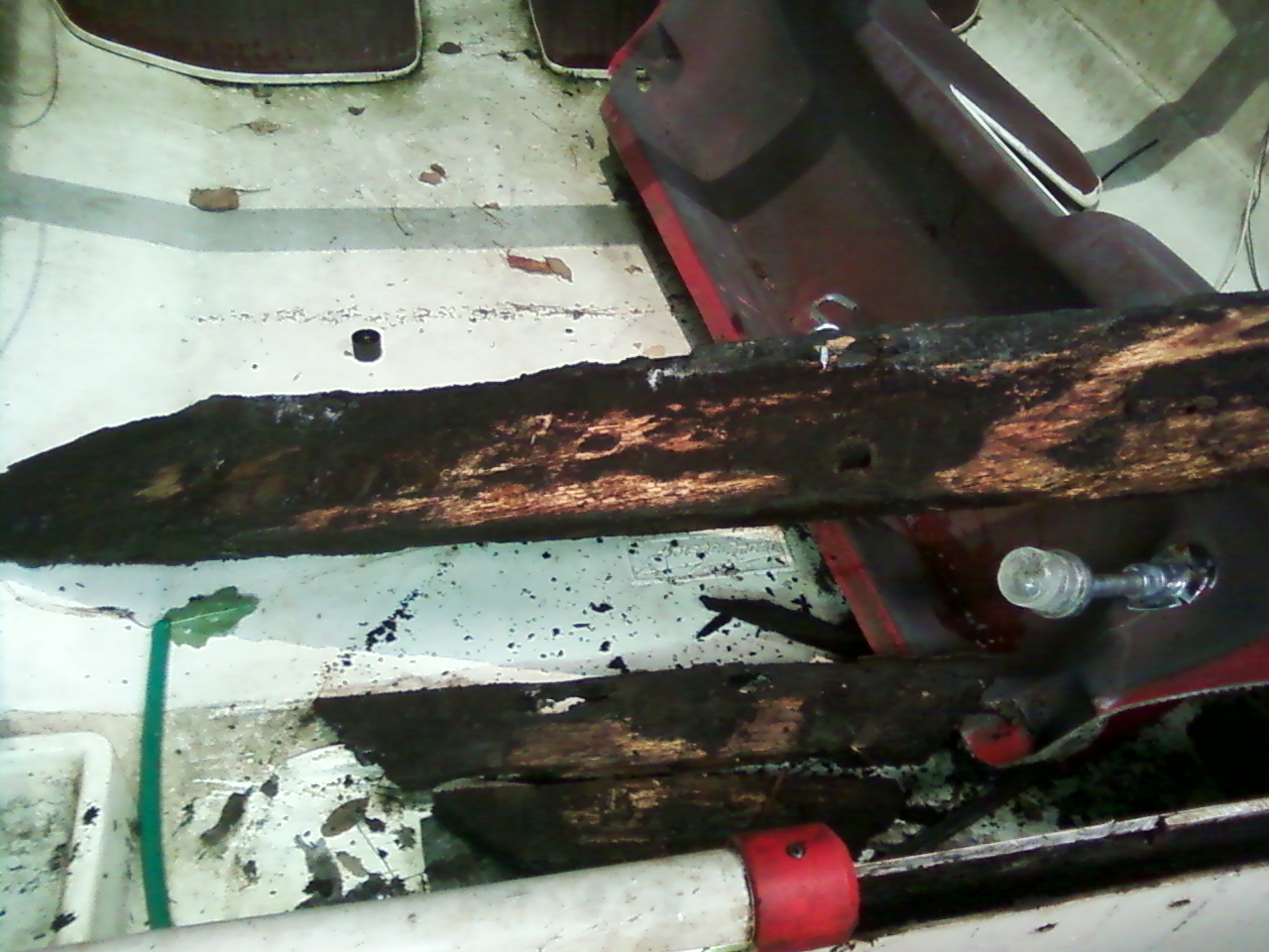

OK the old Transom is out! It was very easy just like another thread said screw an eye hook in and pull out the old transom. It is made out of a 2 x 6 and a 2 X 10 it seems hard wood of some sort but solid boards not ply, both parts pulled right out and were the homes of a bunch of carpenter ants. I am going to replace with a built up plywood transom this weekend and throw the old girl back together give it a good cleaning and see what will Buff Out! well heres some pics. Lots more cleaning and sanding to do in there!

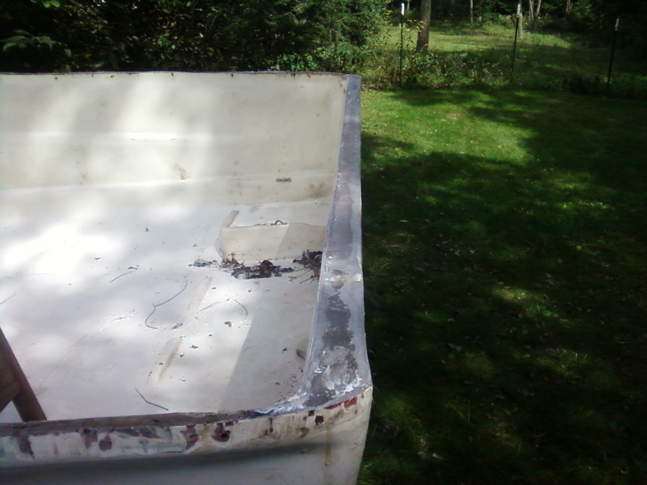

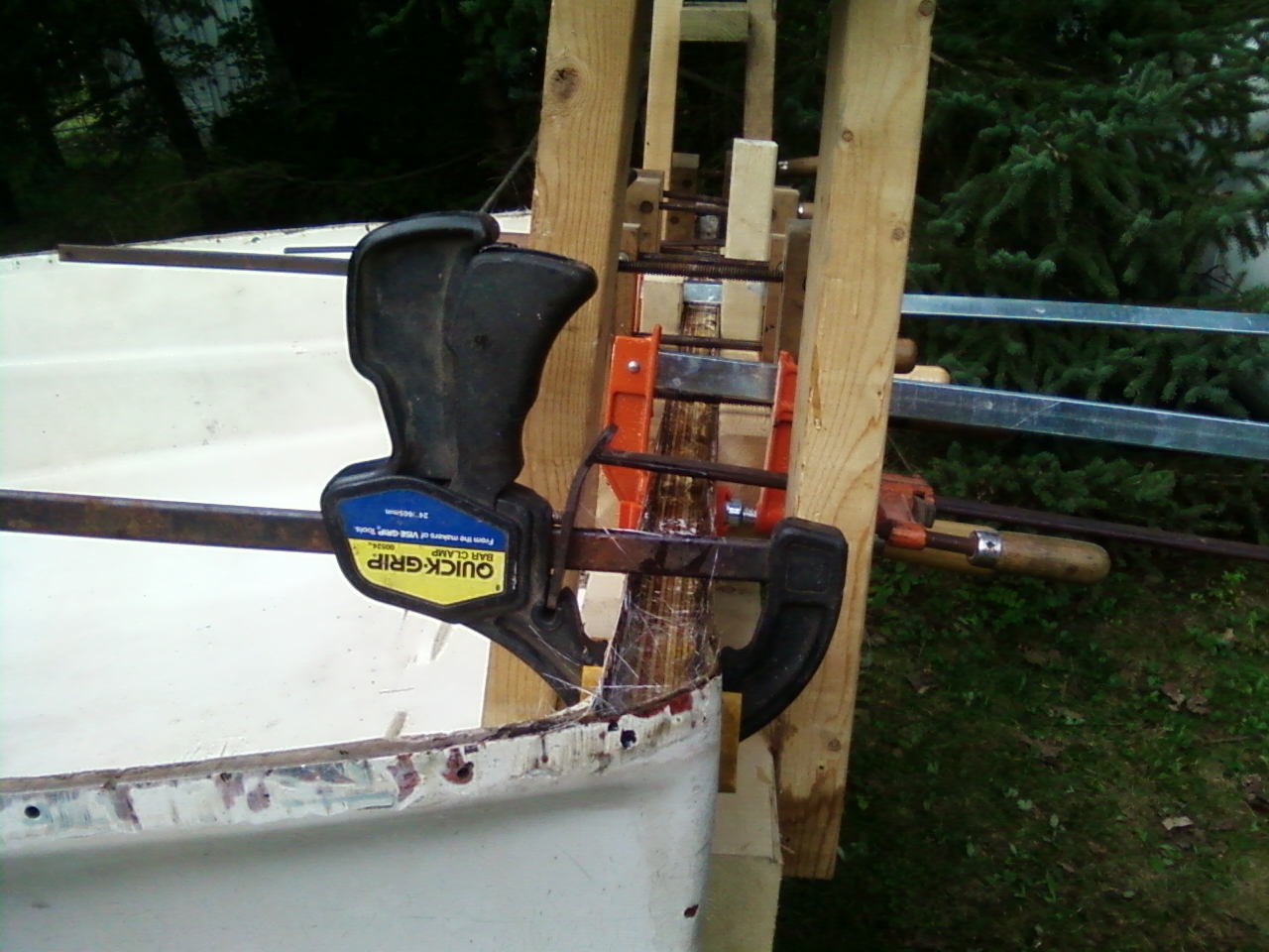

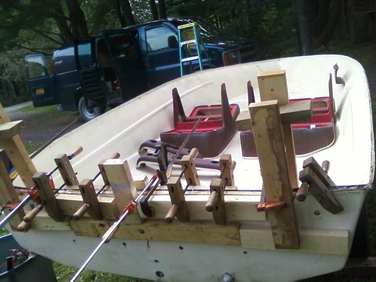

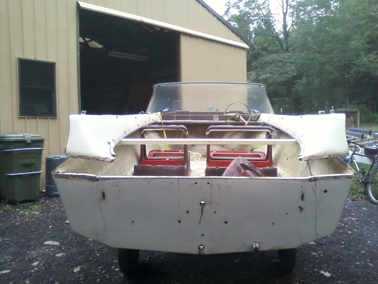

Well I cleaned the boat all cleaned up and sanded down in the void where the transom goes, cut a new one and got it in. Heres a couple pics.

Great job ;)
Re:Aristocraft funliner Transom? 14 years 11 months ago #43925
Lookin' good Jesse. The boat cleaned up pretty nice, and got the transom in too! Nice weekend's worth of work my man. ;)

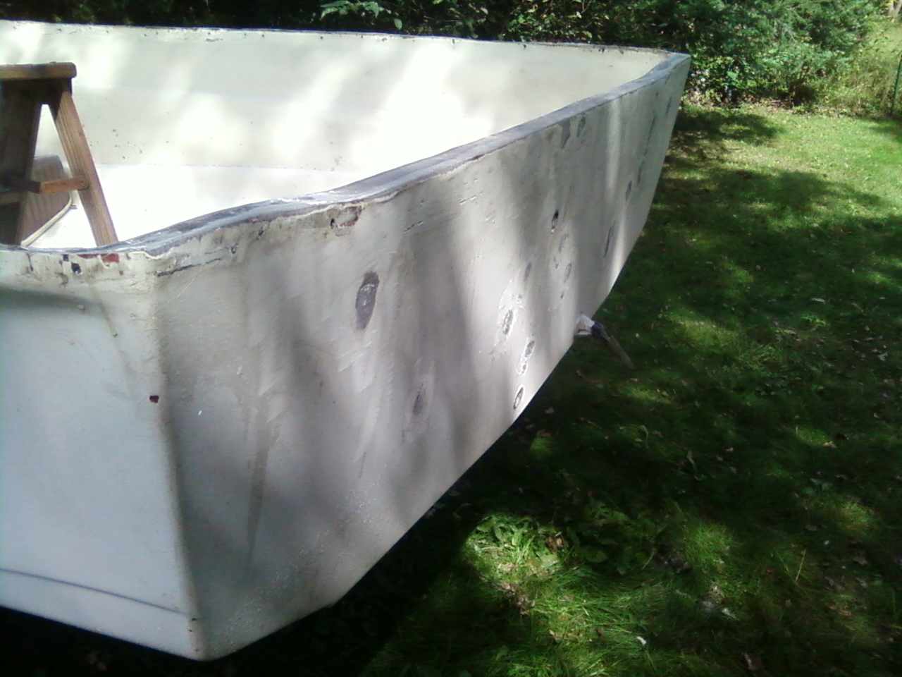

Thanks guys! Slowly building the cap back up on it and glassing in all the old bolt holes Hope to get it wet before the end of the season! wont be great looking but I will get it as cleaned up as I can without a repaint!
Transome is good and solid now thats for sure!

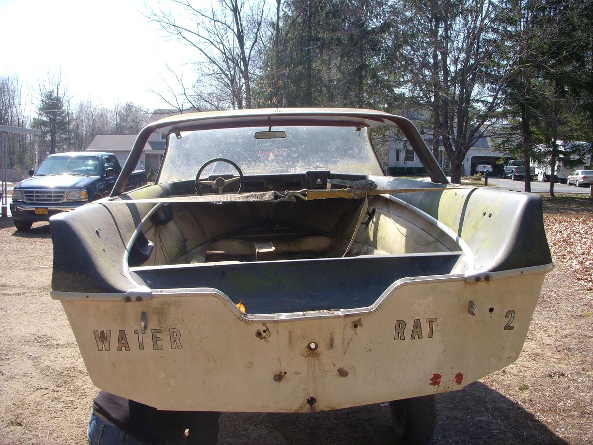

Been bussy after work all week I hope to have her back together this weekend and figure out what trailer to put it on..... I dont seem to have any to fit a funliner any one have a need for a short Tee Nee in trade for a trailer that can handle a funliner?
fiberglassics.com/index.php?option=com_kunena&Itemid=62&func=view&catid=13&id=40462
IT had a 14 foot wagemaker on it, and has a home made registration..

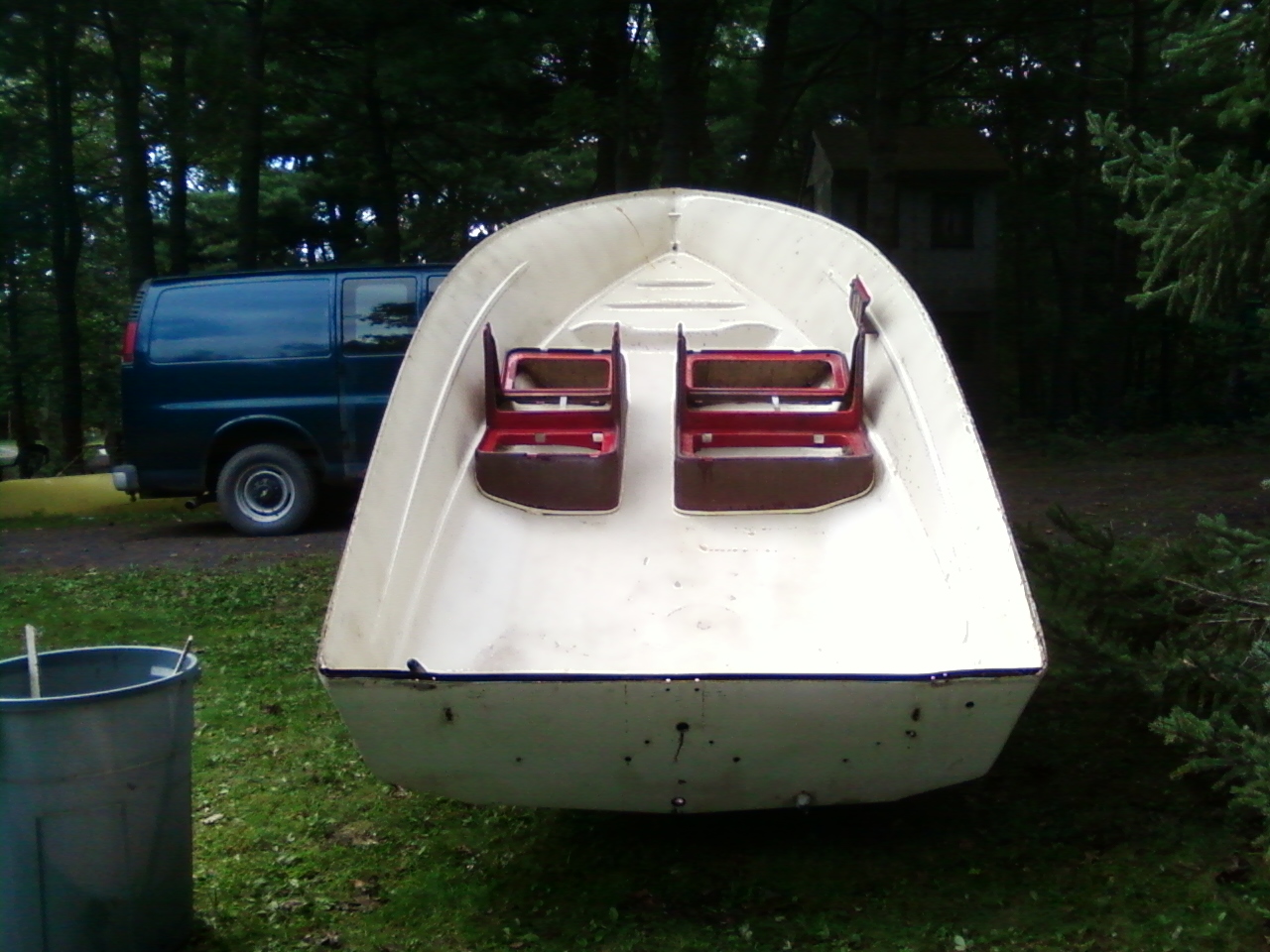

Well Just a little more progress... Weathers been less than nice this week. And it seems we have pased from Summer to Fall this week :-( But here is some more progress I have caped the transom and amin the process of filling all the old bolt holes then using some resin gelly to build up sand and paint the area I am working in. I dont have time ... or weather to repaint the whole hull... Maybe in the future I just want it to be usable at this point.

This is what I love about FG. A guy is doing a project and asks a question about doing it. At least three other members offer advice on techniques, materials, who else to contact, etc. And no one is looking to get paid for their hard earned advice, either. Its a great credit to the people who just love old boats and helping others do the same. My hats off to you all!!!
