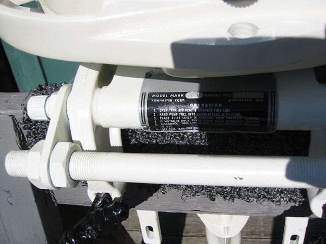

1960 Merc 45 hp....... that may very well have a smaller dia tilt tube , than your steering cable, if so you will need to make a ride guide cable adaptor to accept the newer larger cable
first see if the cable sildes thru the tilt tube of the motor
I can take a pic of a Ride Guide stock adapter for you tomorrow
Re:Steering Linkage 15 years 3 months ago #30151
  • barry5of9
  • barry5of9's Avatar Topic Author
  • Posts: 50
  • Karma: 2
Sounds good, any pics can only be helpful. Thanks, Barry
Re:Steering Linkage 15 years 3 months ago #30152
you need to buy the used later model larger tube with nuts!(7/8 I think) , many on ebay.... make two brackets with holes for the 2 tilt tubes to mount as shown in the pics
now you route your steering cable thru the "new larger tube" that will allow you to properly thread on next connect the drag link from the motor to the end of the steering cable
