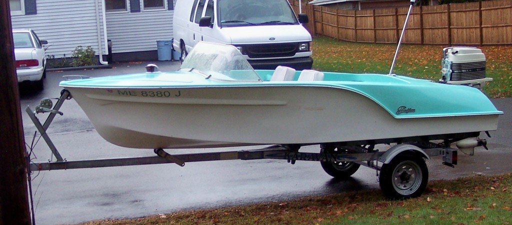

Re:1959 Fleetform Commodore 15 years 4 months ago #30048
Thanks for the info. Is that a Fleetform in the pic? What year? I'm starting to think mine is a 1957 or 58. I think maybe the 1959's had fins.

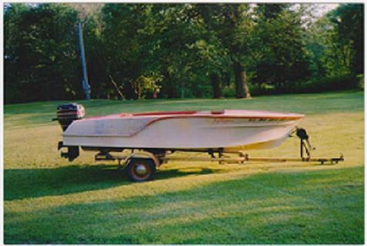

Re:1959 Fleetform Commodore 15 years 4 months ago #30076
Mine is a 1960 Su-Preme Spitfire. A knockoff of Fleetform made in Minneapolis.

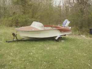

kaptain, i have a 1961 fleeteorm, looks just like yours. iam going to redo it to black on white. this boat was in a garage that a car burned up in and the gel coat on the deck got heat damaged, so iam removing all the gel coat. see my earler post titled i think i got it, there is a picture of my boat. i have the original interior (seats) and the 2 floor pans, kind of like a sub floor. they set in front of both seats. i do'nt think iam going to run a windshield on mine. and have the seat color changed to black and white as were the original. keep the pictures of your progress coming, as we all like looking at pic's . frog

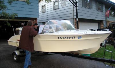

here is one I did for someone years ago
