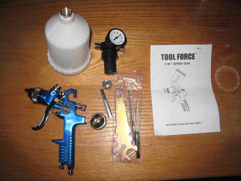

Couple of questions. I've done a few projects, and have difficulty adjusting the gun to spray smooth. Surface mottling, commonly called orange peel, seems a problem, no matter how I adjust. I spend more time on the practice wall than I do on the project.
Specifically, I have an Eastwood DeVilBiss HVLP gravity feed starter kit, with 3 nozzles. [the chinese one, not the top of the line, this is supposed to be ideal for occasional use] Using a 2 part, single stage urethane, no matter what pressure at the gun, amount of paint flow, no matter how thin or thick I mix the paint, I can not acheive the glassy surface I want. I know some types of finishes are meant to be rubbed out, but these paints are not supposed to need that.
Any advice for me?

I'm guessing air pressure. I shot quite a bit of single stage urathane. Be sure that you have your parts correct. Single stage tends to have some orange peel in it, but I know that some painters can make it lay flat. Keep in mind not to beat yourself up about the finish. Look at new car finishes, some, if not most do have some orange peel to them. Base/clear types of paints should be wetsanded. My experience with single stage urathane is that it usually does not retain a shine once sanded. I have had my Devilbiss forever and put mine to a buddy's cheap autostore gun. The finish was the same. He's just a better painter.

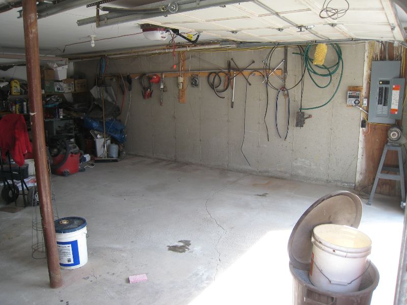

Well Heather, I made it today. Got most of the garage cleaned out for my future temporary spray booth. Got more to go, but my kid was a big help once I got everything done on the hot rod. The garage is about 26 X 26, and once I clean back to the shelves in the very back there, I'll have all the space from the red pole you see one of to the wall.

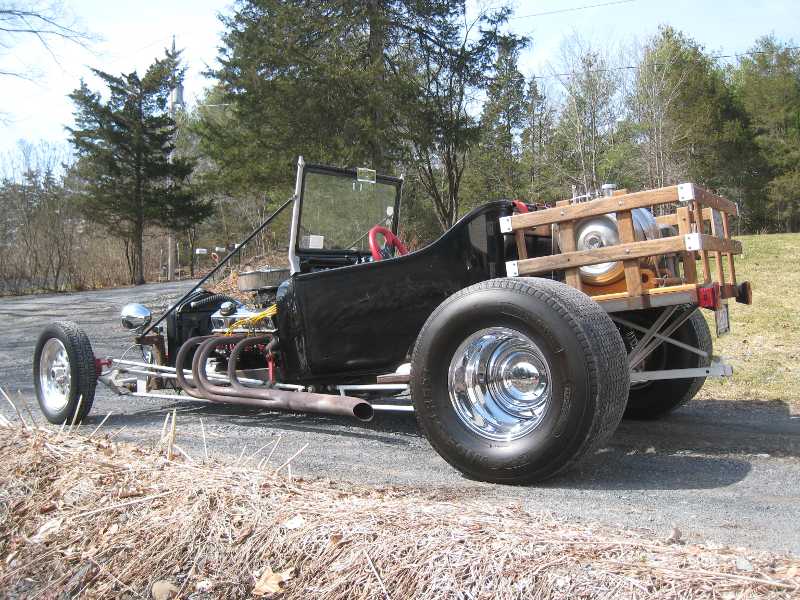

By the way, this is the hot rod I built between 98 and 01 that has yet to see paint. Less to paint, but way more complicated! Maybe next year.

Nice Rod!!!!!! sweet. Would love to cruz that thing around here. you would get all kinds of looks. As for the spray booth Look good as far as size and room to move around but move any thing and every thing you dont want over spray on, move it. It will get it on it.....

Anything I don't move in the garage will get covered. My drill press, table saw and some other large tools will crowd into my basement shop. We moved a lot of crap today. I figure I'll seal the electric boxes real well, and then tarp the shelves. Soon I will start getting an idea of how I'm going to do the plastic wall. If I have airflow going through there, it needs to be anchored on the floor too right?

Got the rest of that garage space cleaned out today Heather. Ran to Lowes early to get bolts to attach the trim to my motor first thing and couldn't get all of what I needed, so I came home and moved stuff. I like it!

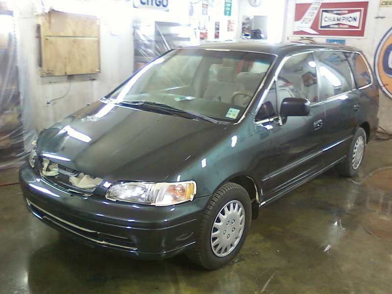

Frank, be sure to practice, practice, practice before spraying paint. If you've never painted before and are starting out with a gravity feed gun it may be a little trickier than than starting out with a siphon feed. They spray a little different. Then again, if you've never used a siphon feed that may be to your advantage since you are not used to spraying a certain way.
I'll be painting my father in law's Honda Oddessy this weekend. When I walked away from the body shop business in '93 I swore I'd never paint a car again. It was 5 years before I even went in the shop, and that was to rebuild a boat. So, after 17 years I'm finally painting my first vehicle.. and it's a damn mini van! :angry: lol

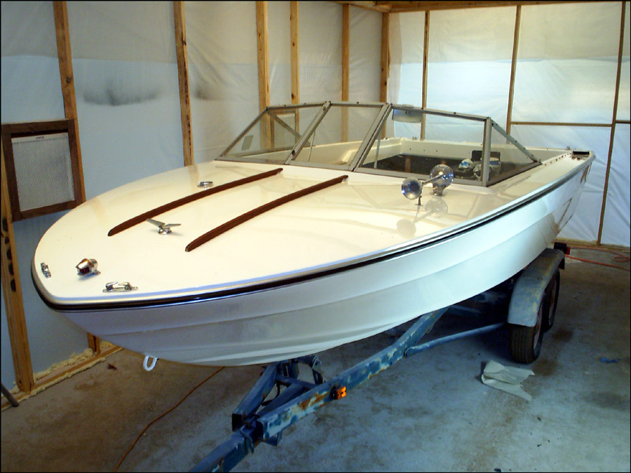

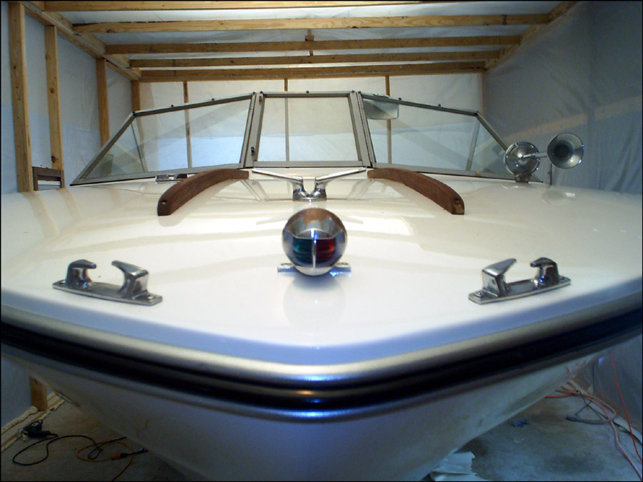

Hey Frank. I got your E-mail. No I am not dead. LOL Just Bizzy as a bee. this thing has got to be done by 31'st... No much more to go now. :P
Mrs Spookeay Bird
Re:Painting 101 For Frank. Or any one. 16 years 4 weeks ago #3296
Good for you Heather. Boy that boat is looking sparkly great!

Go back to your data sheet and make sure you are mixing your paint right. USE THE MIXING CUP! do it exactly! I also use a scale and measure everything by weight and compare it to volume.
Second get a quality proven gun. No Chinese junk you will get what you pay for in this business. "TRUST ME! in 30 years of painting I re-invented the wheel too many times."
I like the Sata-Jet90 because it's been in use for years and is a bulletproof gun. Go to most any body shop and you will find all the big name brands but you will always find that old tried and true German standby, The Sata-Jet-90 right there on the shelf in a pinch. I also am a big fan of Sharpe Guns but they don't last long 5 to 7 jobs and I star to see problems, they start having air flow and tip issues.. but at $100 to $150 A pop, you make your money off them. I have done Airbrush work with a Sharpe. Good Luck.

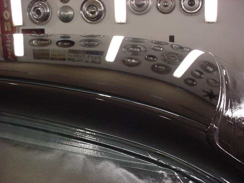

Well, the mini van is painted. On a Monday, AND a full moon! It came out nice, just needs a little 2000 grit here and there to take care of a little dust and then polish her up. :)

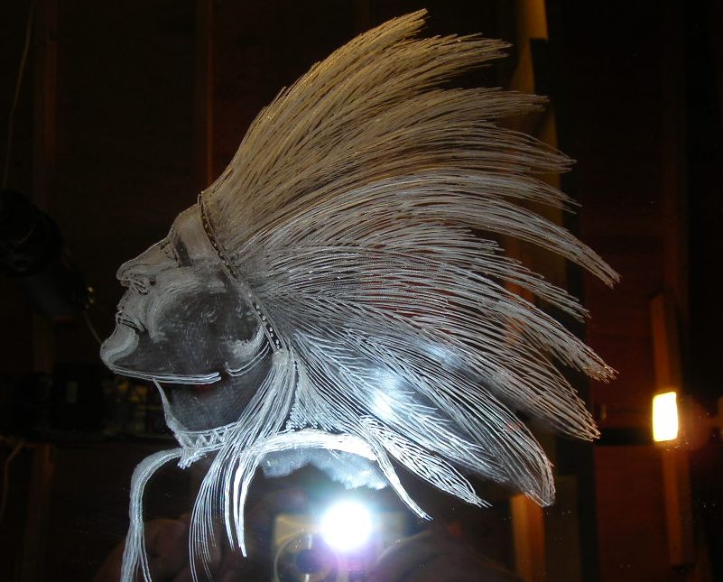

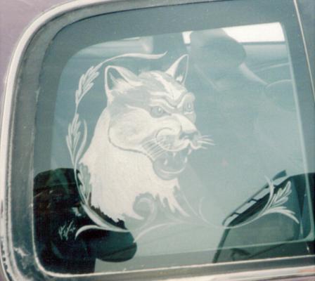

hi heather,great thread!i see you have used sharp airbrushes,i have done a few cars and alot of motorcycles with airbrushes ,i wish i had taken better pics with a good camera,but alas it was along time ago,and the pics of my airbrush work and art work didnt come out good.
i used to use paasche airbrushes when i started ,it was all i could afford,but it did the job ,but then i got together about 100.00 bucks back then and bought a badger crescendo 174,duel action siphon feed ,wow what a difference,i have had it over ten years and used it heavy,i still have it and am getting back into my artwork,custom painting,oil painting ,mirror and glass engraving,and hand carved furniture.
i just wanted to mention the badger because its a good brush and still about 100.00 bucks,plus its usa made.i dont have a pic of my airbrush work ,but here is a pic of one of the cars that i hand engraved the rear side glass in,it was mercury couger,john also a pic of just a small part of a mirror im working on
Re:Painting 101 For Frank. Or any one. 16 years 3 weeks ago #3527
sorry heather and frank i just reread what i posted and it looks like i tried to hijack your thread,what i want to say is you do fantastic work heather,and this is very helpful to all of us,im very impressed by your work and work ethics,ive been following your posts ever since you posted about the houseboat,by the way how is that going?
and frank im also impressed by the way you tackled this project,you have inspired me to get back to working on and painting the sunray,thanks to you both,john

john, the cougar head is pristine.(i don't use that word very often) ron

Having the ability to build a paint booth at home is really neat. But what bothers me about the picture of his future booth is that the electrical panel box is in there as well. Better cover up that puppy real well too.
Re:Painting 101 For Frank. Or any one. 16 years 3 weeks ago #3541
Yep, already got that covered! Thanks for pointing it out though, could safety point.
