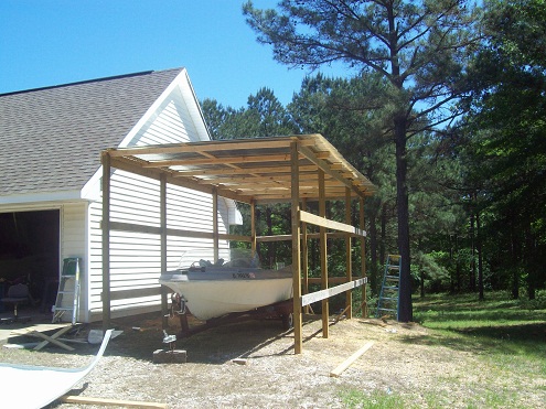

Roof is on!! Have to wrap top half with OSB and see how it looks after that, Have it in the trunk but have to take a break.

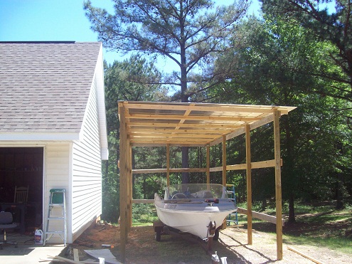

I dont see much pitch to that roof... I would highly recommend taking it apart (at the roof) and adding some pitch or you will have some serious issues if you get heavy snow and even rain could cause issues. All you really need to do is chop down 1 side by 1' or so.

Not going to get any snow and it has a little more pitch than it appears in pics I think it will be ok but thx for the interest. Joe

YES.. everyone is a critic... but snow or no snow aside... I would highly recommend some diagonal bracing between the verticle posts... does not have to be anything complicated or heavy. Without this, the whole thing has the potential to fold over like a house of cards. Just some friendly advice.

That is why I'm going to wrap it with osb 4x8 sheets and it should firm it up.

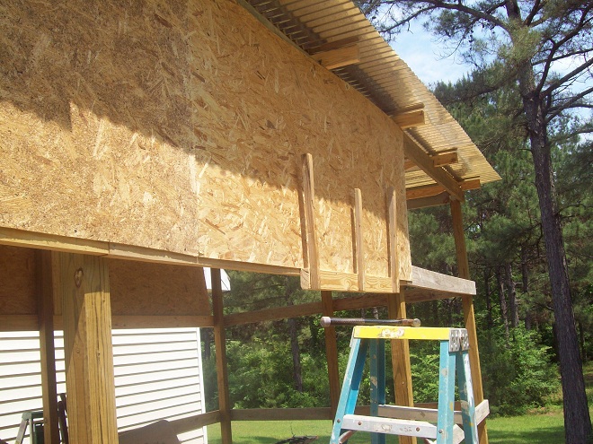

After manhandling 3 sheets figured out I should build a jig to hold them up. !st 3 about killed me...
