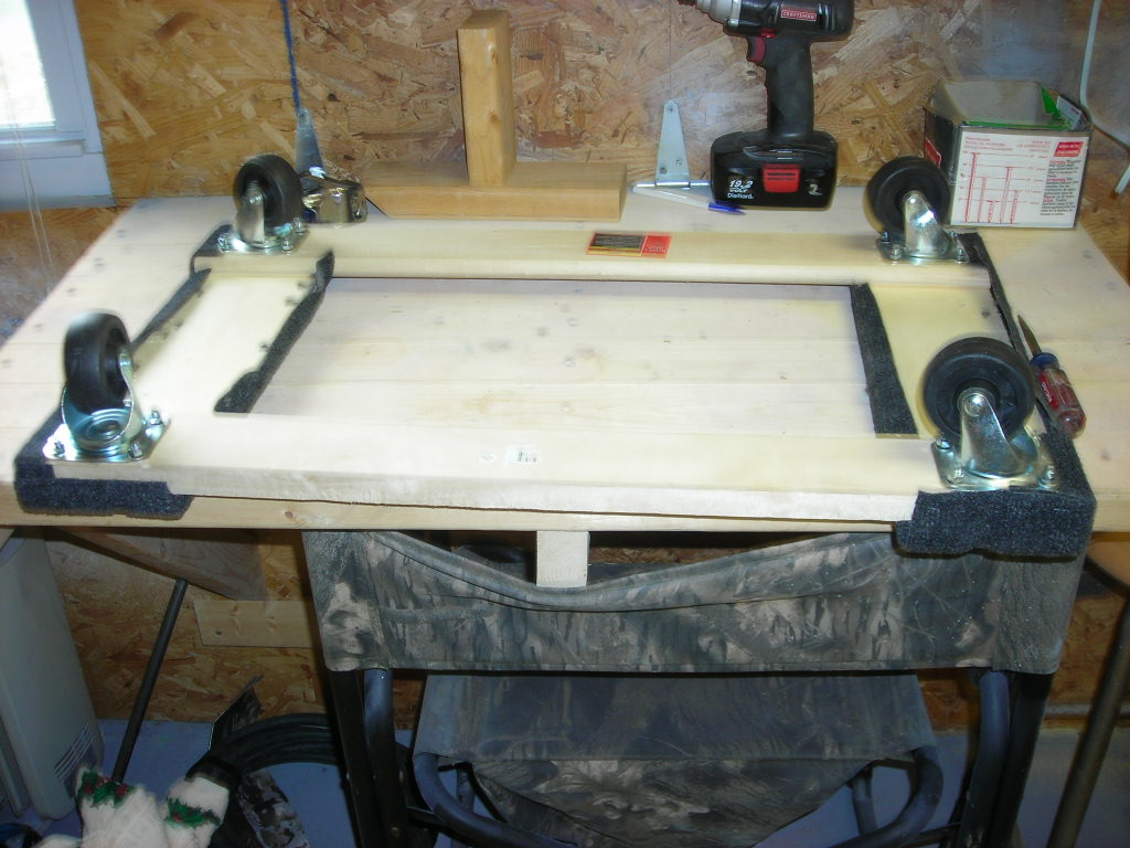

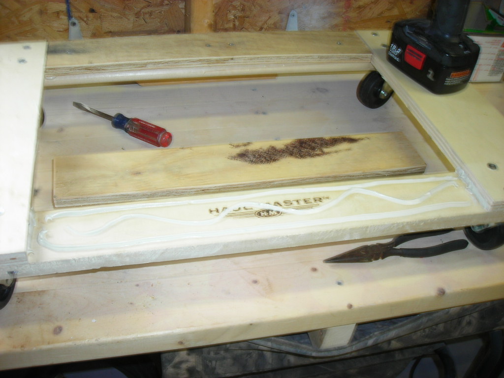

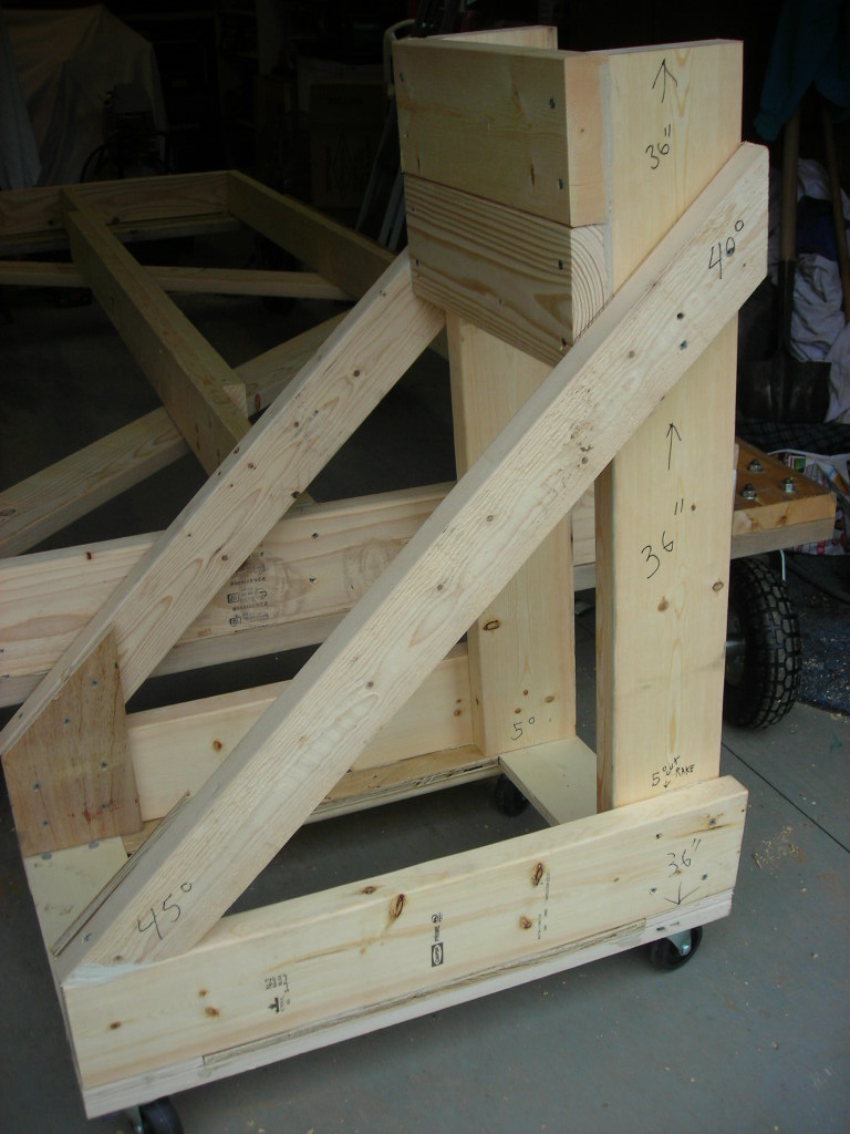

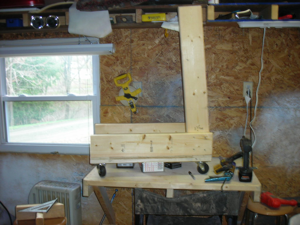

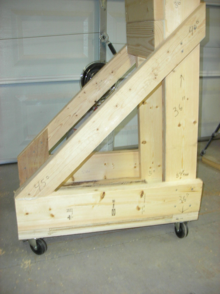

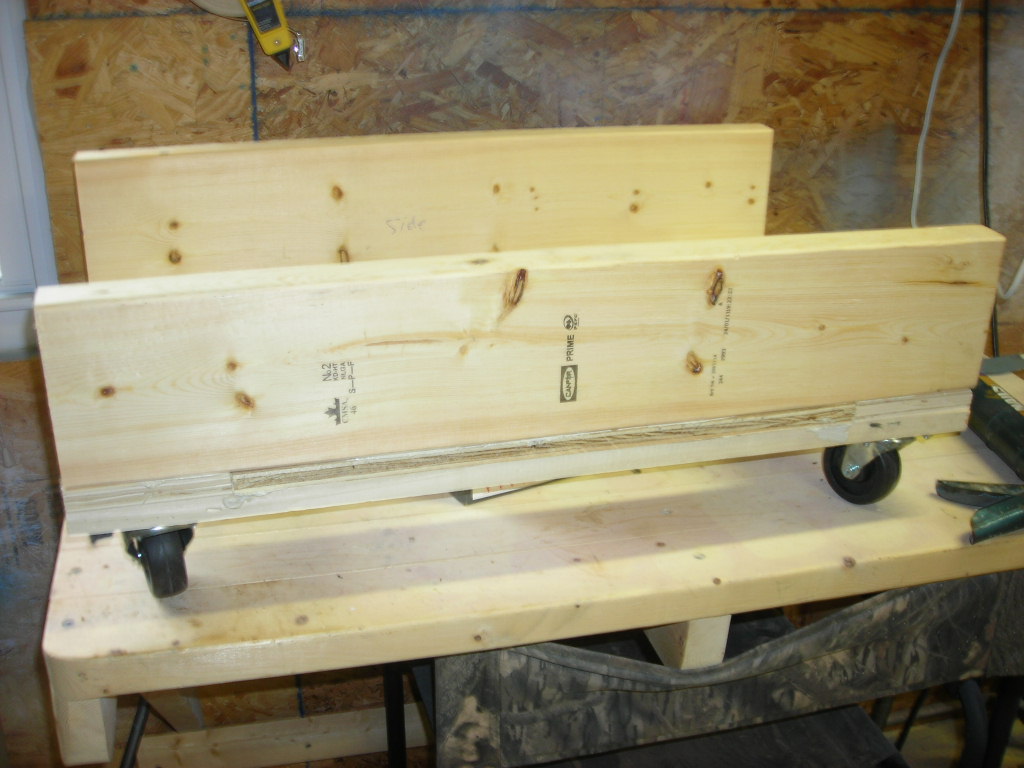

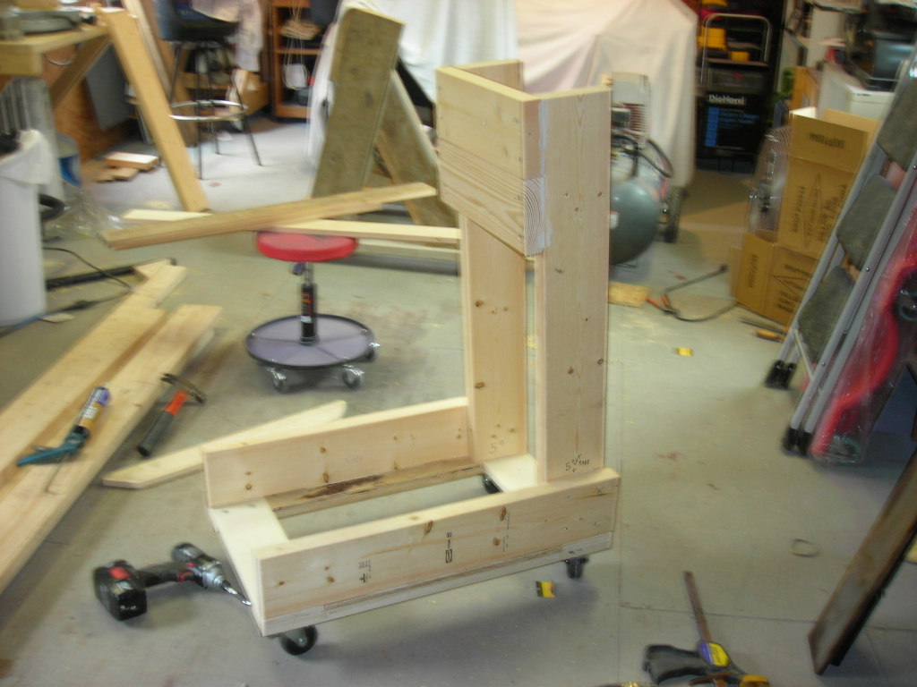

buy a funiture dolly and take the carpet off so the glue(heavy duty liquid nails)can stick to the wood,every conection on this stand is glued and screwed together.there are 7 pics total. add 3/4 plywood to fill the side gaps and add streangth,glue and screws,(all screws are deck screws). add 2x6 sides,glued then screwed(3 1/2 inches)from the bottom up. cut one end of a 2x6 at a 5 degree angle,then cut long side to long side at 36 inches,then set it upright,and glue and screw it to the sides with 3 inch screws,this will handle a longshaft.let it lean back. do the same to the other side then add 2-2x6's or 1- 2x12,to hold and clamp the motor. now add side supports,i used 2x4's,the bottom cut is 45 degrees the top cut is 40 degrees. now add plywood to the bottom supports

The only thing I do differently John is I use two pieces of 3/4" plywood for the transom mount. (It can also be three pieces of 1/2" plywood.) Pine can split if for any reason you're leaning or putting pressure on the motor, i.e. trying to tilt an old frozen motor, plywood will not.

good call frank,if a person wants to they could put 1/4 "plywood on each side of the 2x"S,that would give it 2 inches thick,i may just do that,john
