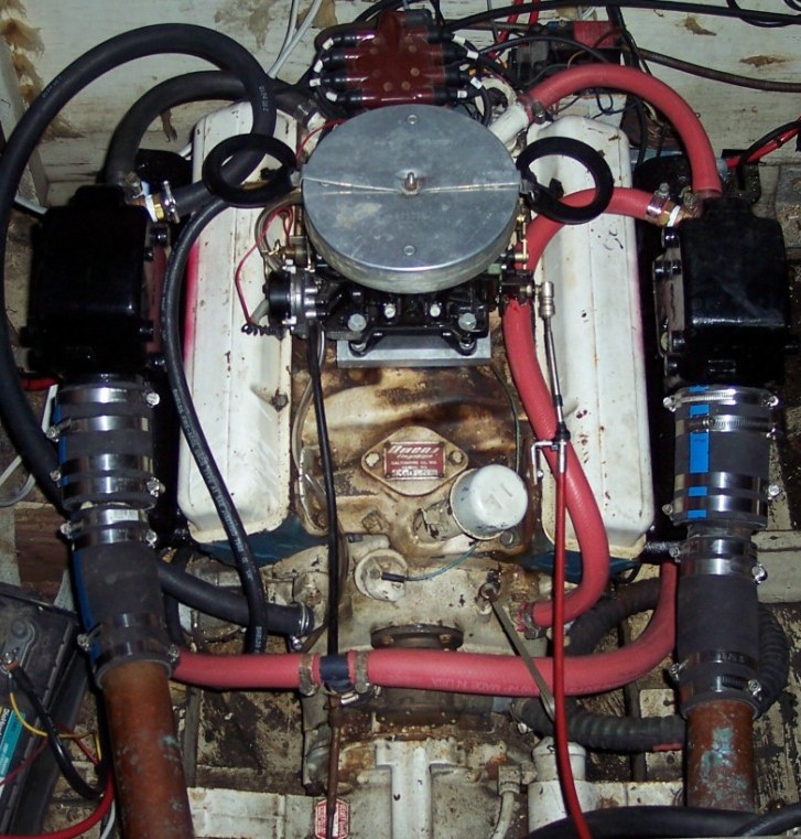

Please help save what hair I have left. lol. Need to know the difference between marine buick 350 and standard buick 350. Have cracked block in my 1966 Evirude which is told has a buick 350. bought a buick 350 from a jeep pickup for the block. I know the heads are different but not sure what else needs changed. When turning engines over they both turn clockwise and the dist. also turns clockwise. How can I tell if they are the same rotation. Please help :)

Thanks for the info but I ran into a problem. Come to find out that the friend that I got the boat from thought the engine was a 350 buick but its actually a 300 buick. I've been on the net all day long trying to find water exhaust manifolds for the 350 but no luck. Thank you again for your time.

I don't think the Buick 350 was used in production marine applications so marine exhaust manifolds would have to be fabricated. Could be wrong. 225 Buick V6 was pretty common and was pretty much a 300 with 2 cylinders removed. OMC did use the 225 V6 but surprised to hear of a 300 V8 in one. Cylinder heads were very different between 300 and 350. 300 had evenly spaced exhaust ports similar to small block Ford and 350 had a paired center set similar to small block Chevy...not the same design, just similar spacing style.
