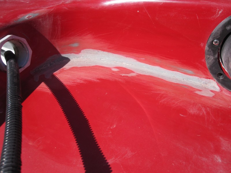

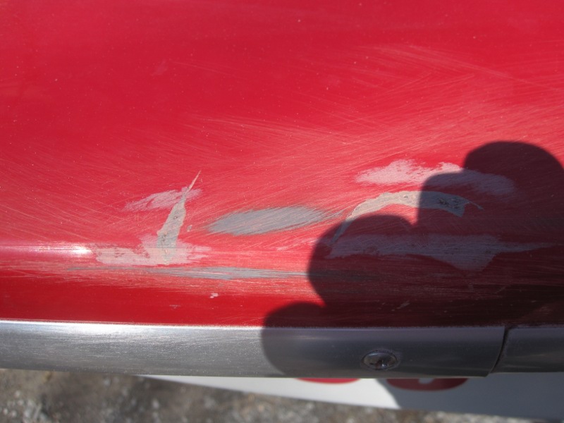

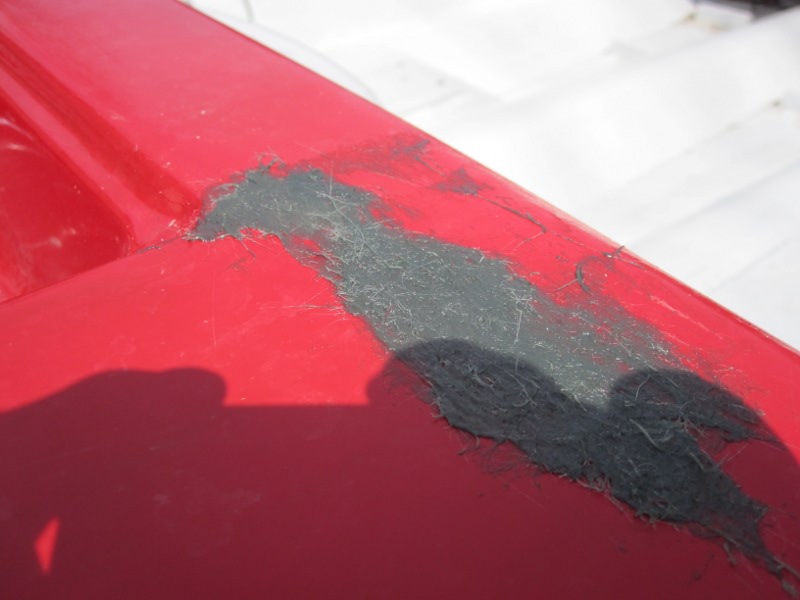

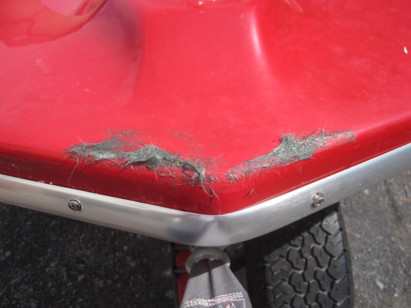

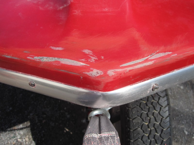

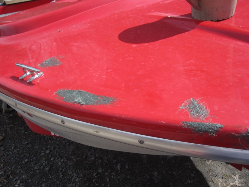

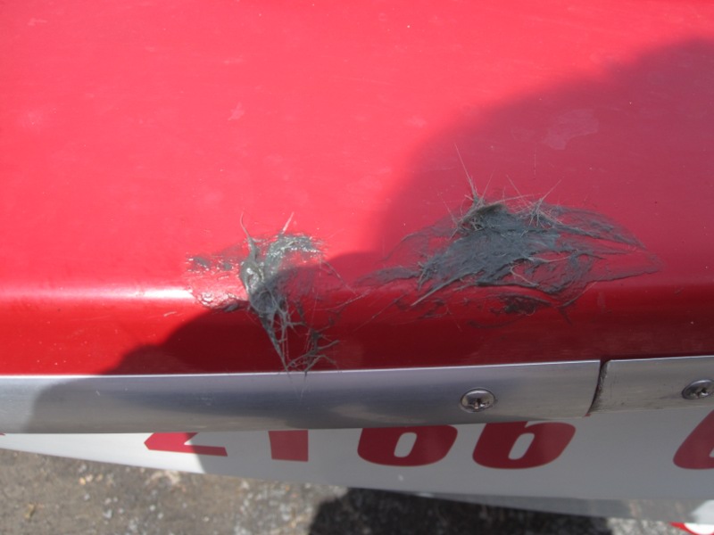

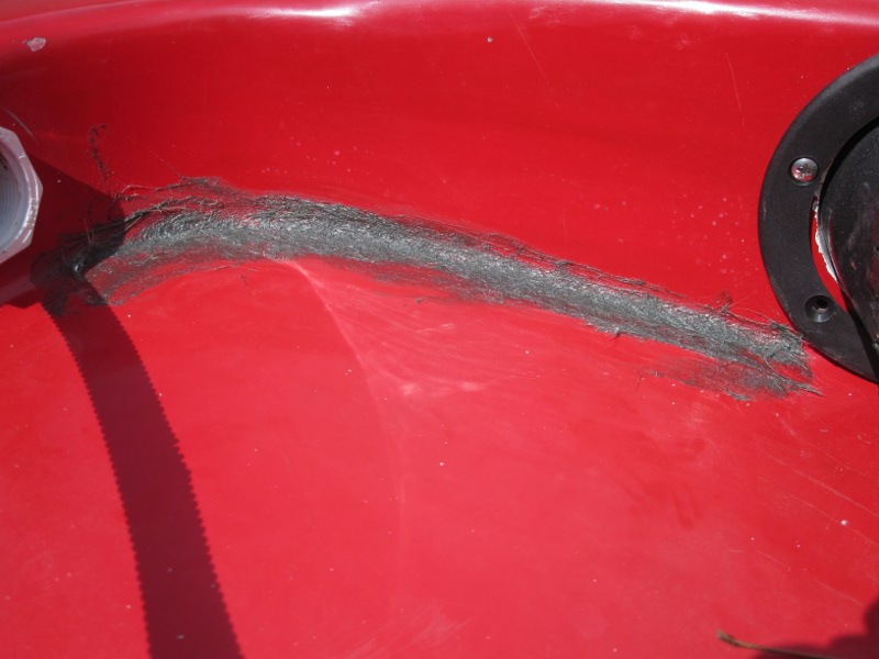

Had a few cracks and scrapes on the deck of the Power Cat needed to get fixed. Cleaned them out, "z"ed them all real good, then filled with kitty hair. I wanted to use kitty hair because some of the cracks I wanted better adhesion than body fill would have given me. for the scrapes and nicks, well, I had lots of kitty hair mixed. In this bright sunny 62 degree day it set up quick too!
It is NOT gonna be easy to sand and fair, but the season is early yet. I gotta run out, maybe work at it later, finish tomorrow?
If thats a concern maybe consider sanding back that fresh red paint then do the repairs
Re:Kitty hair strikes again!!! 15 years 3 months ago #29361

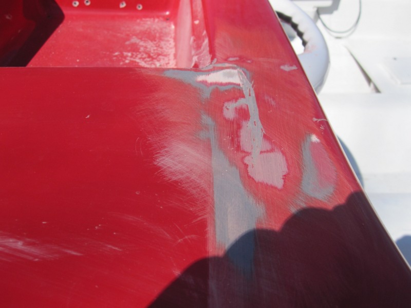

I did. That's what I meant when I said I "z"ed them all out. (I should have said "v"ed them out huh?) You can't see it because the kitty hair overlapped. Came out okay, but there are always voids with kitty hair. Now that they're sanded and faired, next is regular fill, but it will be tomorrow, because my shoulders are shot for the day. I could never do another boat restoration!

Frank before you try any fillers put on another coat of cat hair 1st. If you need to gouge out any visible void to accept the cat hair. It will fill the voids, ad strength and allow you to use less filler if any will be needed at all.
Just a thought
Jim
Re:Kitty hair strikes again!!! 15 years 3 months ago #29364
That's a good suggestion Jim. I'll try it. thanks!

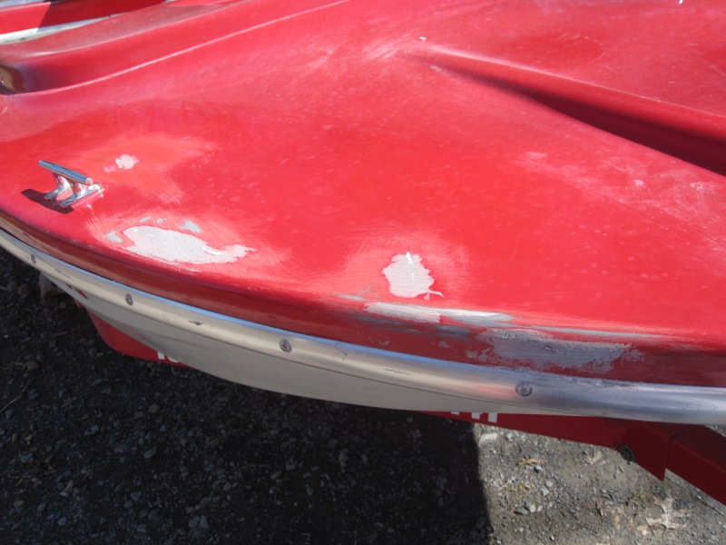

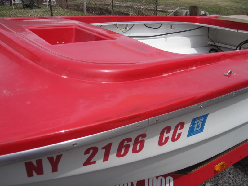

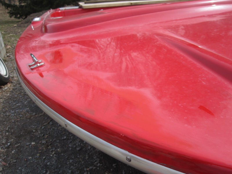

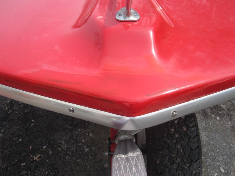

Came out good! 15 years 3 months ago #29431

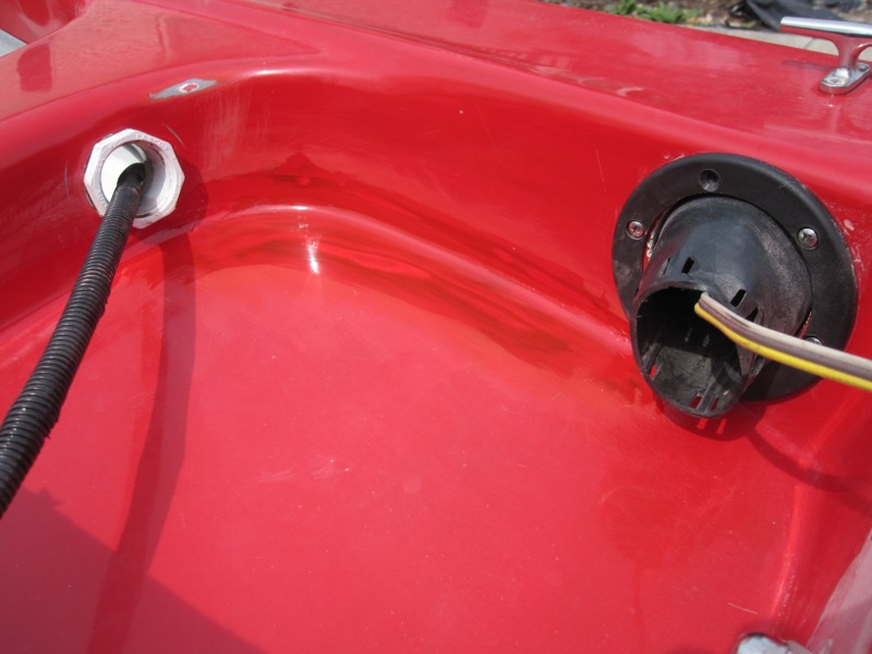

Primer from last year was shot, but I wasn't surprised. Pre-kote goes bad real quick in my experience. So I brushed on some Brightsides just to protect it till I can remove hardware and wet sand the deck. That might happen today, not sure.
Man o man, this body work stuff always takes like 5 times more time than I think it should!
