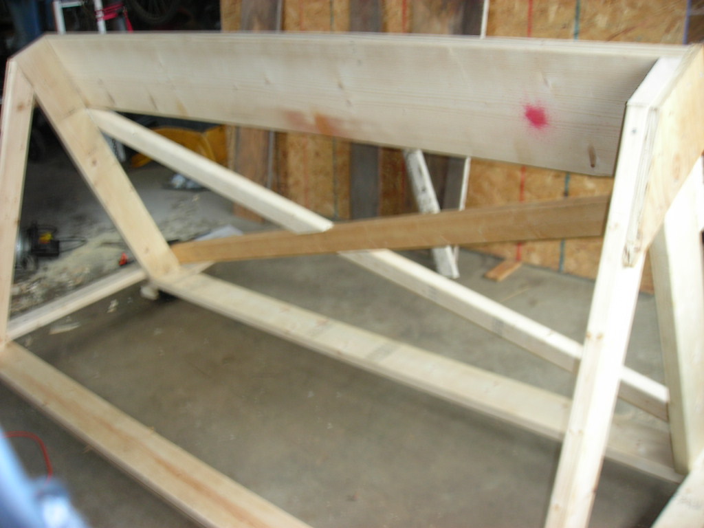

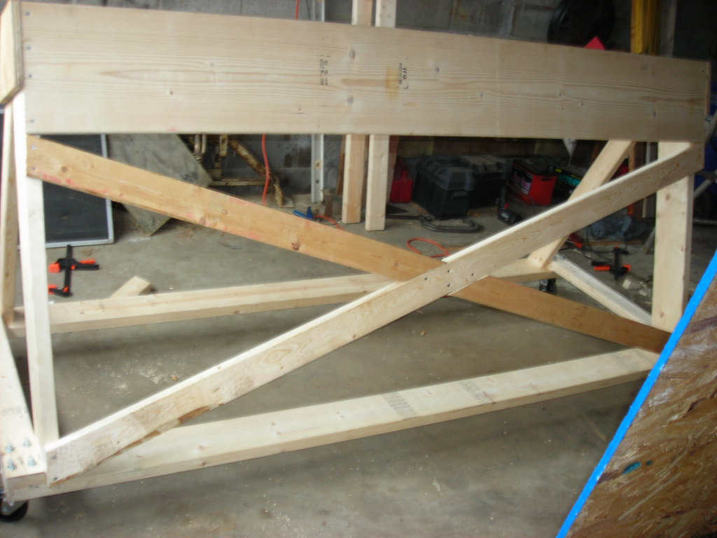

this is the motor stand my father in law is building for his motors and ,there might be some room for 1 or 2 of mine,ol,in the pics its not finished it will have a center support and a bottom in it to put the half ,plastic water barrel on ,so we can run the motors.

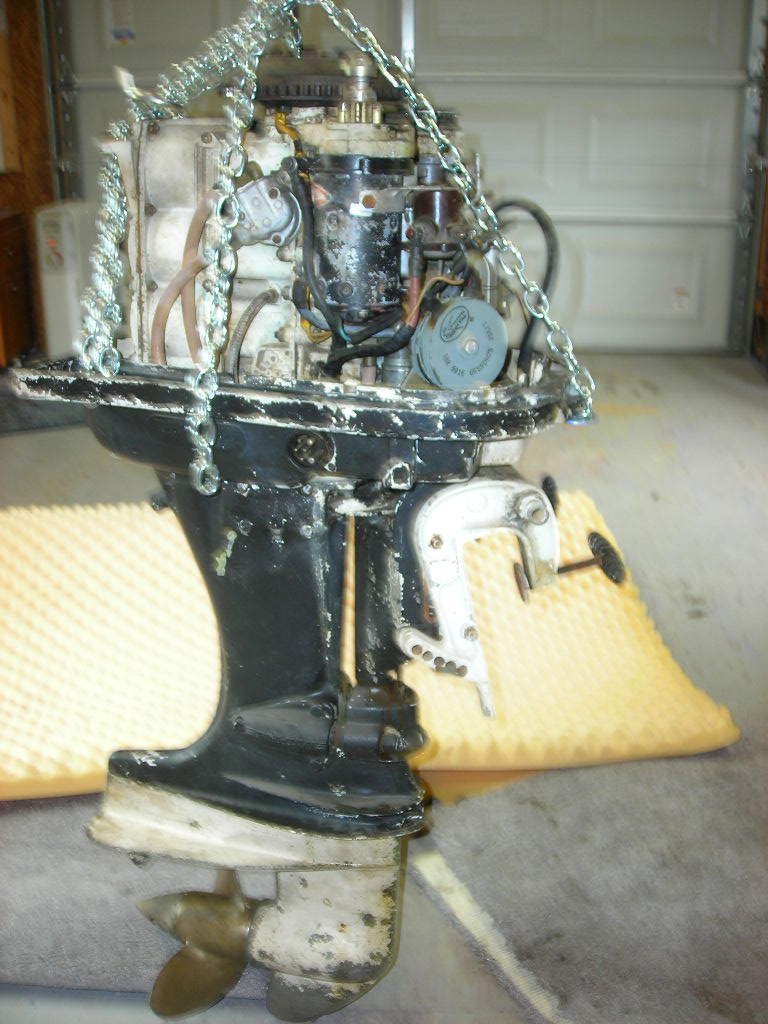

the other pic is my merc 450 awaiting restoration,it runs great thanks to tim calmes,but now it time for paint,lol,john

John, you need one of those merc lift rings!

frank yes i do,im not used to mercs,heck it takes alot just to get the top off the darn thing,i was going to put bolts through the holes for the cover but they are brass lined and i didnt want to screw them up,where the heck does the lifting ring go?
i made sure the chain doesnt hurt anything but its going to be a bear to paint it without a lifting ring.,john
Re:big motor stand 15 years 4 months ago #29008
Most merc lifting rings come as kits that do double duty as flywheel pullers John. They have a screw in fitting that goes into the very center threaded portion of the flywheel, then either use the lifting ring with it, or use it with a supplied bolt and wrench to remove the flywheel from its interference fit. Like this:
www.amazon.com/Mercury-Mariner-Flywheel-Puller-Lifting/dp/B002L2HNDW
Seems to me I got mine off ebay for maybe 25 bucks.
Re:big motor stand 15 years 4 months ago #29010
That was a good deal. I bought mine at a Merc dealer and paid about $40 for it and it doesn't have the flywheel puller option like the one on the link you posted. I would highly recommend getting one. I can pull my "Tower of Power" by myself with no problems. It is alot easier on the paint job and you don't have to worry about damaging anything on the motor.

will these lifting rings work on mine?,its a 1961,45 hp.on the flywheel is 3 bolt holes in a triangle patterern,can i use those to make a lift attachment for it?or would that hurt the motor
Re:big motor stand 15 years 4 months ago #29031
Is the very center of the flywheel threaded John?
Frank
Re:big motor stand 15 years 4 months ago #29032
  • john-gibson
  • Posts: 4014
  • Karma: 324
frank,i will have to look in the morning,its pretty crappy outside,lots of rain and its a bit of a wlak to the garage,lol.by the way thanks to you all for the replys,john
Re:big motor stand 15 years 4 months ago #29034
John, my Merc 700 had those same three treaded holes, and I used a regular puller to pop the flywheel off to change the timing belt. That flywheel also had the threaded center hole for the puller/lift ring, so either approach was okay for pulling the flywheel. As far as lifting the motor by those bolts, I donno. :unsure:
