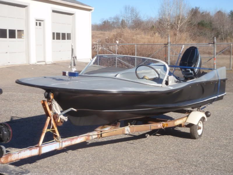

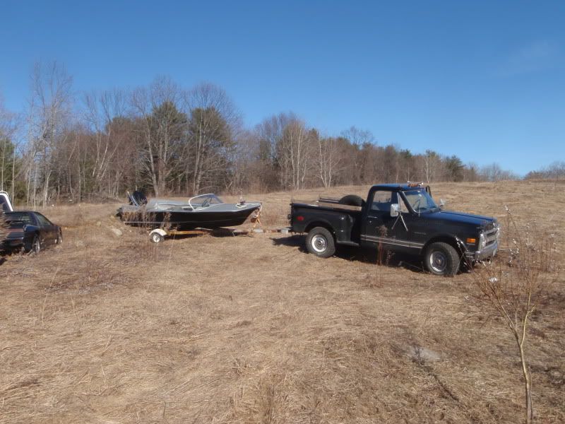

[img/] Hello! I just picked myself up a project - I must admit, I have an slight obsession with fins. I'm usually a classic car kind of guy, but recently I've been playing a lot more with old boats (and since boats is my professional interest, it makes sense)
My research indicates this is a '62 Custom Craft Sting Ray. Transom needs replacement, and the deck is cracked at the windshield base on both sides, so the deck has now seperated from the hull there.
The trailer and motor both date from the early 70's - trailer I'll keep (it's a Sterling), the motor is a Mercury 650 (which I despise) so I probably will sell it in favor of something a little more modern - after I try to get it running, of course ;)

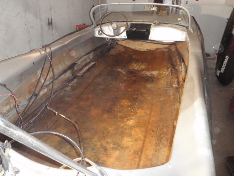

Thanks for all the welcomes! I am habitually a picture taker, so there will be plenty of photos, no worries there :P

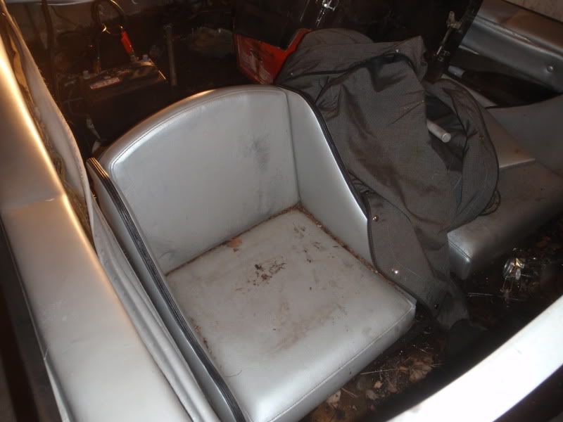

Tonight, took apart / cleaned / lubed up the starter, will reinstall tomorrow.

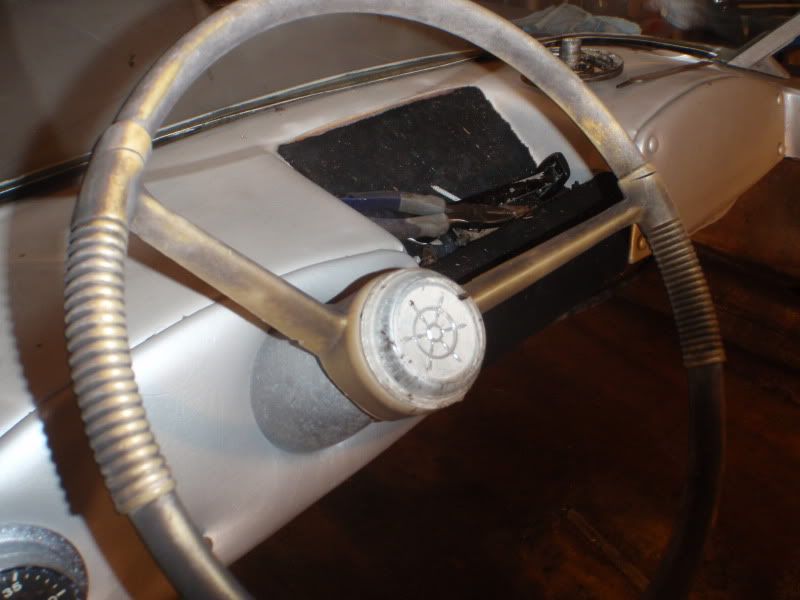

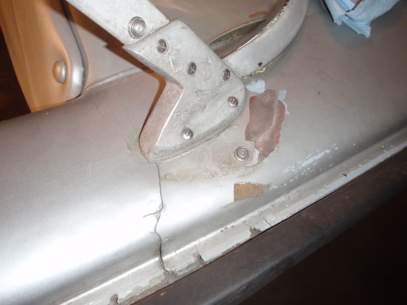

Other than that, started stripping the interior. Removed the vinyl covered side panels (these were original, it appears?), all the carpeting, and the seats. Found carpenter ants and ice inside the seat supports - they were so rotten I sucked them out with a vacuum...
But, I found the center cap for the steering wheel frozen to the carpet under the seat!

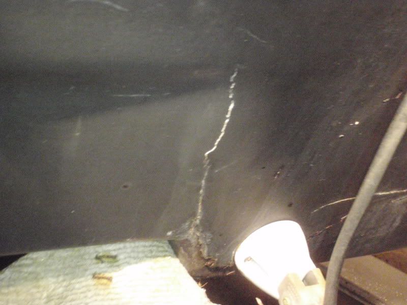

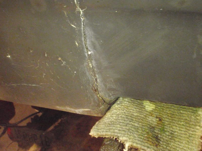

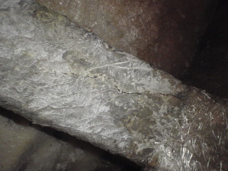

I found a few cracks, one in the starboard stringer and one on each side of the transom. Wood core in the transom is rotted, and as the pictures show the deck and hull are separated at the windshield and cracks in the deck are pretty bad there.
Still no luck finding a serial number ... will have to look more carefully as I go. Nice red though!

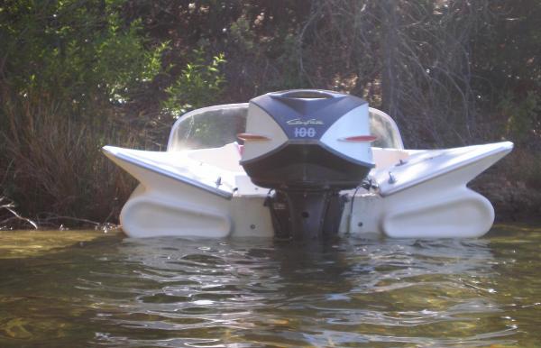

What is the purpose of these "whale tales"?
Andrew
Re:New here, with a new project! 14 years 2 months ago #28662
  • Mr. 88
  • Posts: 547
  • Karma: 13
The Tails in theory are supposed to get you up on plane quicker,allow you to plane at a lower speed thus saving you fuel money and help your boat if it porpoises. Newbees eat that marketing ploy up. Boat is underpowered,prop is not pitched correctly and load is not distributed properly are the real reasons for poor performance. What it does do is put a ungodly strain on your ventilation plate as it was not designed for that add on and may snap off at some point.It slows down your top end with the added drag and at best is a band aid patch that does not solve the real problem.I am sure there are more negatives.
If they work then why have none of the engine Mfgs. incorporated them into there drives?
cool runnings Mr 88
Re:New here, with a new project! 14 years 2 months ago #28663
Andrew
Basically a cheap fix for a bad set-up. Doesn't really fix it, but makes it bearable. Sort of like sticking a steel plate on a rotten transom.
Dave in sunny Buffalo
Re:New here, with a new project! 14 years 2 months ago #28665
I've seen them used for "correcting" prop walk / porpoising on an overpowered boat, too - does not work well for that, either.
Once I get the lowered squared away, it will come off. It's convenient for now, helps it to stay standing up on its own :laugh:

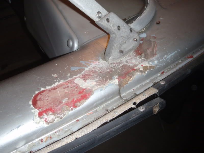

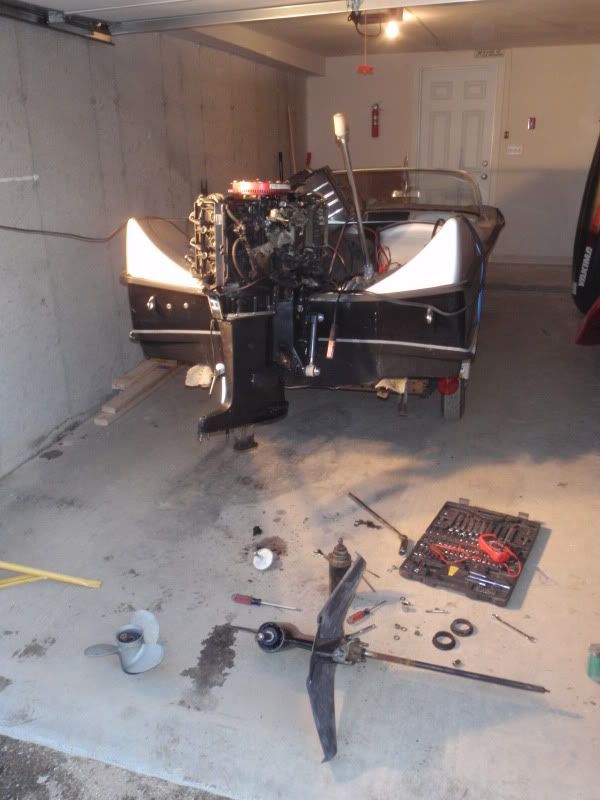

Tonight, pulled the rub rail, did a little investigation on the cracked deck, and the Merc lives! Now just to free up the lower unit...

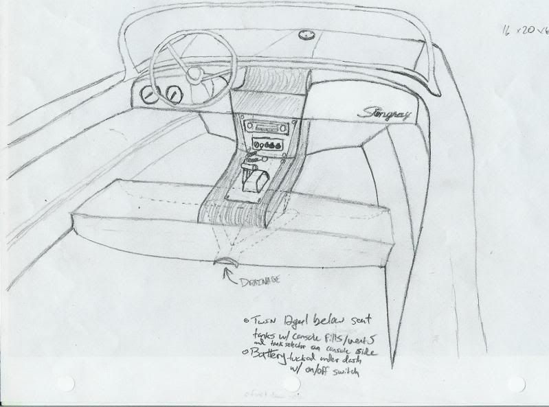

I did a little doodling last night, here's a concept of the idea I'm envisioning for this boat

wow..cool, i luv it.jg was going to do somethin like that with my mantaray. ron

Is that a 8 Track in the dash? Hah. From what I could read you plan on putting "twin 12 gallon" tanks under the front seat? Is that the gas fill deck plate in front of the shield? You got that Chip Foose look going on.
I am on the fence about the fill, but most likely there would be a fill on the back of the console, one on each side (didn't really fit in the detail level of the sketch)
The round thing up on the bow was a last minute add in, it's the new nav light I'm thinking of using. Not decided if I like it yet - might have to mold it into the deck for a better look.
In other news, tore into the lower tonight - *gulp*, making this up as I go along - it looks alright, the bearings on the drive shaft and reverse gear don't feel healthy...

I don't think that you would be able to fit that size gas tanks under the seats unless custom made.It almost might be overkill on your boat. I would think 18 gallons would last you all day.Might also not make it as bow heavy with the battery and your two main sitting positions in front of the center of gravity or planning surface.I am no engineer so as they say take it with a grain of salt.Just a thought.
cool runnings Mr 88
Re:'62 Custom Craft Sting Ray restoration 14 years 2 months ago #28957
It'll be a snug fit, but it will work with the tanks I am looking at - the seats end up being about 3.5" higher than they were originally. Also, I'm a lanky individual so I'll be shifting the seats aft probably 4" - 6".
And, I actually have a degree in ship stability and design :ohmy: , I'm definitely going to be tinkering a bit with the weight distribution to see how it'll balance out. Most early planing hulls I've seen are designed with too much weight aft for ideal performance, anyway.
I can tell you from experience that this model in particular will benefit from more weight up front and less in the back at least in certain set-ups. Of course mine has a large tower on the back. :P

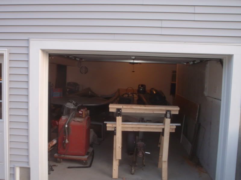

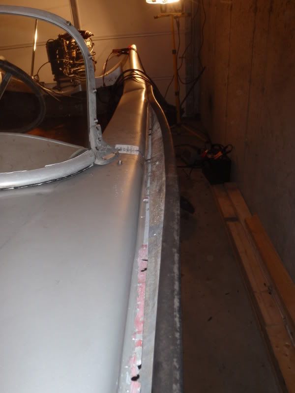

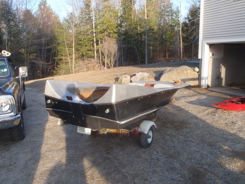

A little update - I'm going on a 2 month business trip (I work for the USCG, go figure), so the project will be on hold for a bit.

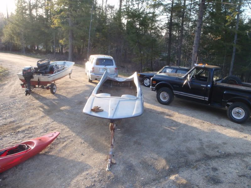

Got her all stripped down and ready to separate hull and deck in prep for glass repairs
The second shot is a great perspective of the hull lines - you can also see my other various toys, :P
And here she is, tucked away in the garage next to my '75 Whaler 13 sport, until I get home again. You can just see the merc hiding in the corner under the clock

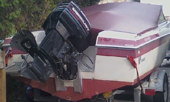

you know that you have a motor with a 20 inch shaft on while you need a motor with a 15 inch shaft? Maybe when you replace the transom you can rebuild it with a 20 inch transom or build a plate to lift the motor 5 to 6 inches. The boat will not perform right with a 20 inch shaft on a 15 inch transom.
I included a pic but I have a 175 Merc with a 25 inch shaft but my boat requires a 20 inch shaft so I used a set of CMC power lift plates.
I have to ask...did you start that motor with no water?
The motor did seem tall to me, but I didn't bother to check before I tore everything apart. It is as I bought it.
As to starting with no water - Yes I did. I only ran it for maybe a total of 25-30 seconds, not enough time for the motor to get warm, even. The lower was not installed (the impeller is trashed anyway).

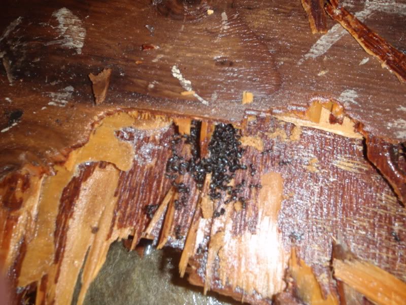

Re:'62 Custom Craft Sting Ray restoration 12 years 4 months ago #74026
Holy old thread Batman!
So life re-arranged my plans, but I've finally started working on this boat again.

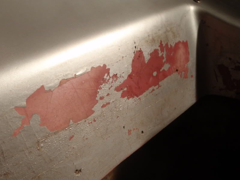

And pretty much everything is looking worse than initially anticipated. Go figure. Separated deck from hull in anticipation of repairing the transom, but I've got a long way to go before I get there:
Essentially all of the original remaining plywood supports have delaminated and are rotten
Meanwhile, the PO sandwiched a second layer of plywood behind the original, damaged dashboard panel, causing structural cracking (the deck is actually broken clean in two at this point, all that was holding it together was the rub rail)
And, much to my distress, after a year in the garage there is still a TON of water in the boat. I drilled more drain holes in it...

Re:'62 Custom Craft Sting Ray restoration 12 years 4 months ago #74054
Upon looking at the photos of the first post, I was wondering why in the hell a restored turn-key boat was sitting out in the dirt. Then I scrolled down & saw the close up pics of the condition of the boat. Now it makes sense. Splitting the boat & getting right to it was the rright thing to do and really, the only way to correctly get to the problem. The one and only Custom Craft that I've had my hands on was chopper built. It was like a giant potato chip - cracked everywhere. You might want to try some low prerssure sand blasting (with sand) in the reverse side of the structure as the only prep. Grinding can take of a dangerous amount of material. Just prep with light blasting, then lay a coule layes of chop mat over the cracked areas, backing that up with alternating layers of woven cloth and mat. When that is cured, flip the deck and grind back the original glass enough to feather out the crack. Then lay chop strand mat over the ground out (dished area) to over fill it. Then once this is cured, knock down the filled area until it is level with the original deck. Little if any filler will be needed, and the original damage will be eliminated - thus never creating a "shiner" under the new finish
If that nice little Merc ever fails to impress, get yourself a big ol' angry Evinrude Starflite III The engine that is so ugly it's beautiful on a rocket-era fin boat.
