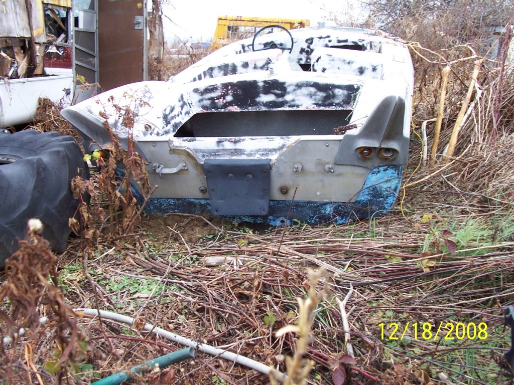

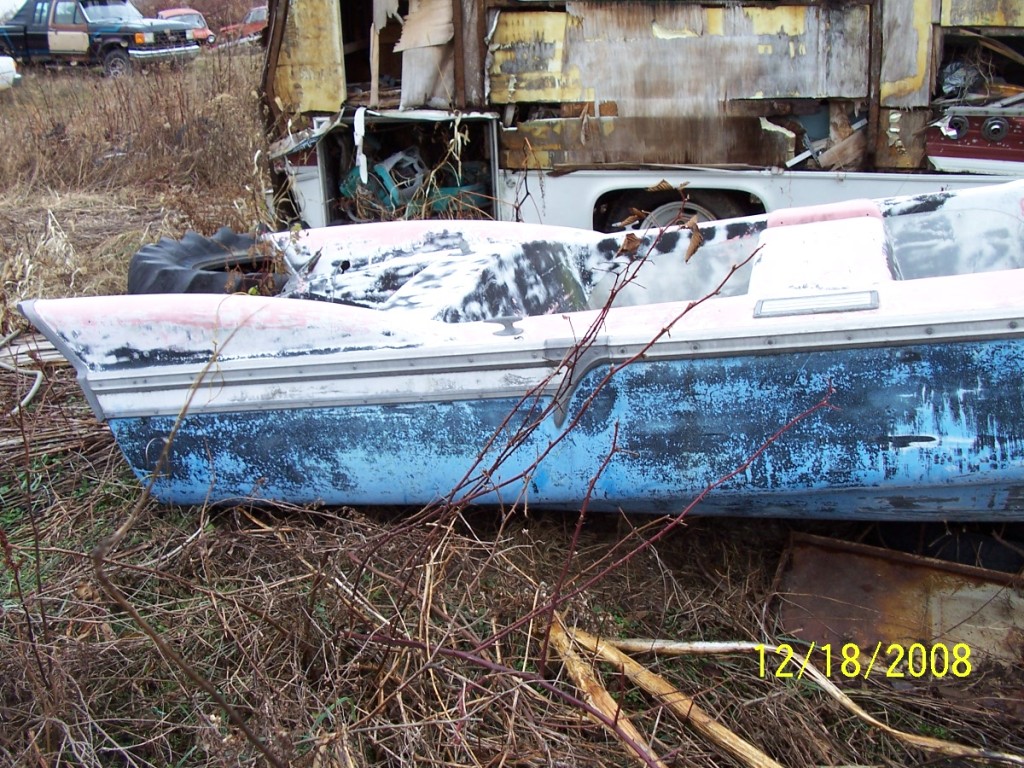

J: A side profile may give more info , BUT my 1st educated guess would be HERTERS flying fish . Should be lots of prior posts here.

thats kind of what i was thinking,these boasts arent to far from me,here are two more pics,john

this looks a bit like a herters but im not sure of the model,its not a 56 flying fish thats for sure,maybe a newer model,john

J: I would say 1958 .. or a 59 , as the tail lens are copy of a 58 Chevy .? . If this is close to you,, I would be down there making a offer . .. Brian Lawson in Albany knows all about these models.

The '58 Chevy didn't have fins.

I believe he was making reference to the tail light lenses themselves. The non Impala Chevy's had a very similar hooded housing without the upper fin portion. The Impalas were 3 individual housings and lenses and my guess the lenses on the boat pictured were red at one time and have faded.

You are absolutely right and I must apologize. For some reason my brain said "fins" when he obviously wrote "lens". Mea Culpa.

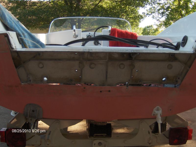

I believe that the red one is a Cutter Avon; maybe 58 or 59. Very cool boat. Needs to be restored. A nice partner for your Jet DeVille?

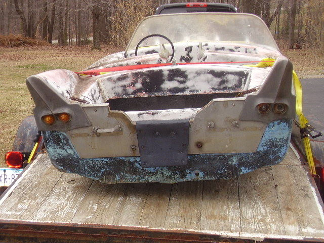

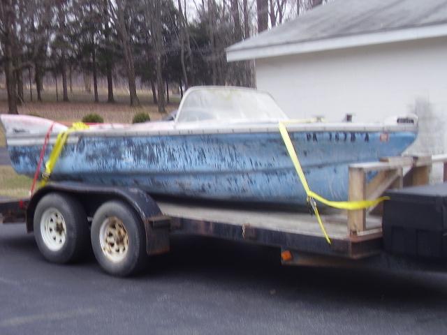

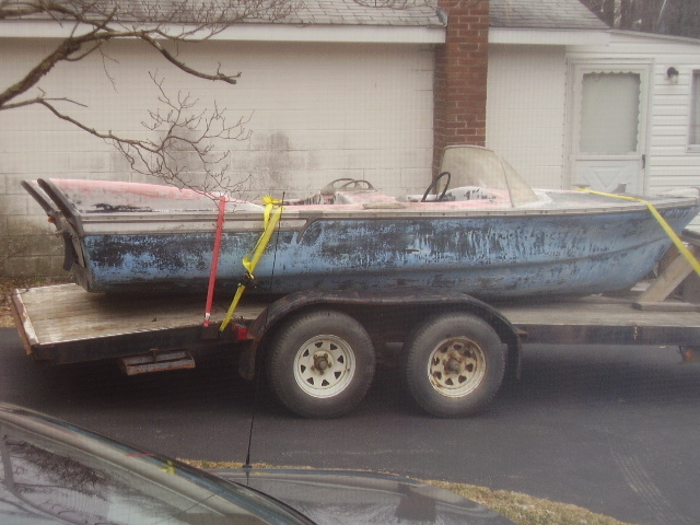

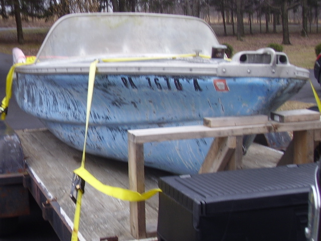

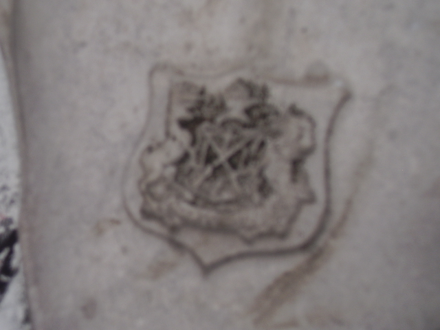

i have to thank robert lorrigan,he sent me the cl listing,thanks bob,ed bought both boats ,we plan on restoring both and MAYBE?sell them,but darn they are really cool,we just might keep them,lol.
the owner said he bought the herters 20 years ago or so and didnt know anything about it.
same for the cutter.heres some pics,most of the boat is there,except one lifting handle and a couple of lenses,john sorry about the blurry pics,im not used to eds camera.
did you notice its a port side steering,i was so into looking at the boat that i missed that,lol,ed pointed it out to me,lol,john the transom was cut down but it looks like a not to bad of a fix. check out the coat of arms on the nose piece,it has a stag standing on the left and a horse on the right.

That is an awesome looking boat. It will be stunning once you restore her. I am jealous. Love the ornate nose piece. Great find John.

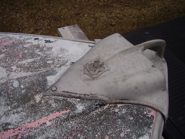

thanks andrew,they are cool boats,the nose piece i really like,i wonder if the holes in it are for 58 chevy taillights too,like clear back up lights?john
Re:what are these? 15 years 4 months ago #28628
They are nostrils of course!
Love the tail lights. Should not be to hard to find replacements for them.
Andrew
Re:herters and cutter,we got both,woo hoooo 15 years 4 months ago #28645
That nose piece is where the original bow lights were installed.
They used the ones that were powered by
"D" cell batteries. I think somebody added the bow light that is on it later down the line. Does that boat have the split deck. If not it is was built prior to 58..

That transom looks modified. They came with 15 or 17" transoms.
dave do you know of anypics of the owlight on this year and model?
yes it is a split deck in one of the side pics if you click on it to enlarge it you can see the 2 handles to help get through the split,john

Congratulations on your Herters find. Your model appears to be a 1959 Deluxe Flying Fish. It is a Deluxe because it has a built in rear seat instead of a bench seat, and it would be a 1959 because the 1958 Deluxe had tall fins while the Standard had the low fins.
All 59 Herters models, the deluxe, the Standard, and the Mark III had low fins.
Confirmation would be that your boat has the rear drain out the transom, not through the floor, and it does not have the aluminium knee brace supporting the transom. In the side view it does look like it has the earlier pass through grab handles found on the 58 models, but I have seen a few 59's with the early grab handles.
John, before you get too far into putting that boat back into the water you should check that transom very closely.
The stock transom height was 15 inches, with options of 20 inches for a long shaft, and 16 1/2 inches for a Mercury. Supposedly the boat was two to three mph faster with a Mercury set up and extra 1 1/2 inch above the standard 15, inches!
Your boat looks it was originally a 15 or possibly a 16 1/2 inch and someone cut it even lower.
Building up a transom in a Flying Fish could be a very expensive, difficult job because it's aluminium.
Without the knee brace in 1959 the transoms were prone to cracking (I have had two 15 inch Mark III transoms that were broken) and cutting the transom down even lower would weaken it even more.
Repairing a cracked transom isn't too difficult, it can be done externally or internally, but raising it back up to stock height could be a challenge.
Replacement with a wood transom is possible, but the rear tailfin castings are bolted to the transom for stabilty and support and that would have to be taken in to consideration.
To remove and work on the transom you shoud really remove the deck and taifin castings and unbolt the transom, but with all the fiberglass repair you will need to do to the transom area anyway, it might be quicker just to slice off the transom skin to at least get a look at it. I have done that to repair a transom on a boat that I didn't want to pull the deck off. You still can't get the transom out, but you can repair a crack from the back.
You might keep an eye open for a parts boat as a transom donor, but make sure to measure the width of your transom as the Mark III, although it looks lake a Flying Fish is three inches narrower through the stern and the aluminium transom may be narrower also.
A Flying Fish is definitely worth some time and money to resurrect, just giving you a heads up on what you might find in the transom area.

wow,i thank you flying fish for all the info,and yes i looked pretty good at the transom,im hoping to get the outer plate,tailfin plates off and maybe the inside skin,to see if it can be welded and strengthened,i think after hearing from you i will go one step further and add a knee brace,maybe 2.
its cool to know what we have for sure now,where there many of this year and model made?because this is the 1st one i have seen,john

Yep, Our Flying Fish came with the 16.5" transom. The first motor we had was a Mercury Mk 30. Then we put a 66 Merc 500 on it.
Raised the transom to 20" for that 500.
{ John: No I don't have any photos of the bow lights of that model.}
Kept breaking transom brace bolts on the floor after putting the 500 on.. Had to go to the next bigger size. That took care of that problem.

the 1st thing i noticed as we walked up on it was the transom butcher job,i could see down in it and see the frame work inside,so i figured it could be put back together,not going to be easy but i think its defenatly doable,i hope,lol.
my father in law was a welder in power plants ,im going to get him to weld the alumium.
