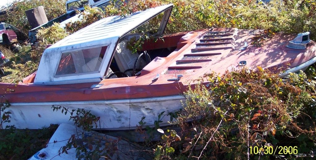

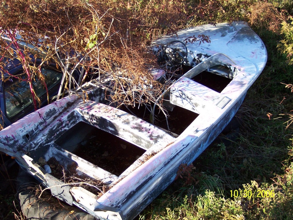

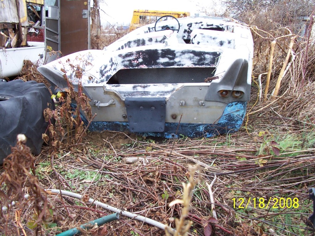

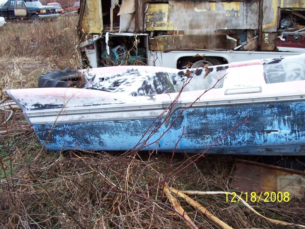

i know the red one is a cutter hardtop,but what year and model?
the white one with the fins ,i dont know what it is,it has amber taillights i have to go back for the pic of the cutter,john

J: A side profile may give more info , BUT my 1st educated guess would be HERTERS flying fish . Should be lots of prior posts here.

thats kind of what i was thinking,these boasts arent to far from me,here are two more pics,john

this looks a bit like a herters but im not sure of the model,its not a 56 flying fish thats for sure,maybe a newer model,john

J: I would say 1958 .. or a 59 , as the tail lens are copy of a 58 Chevy .? . If this is close to you,, I would be down there making a offer . .. Brian Lawson in Albany knows all about these models.

I believe that the red one is a Cutter Avon; maybe 58 or 59. Very cool boat. Needs to be restored. A nice partner for your Jet DeVille?

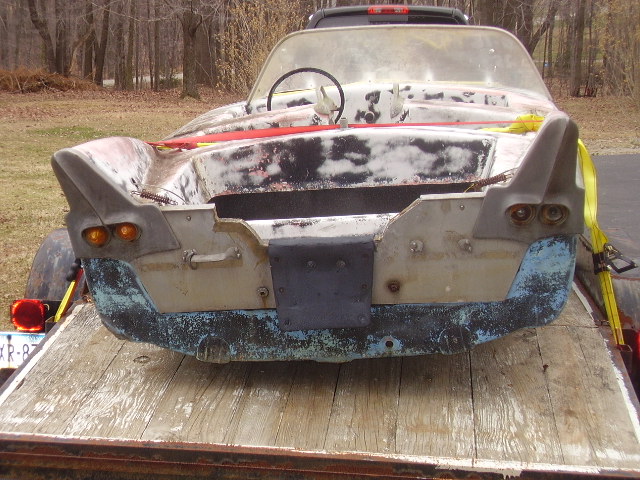

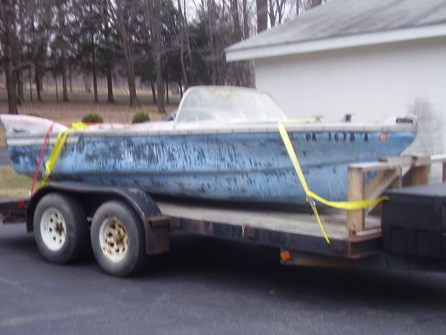

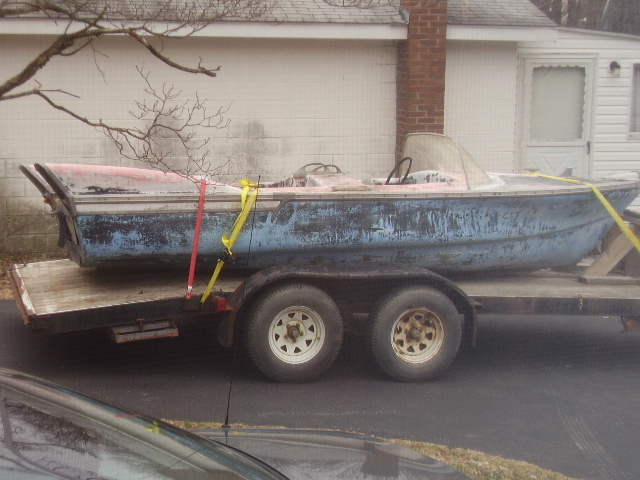

i have to thank robert lorrigan,he sent me the cl listing,thanks bob,ed bought both boats ,we plan on restoring both and MAYBE?sell them,but darn they are really cool,we just might keep them,lol.
the owner said he bought the herters 20 years ago or so and didnt know anything about it.

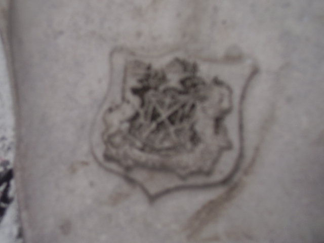

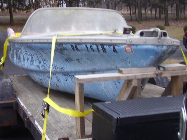

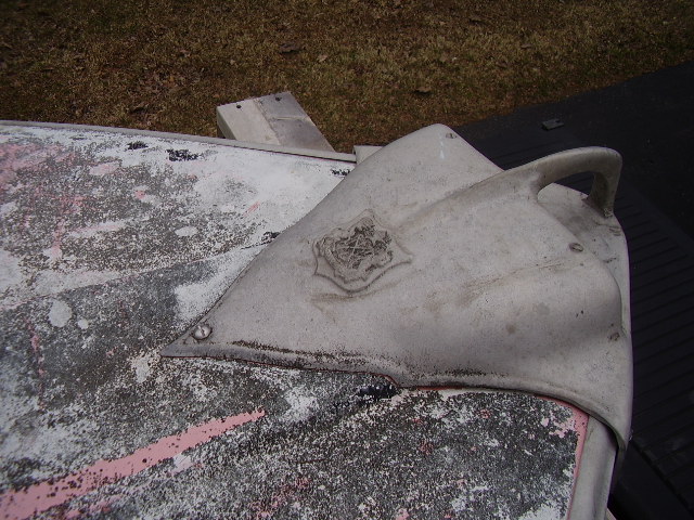

same for the cutter.heres some pics,most of the boat is there,except one lifting handle and a couple of lenses,john sorry about the blurry pics,im not used to eds camera.
did you notice its a port side steering,i was so into looking at the boat that i missed that,lol,ed pointed it out to me,lol,john the transom was cut down but it looks like a not to bad of a fix. check out the coat of arms on the nose piece,it has a stag standing on the left and a horse on the right.

thanks andrew,they are cool boats,the nose piece i really like,i wonder if the holes in it are for 58 chevy taillights too,like clear back up lights?john
Re:what are these? 15 years 1 month ago #28628
They are nostrils of course!

That nose piece is where the original bow lights were installed.
They used the ones that were powered by
"D" cell batteries. I think somebody added the bow light that is on it later down the line. Does that boat have the split deck. If not it is was built prior to 58..

That transom looks modified. They came with 15 or 17" transoms.

Congratulations on your Herters find. Your model appears to be a 1959 Deluxe Flying Fish. It is a Deluxe because it has a built in rear seat instead of a bench seat, and it would be a 1959 because the 1958 Deluxe had tall fins while the Standard had the low fins.
All 59 Herters models, the deluxe, the Standard, and the Mark III had low fins.
Confirmation would be that your boat has the rear drain out the transom, not through the floor, and it does not have the aluminium knee brace supporting the transom. In the side view it does look like it has the earlier pass through grab handles found on the 58 models, but I have seen a few 59's with the early grab handles.
John, before you get too far into putting that boat back into the water you should check that transom very closely.
The stock transom height was 15 inches, with options of 20 inches for a long shaft, and 16 1/2 inches for a Mercury. Supposedly the boat was two to three mph faster with a Mercury set up and extra 1 1/2 inch above the standard 15, inches!
Your boat looks it was originally a 15 or possibly a 16 1/2 inch and someone cut it even lower.
Building up a transom in a Flying Fish could be a very expensive, difficult job because it's aluminium.
Without the knee brace in 1959 the transoms were prone to cracking (I have had two 15 inch Mark III transoms that were broken) and cutting the transom down even lower would weaken it even more.
Repairing a cracked transom isn't too difficult, it can be done externally or internally, but raising it back up to stock height could be a challenge.
Replacement with a wood transom is possible, but the rear tailfin castings are bolted to the transom for stabilty and support and that would have to be taken in to consideration.
To remove and work on the transom you shoud really remove the deck and taifin castings and unbolt the transom, but with all the fiberglass repair you will need to do to the transom area anyway, it might be quicker just to slice off the transom skin to at least get a look at it. I have done that to repair a transom on a boat that I didn't want to pull the deck off. You still can't get the transom out, but you can repair a crack from the back.
You might keep an eye open for a parts boat as a transom donor, but make sure to measure the width of your transom as the Mark III, although it looks lake a Flying Fish is three inches narrower through the stern and the aluminium transom may be narrower also.
A Flying Fish is definitely worth some time and money to resurrect, just giving you a heads up on what you might find in the transom area.

the 1st thing i noticed as we walked up on it was the transom butcher job,i could see down in it and see the frame work inside,so i figured it could be put back together,not going to be easy but i think its defenatly doable,i hope,lol.
my father in law was a welder in power plants ,im going to get him to weld the alumium.
