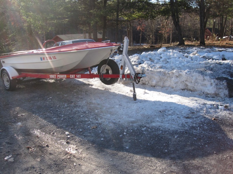

After chopping through a whole bunch of ice, everywhere you can see it under the front of the trailer/boat. Pulling hubs today, gonna get the old backing plates off (maybe) and start saving my pennies for a hydraulic actuator/coupler, and brakes.

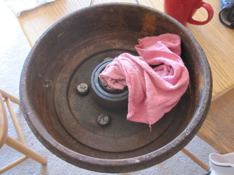

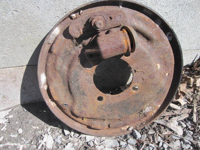

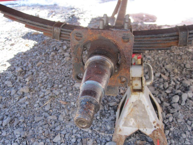

Hi John, I got the drum/hubs off, that wasn't too difficult. Got one backing plate off, broke three of the 4 bolts just trying to turn them off.
This is a 3500# trailer axle, set up for brakes. When I got the trailer, it didn't have a coupler on it, so I got a regular one to haul it home. When I was putting the trailer together for the Power Cat I tore all the brake stuff out to insure shoes wouldn't suddenly pop out and put the brakes on while on route somewhere. What I need (at least) is a hydraulic brake actuator/coupler ($150), new backing plates with all the "stuff" ($150 for a pair), and a longer tongue for the extra length needed for the new coupler. I wanted a longer tongue anyways, but 10' of 3" X 1/8" wall is $62, so that may wait a while. I have the original tongue for this trailer, but it's real heavy - 3 X 4 heavy wall. It's more than long enough though, and just to save $, I may start out with that. Hopefully I won't need new drums/hubs, as that would be a additional expense of 100 bucks. I'm going to run these drums into NAPA today to see if they can be turned and re-used, get some new seals and some emery cloth to polish the spindles.

Well folks the trailer weighs at least as much as the boat. I figure I'm towing at least 1500#s. The trailer is so heavy because the back end where the axle is came off a heavy duty boat trailer that came with brakes.
NYS is one of two states that require brakes on gross trailer weights over 1000#s. It's not that I worry about being stopped and checked, it's that I want to reduce brake wear on my small pickup, and I want to assure I'm traveling as safe as I can. So really it's just me being an old man.
My brake drum hubs are a mess, need a complete rebuild at least, if not replacement if I'm going to have brakes. I'll know later this week.
