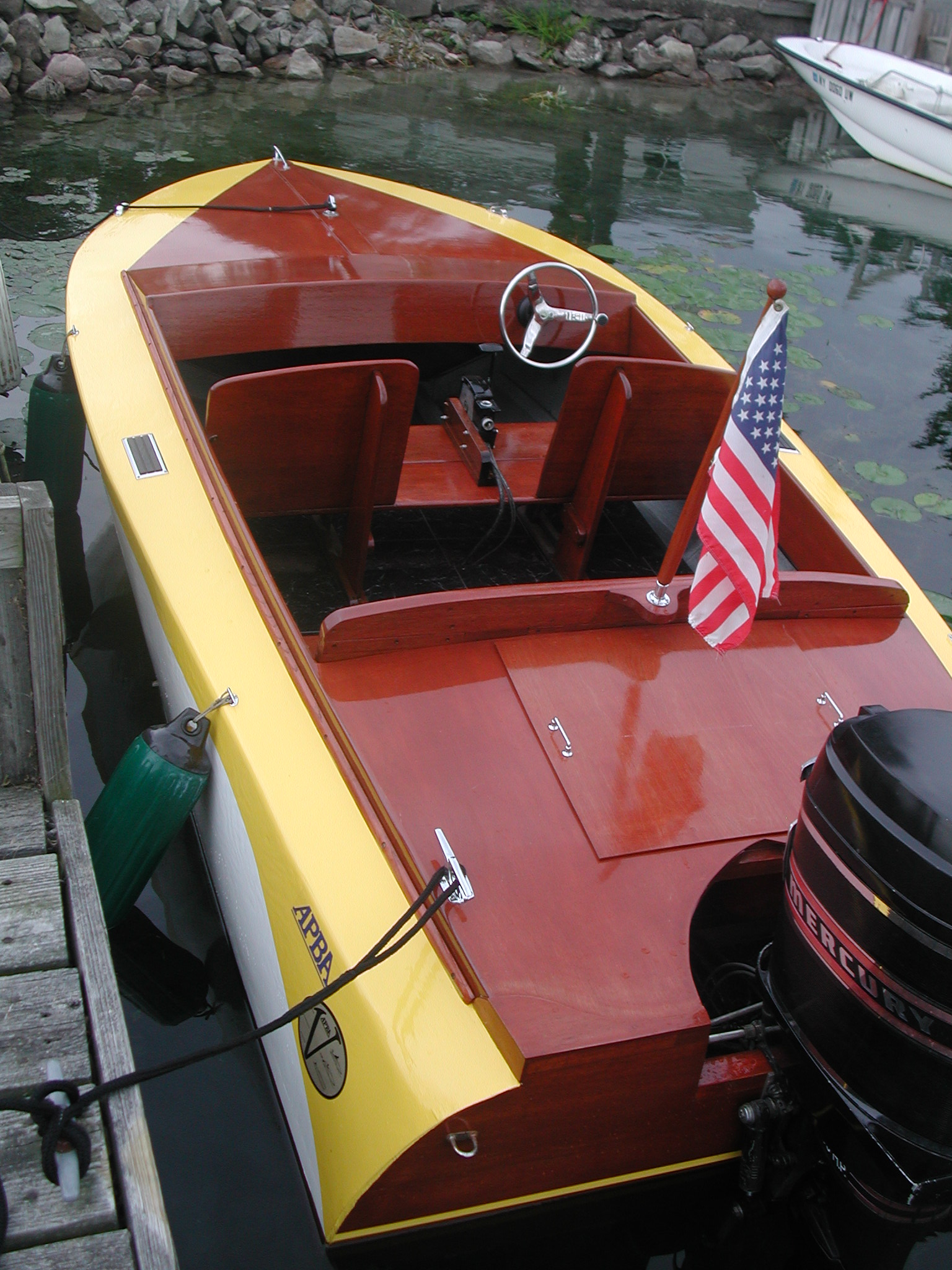

Re:Throttle Question 15 years 4 months ago #27573
Like this?

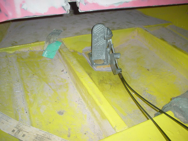

Re:Throttle Question 15 years 4 months ago #27610
Sorry about that, i should have been more desciptive to begin with. To start, at the moment the boat is completely gutted and can be seen here - Click Here
Since those pictures were taken everything else has been removed: engine, trolling motor, throttle etc... It is a 13ft fiberglass whaler knockoff (nobody knows what it is). It came with a side mount Evinrude Simplex throttle. I plan on building a center console similar to what the original whalers had and would like to use the same throttle instead of spending $200 on a top mount throttle.

Re:Throttle Question 15 years 4 months ago #27669
  • Mr. 88
  • Posts: 547
  • Karma: 13
Well after scrolling down to your original post I see you have a wooden floor.IF you are going to go with a center C now would be the time to either feed the steering/throttle cables under the floor or make a PVC conduit for them to go through in the future. That wood looks like it has to be replaced and who knows what water logged material is under there. Time to check it out and let us know what you find.If your making a CC then incorporate a small block of wood to affix the controls to. I would guess that you would have to mount it so the cables are facing down so they are out of the way and heading towards the floor opening.Vertical instead of horizonital.Steering cable had a certain area it needs to turn as well and that has to be taking into consideration as well as what system you plan on using,cable,teleflex etc. Maybe you can take a pic of your plans and post them for us to get a better idea of what you are thinking.

Re:Throttle Question 15 years 4 months ago #27709
My brother-in-law has a beautiful 13 ft Whaler with the mohogany bench seat, hatch cover, and steering council. The controls are on the starboard side. The boat isn't big enough to have any type of stand-up council and still be safe. It's a great little boat, and the older 30 hp Yamaha 2 stroke pushes it along a good 30 mph.
Bill
