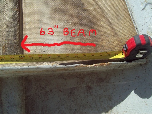

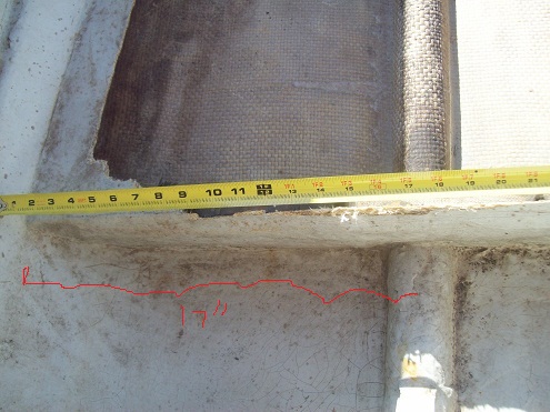

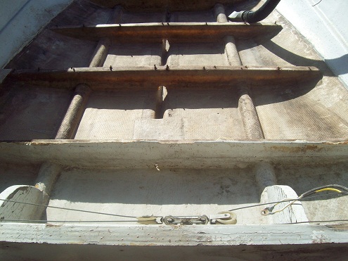

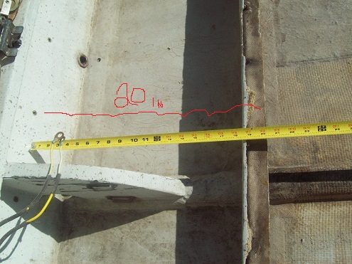

OK I got the floor up for the most part today and wondering about the layout of the interior. I'm thinking back to back on the front and a bench in the back. I'm wondering more about placement of gas tank and battery as it seems to be space challenged. Thinking I will have to make a hinged bench for storage. Any thoughts? It's about 68" at the last cross member which is 20" from transom. The aft sec is 17" on both sides and 29" center that will be left open. Hell I think I am confusing myself!!!!
Re:Suggestions on Invader interior?? 15 years 4 months ago #27390
hi joe,i think you can put a 12 gallon tank in there,ill have to measure mine tommorrow,how wide is the tank your putting in?and you have room for a battery box too,and what im planing on doing to the cutter is put a bench seat in the back,that the back folds down to get at the gas and battery ,plus the whole thing will fold forward to get under the seat,using stainless piano hinges,something like this,it might be what your already talking about,this way i can get at the gas without lifting the seat.but if i need storage the seat folds forward,i have a few rare earth magnets that will hold the back in place against the splashwell,john,i have a crappy drawing of it but its a pdf and wont post,if you want i can email it to you,john
