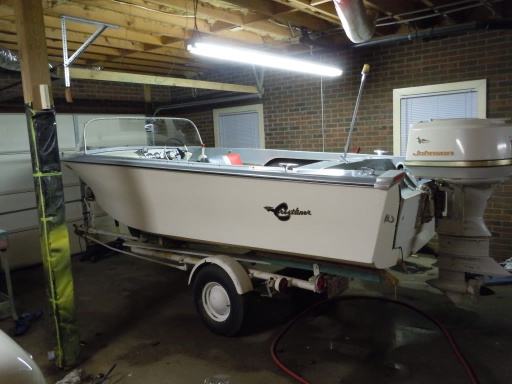

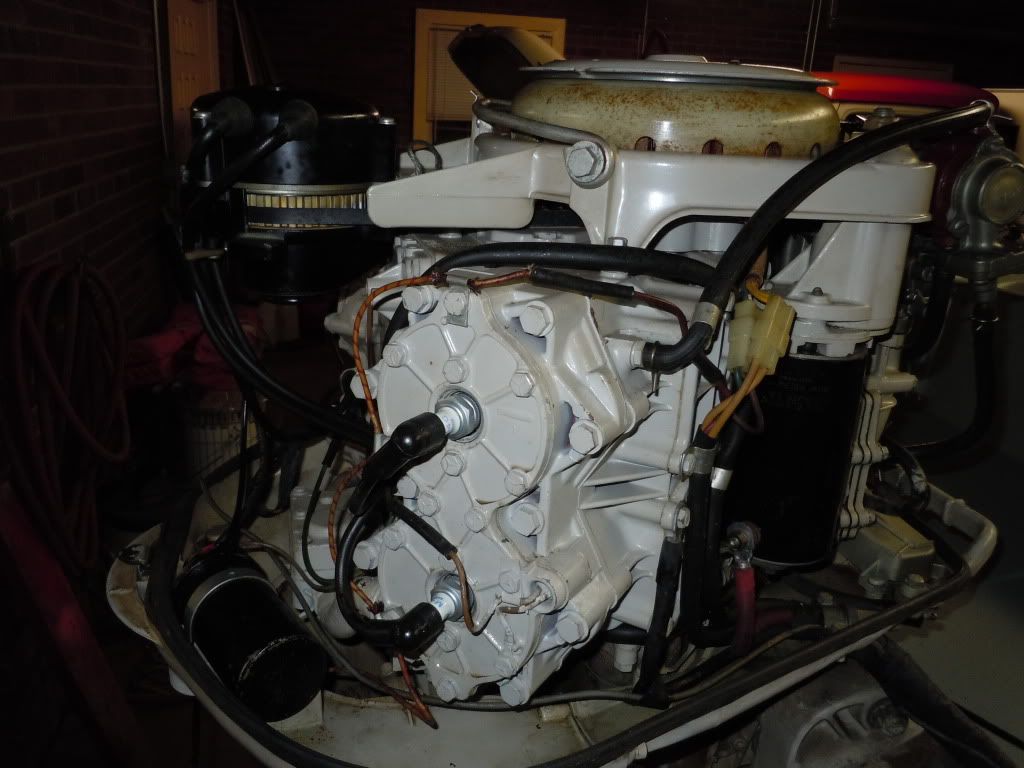

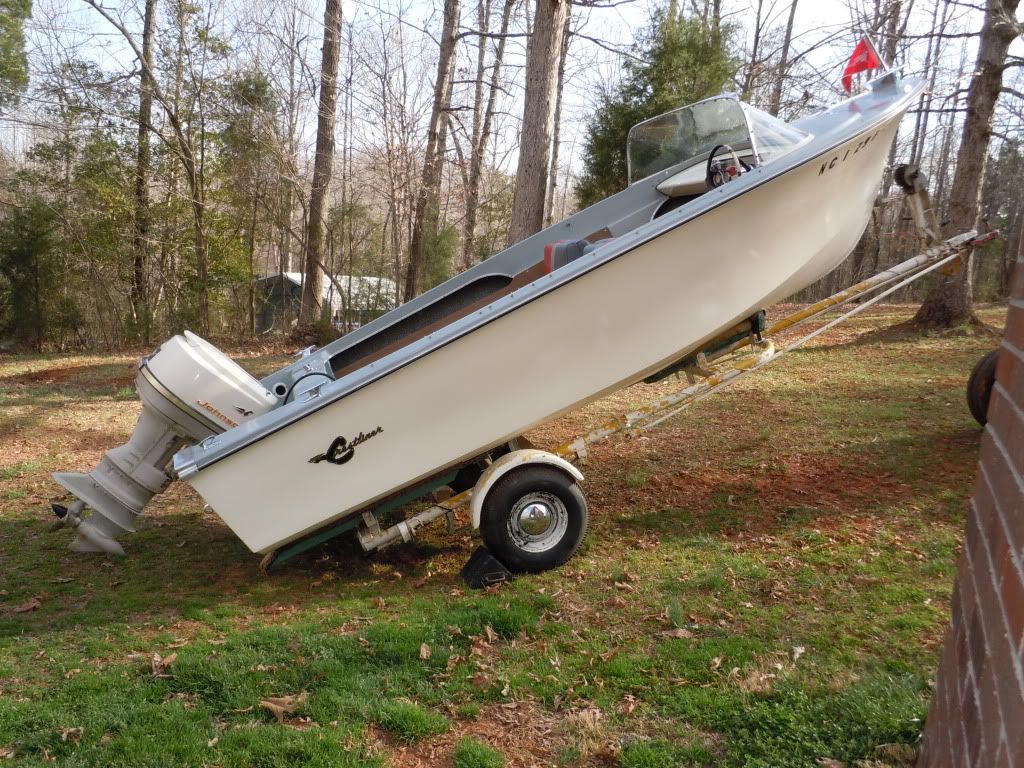

I recently found another old boat that is in good condition. Thought I would share some pics. Just got it today so I'm kinda stoked.It's a 1962 Crestliner Del Rio with a 62 75 Johnson

Looks good Jim.
Neil
Neil and Mary Ousnamer
Re:And then there was two 15 years 4 months ago #27308
NICE find Jim, she appears to be in excellent condition! Can't wait to hear and see more.

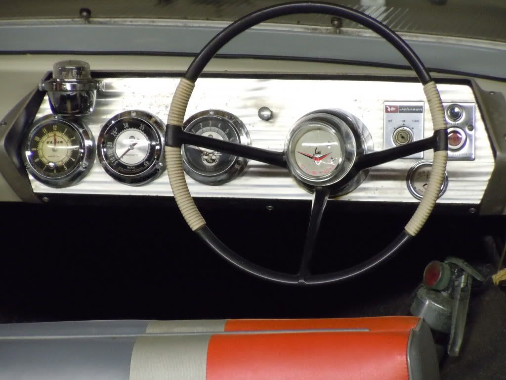

Nice ride! Is that a tac, speed and clock in the dash?

Yes, from Sears. Looks like AquaMeter made them for Sears.I checked the compression of the engine cylinders.Comes up to 100# per cylinder. I hope to start it this weekend. And the clock still works :laugh:

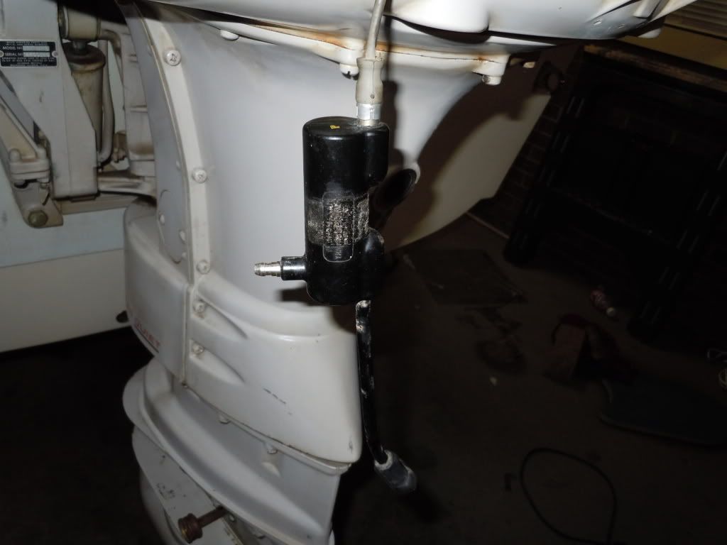

Two is my limit.LOL.Thanks, It don't need much. I think it will need a fuel pump kit and maybe lower unit seals. I got it to run this afternoon,but had to squeeze the primer bulb to keep it going. I think I might get by without a carb rebuild. Used some seafoam and it just kept getting smoother and smoother.It's got a wire that either plugs into #1 spark plug wire or to the coil for the sears tach, I don't know which. Any ideas?
And it don't show to have ever heated.

Jim, before you go through all the work rebuilding the pump, and loosing the springs (well I do anyway) check the o-rings in the hose. If they get hard from sitting a long time it can suck air.

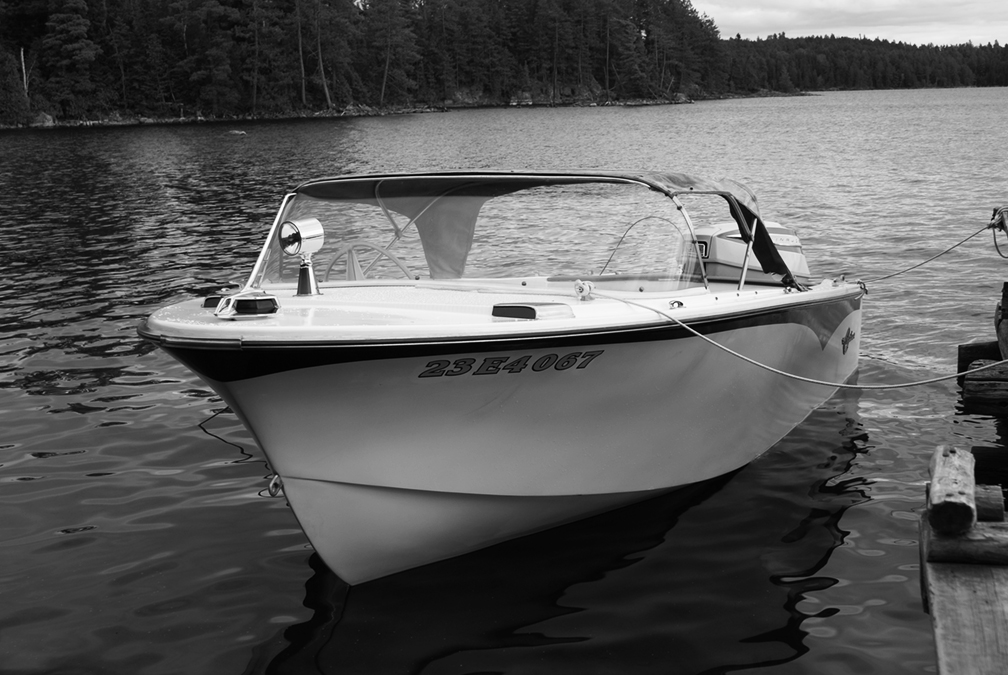

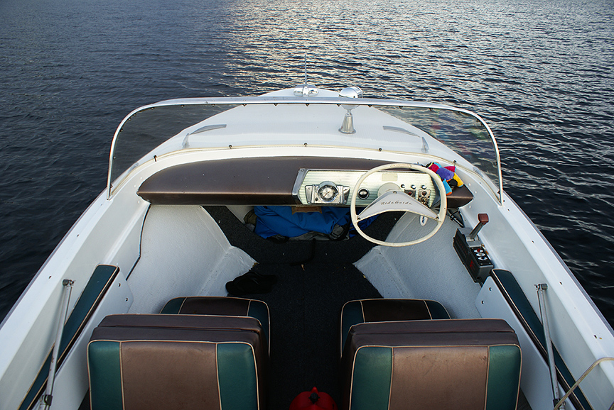

As you can see I have the same model and year but with an ERude Starflite 100-S which was brought back after 40 some odd years and hit the water last summer. You're going to love this boat. From what I can see in the pictures, she is in great shape, all original (love the faux hardwood floors) Cant wait to hear more,

Jim, until this boat, I had not had a great deal of experience on "ride" for a boat of this age however when i got her out, I was very impressed with her responsiveness; speed and ease of control - all and all a really nice boat to have out on the water, and given her bow, handles rough water very well. 40MH with a 75 should be doable :)
You might find the folowing strings for my resto of interest if you haven't already found them. Any shots of the dash, stern, flooring, anything really - it's nice to compare how boas of the same year have aged.

Your Del Rio looks great Matthew!I think if I ever repaint the hull on mine I might go with the imperial stripe like yours.The hull on mine has tiny spider web cracks all over it. The deck doesn't, go figure.I unlocked my photobucket if you want to see what pics I have of it.Excuse my double pics and blurry pics. :laugh:

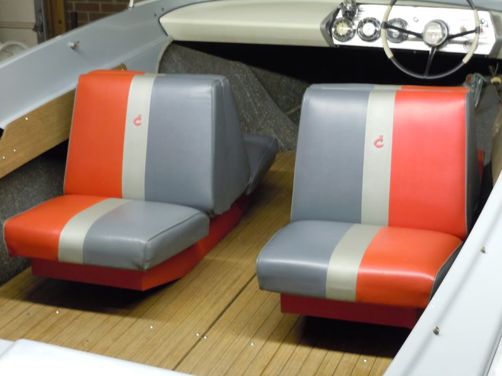

Spectcular photo's, thanks. She looks to be in really fine shape - do you have any history on her, looks like she has been well protected from water entry. As you can see from my resto pics, my DelRio had taken a lot more of a beating when I first found her. I picked her up for $400 for the boat, motor and trailer however so I can't complain.
When you lifted the plywood decking, did you only find foam losely place in between the stringers? When mine came up, I had poured foam in all of the sub-floor cavities. Also, if yes, does yours have cross flow holes so that any water that did make it beneath the floor could make it to the drain hole at the stern?
Your interior looks immaculate throughout. Did she come with any canvas as I note the two wing-nuts beside the seats on the side wall which is where the cover for mine attaches.
You really have found a Del Rio in really excellent condition, and your Erude looks almost un-used - amazing find.

Oh, and the Imperial Stripe came originally in what the manufacturer referred to as Sea Mist Gray, I took it to a black and the deck to white as it had seen some real outdoor sun and I as well have some spider cracks to contend with - Matthew

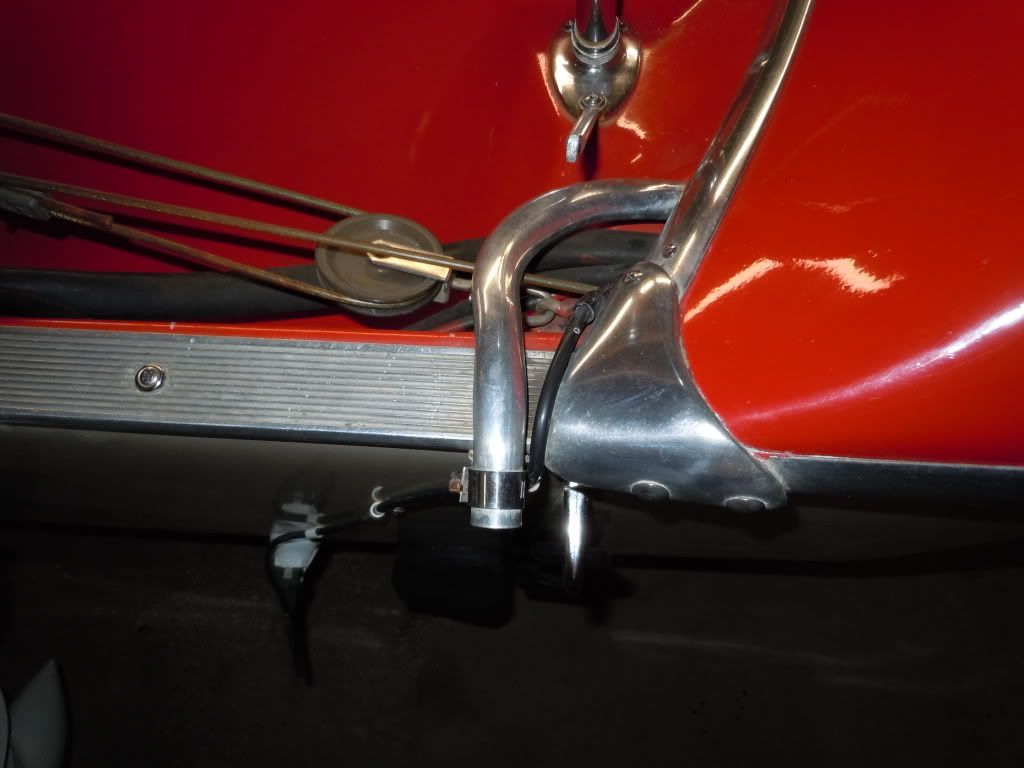

I took an aluminum tube and made a drain for the aristocraft so I wouldn't have to drill.
Pretty cool idea Jim, I like it! I plan on putting a bilge pump in the Starflite, but was agonizing over the thru-hull fitting hole like you are/were. Think you may have provided the solution there. ;)
