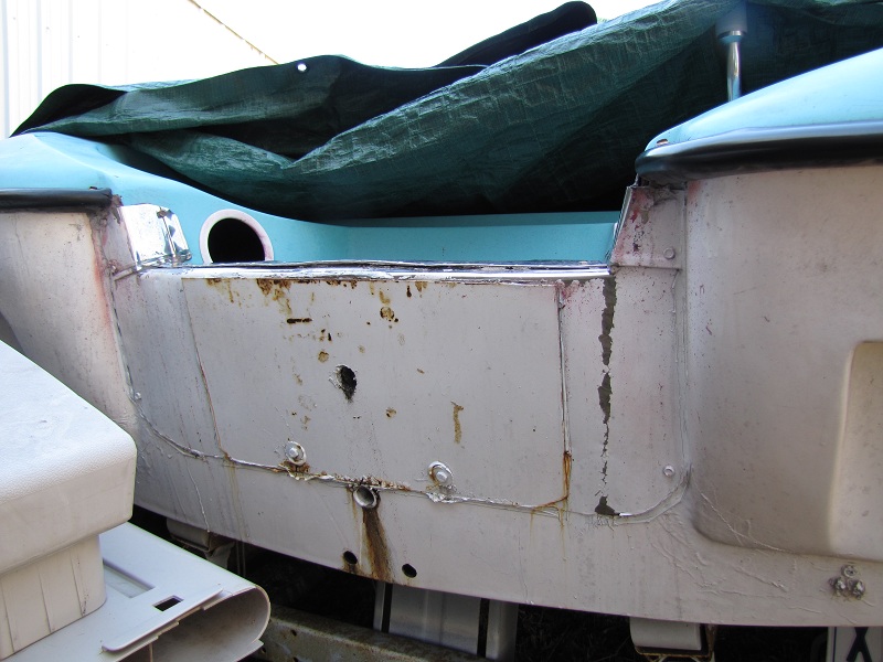

mr88,thanks ,i have a close up pic thats too big to put up and this transom needs a total restore,its pretty bad.
and tim has a longshaft he can do for me."master restorer"lol,lol that is funny,john
frank i dont know until i get it here but it sure looks like it was higher,it has stuff covering it up so its hard to see and tim needs to know now so he can build the motor.
i think im going to make it a long shaft,i know 15,16 inches is short shaft,but i think the transom was originaly higher but was cut down to make the short shaft johnson work that was on it.john

I hope to pick it up this coming Sunday. I'll know as soon as I see it. From that picture you posted, it could easily be stock too. Will that be too late for Tim?

I would get rid of that Gobbly-Gook on the back, run the new transom straight across at 17-18" and run a short shaft motor. If it sucks air I would be surprised.

frank i dont know if that will be too late or not,he can probanly work on the rest of it for now,
i might be wrong but i am betting thats what happened ron.
jerry thats my plan to cut out and get rid of the previous repairs and start over,making it look as clean as i can.my guess is at straight across it will be the 20 inch transom,john

John, take it straight across at the 17" level and run a short shaft. That doesn't look like 4", but 20" would be the max for a long shaft and have a bunch of lower unit dragging in the water. Just a guess. I would talk to someone who has raced one of those motors to see how high you can lift it. Put a tape on it. I'm curious. The tunnel may lift it up a bunch at speed. Better yet, go 20" and a jack-plate. Just thinkin' out loud again. lol

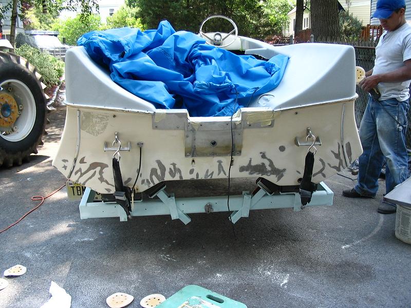

OK. Since I was the one that sent john the oversized pic, let me try posting it at a reasonable size. The only way to tell is to take the SS cap off and see what is underneath.

jerry now you can see why i THINK it might have been shortened,because of the stainless sheet metal bolted up above the transom,john

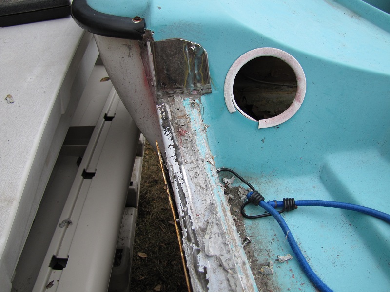

NEWS FLASH! I unbolted and pried back some of the SS covering on the boat. I believe that the transom height is original to the boat. There appears to be green across the top of thetransom. Will investigate and take some pics later.

thanks todd,now i can tell tim what i need,do you know why the plates above and on each side of the transom are there?it must be that the transom was pulling away,at least thats a guess,take apart anything you want,it has to be replaced anyhow,lol,john
Re:transom height on a 62 devil ray? 15 years 5 months ago #27267

I finally got the pic and time to post it. It definitely is the original height and there is some damage to the transom

thanks todd that helped alot.
you can see the reason i was wondering is the piece of stainless bolted to the splashwell,above the transom,in the pic.
it looked like it was covering where it might have been cut down,i thank you again todd for clearing this up john
