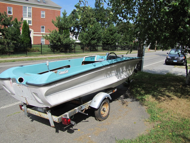

OK. Since I was the one that sent john the oversized pic, let me try posting it at a reasonable size. The only way to tell is to take the SS cap off and see what is underneath.

I finally got the pic and time to post it. It definitely is the original height and there is some damage to the transom

thanks todd that helped alot.
you can see the reason i was wondering is the piece of stainless bolted to the splashwell,above the transom,in the pic.
it looked like it was covering where it might have been cut down,i thank you again todd for clearing this up john
