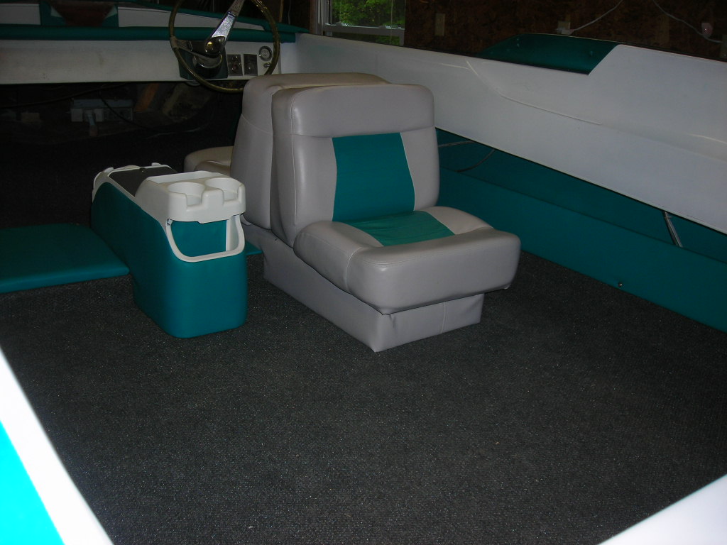

For the money, I am well-pleased. Here are some pictures. of the new carpeting and the seats. They are not screwed down yet as I still have some transom work to do.

hi clark,nice seats,they look good.as for the corner pieces ,they are usually just for shipping they can be taken off if you want.
as far as seat base height 10 inches is the usual standard,but they can be cut down .

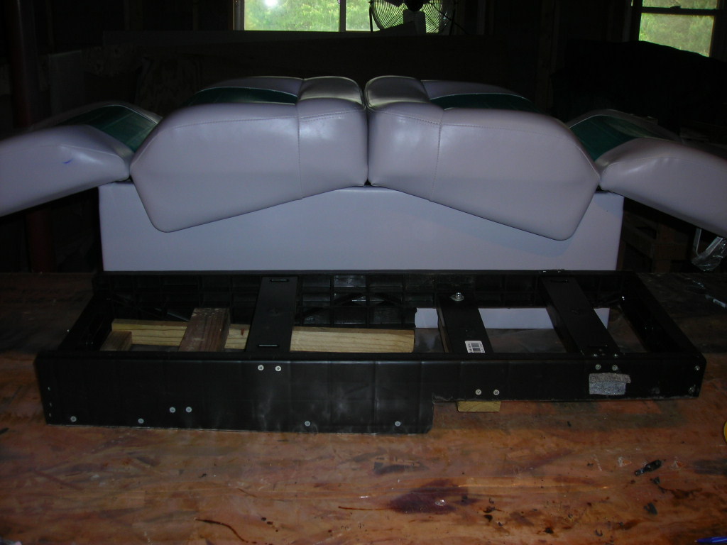

are the base of the seats made of honey comb plastic,if so here is how i had to cut down a set of bases that had to be cut way down and had a cutout to go over a ladder type floor system,plus they had to be cut to match the floor which was not a flat floor,if you cut them you will have to add wood to reattach the vinyl,john

Your interior is starting to look pretty sharp there Clark! The new seats and carpet make a big difference. Those appear to be 10" high base units. Many are offered in 8" or 10" heights, some only the 10". You might want to flip them over and inspect the base, see if you could trim the height down to whatever you're happy with. (Even if the supplier agrees to exchange them, the freight to and from will be prohibitive, to me anyway.) Just a thought.... ;)

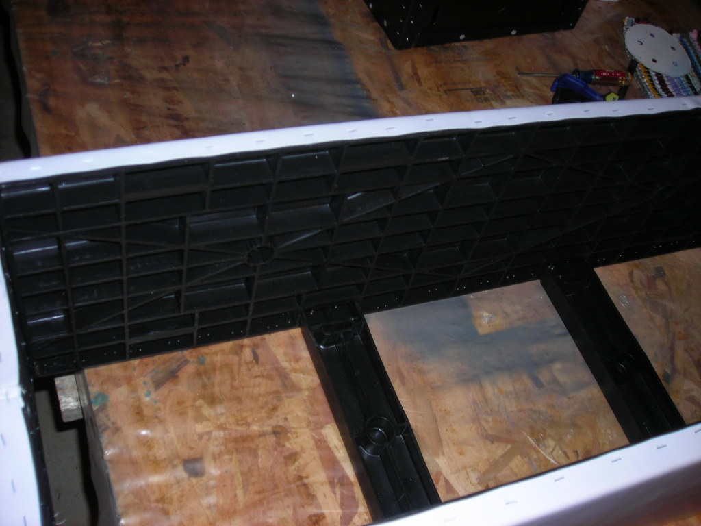

These base sections are made from injection-molded plastic. One the inside, there are molded receptacles into which the crosspieces fit.
If I trim the bottom edge of the base, I would have to devise a way to attach the crosspieces (which, in turn, screw to the floor) This is doable and might be a better idea than building plywood bases and carpeting them. I could just toss the plastic cross pieces and put four Aluminum angles in and screw them to the bases and to the floor. That might be easiest.

these bases were the same way,aluminum would be good,i used wood but sealed and painted it,this boat sees very little rain,its garage kept.
