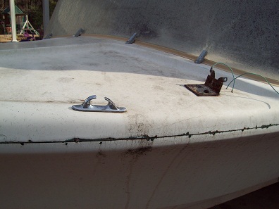

I'm starting to tear down my Invader and i'm wondering if it's ok to just use a sawsall to separate the deck from the hull I've seen on this sight plenty of chiseling and prying and the sort. Just seems logical to me but This is my first glass project.
Re:Taking the deck off. 15 years 5 months ago #26930
if your going to go that route i would suggest a small air body saw,its like a small sawzall,but i have found be careful the little bugger can get out of control because at least mine is hard to see where your sawing,and its very fast,john
Re:Taking the deck off. 15 years 5 months ago #26932
wait,im on dial up and didnt see your pic,it looks like a shoebox joint,i wouldnt use the saw,there is probably a lip that goes up inside your seam,you will cut that off .but i cant tell for sure from the pic.john

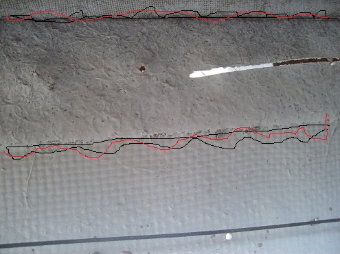

From what I can tell it seems like a 2in strip of tape that joins the 2. I drilled out all the rivets and not sure what the their purpose was, but it seems to me that cutting it and then re-doing the glass strip when installing would be easier??? Hell if I know,trying to keep it simple..
Re:Taking the deck off. 15 years 5 months ago #26968
sorry for the late reply,but skipp did it for me,if its not a shoe box,then i would cut as much of it as i could into just the 2 inch strip on the inside,you can try a razor knife,or rotary tool with a cutoff wheel,if you have one of those multitools you might want to buy one ,it would work too,and then you can also use it for sanding too,and they are great at that.
can you post pics of the inside where it joins together,because if it had rivits that didnt seem to be doing anything,then it might indeed be a shoe box joint and the tape was just to keep out water.
here is what i THINK you have,i could be wrong,john
for some reason im having trouble posting my drawing,ill look fot the post i saw not too long ago with the drawings of boat joints,john
Re:Taking the deck off. 15 years 5 months ago #26972
here is what i was looking for it was poted by jamil
If there is a rub rail, remove the insert to get access to the fasteners. If riveted, drill them out. If screwed or bolted together, remove them mechanically.
The joint on most boats will be either a shoebox construction or a sandwich joint
If the inside of the seam is glassed over, it is most likely a singly ply of cloth "tape". It will probably peel right off if you can get it started.
In the event the hull and deck are bonded together at the seam with polyurethane goo, a heat gun and a stiff putty knife can break the seal effectively (but tediously)
If you attach a close up of the joint, it'll be helpful.

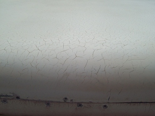

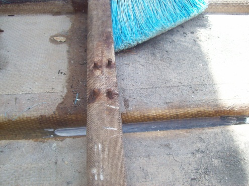

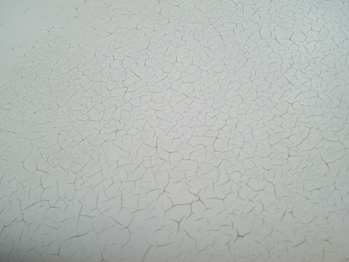

OK I have some pics. The first 1 is what looks like old house nails where the floor was put down. The next 1 with the lines drawn are of the inside. I'm thinking it might be easier to keep it together. The last couple are of the chicken feet all over the deck after hitting it with 60g paper. How should I tackle that problem??? :unsure: PS Want to know how to take those nai lookin' things out.
Re:Taking the deck off. 15 years 5 months ago #27003
as for the nails if that stringer is still solid,lay down a scrap piece of thin plywood,or something like that and use a cats paw to pull them out,keep the plywood under the catspaw,to keep from damaging the stringer,and for extra pry.
then fiberglass the holes.
or you can cut them off with a cutoff wheel then fiberglass,but the nails will still rust.
as for the seam,i would try jamils meathod and lightly hit it with a heatgun,and try prying up under the bottom of the tape line with a putty knife.
and for the crazing,as long as its not stress cracks,some will say grind it off its pretty bad,but you can try sanding,then blowing out the crazing with a blowgun on your compressor,then use filler primer,sand,primer,sand,primer,sand,useing higher grit,(220,320,then 2000 grit),between coats,make sure to use the blow gun after every sanding
so that the primer goes down in the cracks.then finish with the primer you are going to use before paint.
there are other ways and i hope some more folks chime in on this,some of the bigger cracks are going to hve to be ground out to a v.john,p.s. i dont recomend spot putty it shrinks over time ,but thats jusy my opinion.

The "chicken feet" is crazing. Older Gel-Coat gets hard and brittle. When the fiberglass expands and contracts with temperature, the Gel no-longer does. The only cure is to completely remove the old Gel-Coat. If you don't it will just keep crazing.

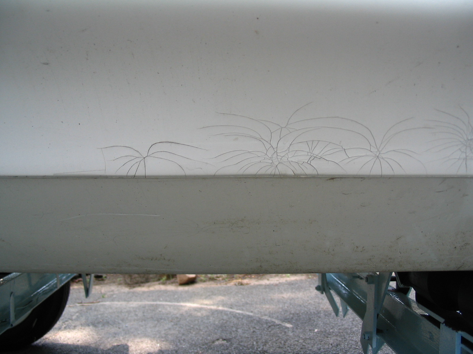

jerry, i wish i would have known that before i bought my mantaray. i would of never paid the price i did.
this area hasn't reappeared YET.
Re:Taking the deck off. 15 years 5 months ago #27076
Ron,
The area in your photo isn't crazing, it's impact damage. When cracks have an epicenter from which they radiate away, that's evidence of a point of contact.
Crazing is the effect of UV damage braking down the binders in the gelcoat's resin. Like Jerry mentioned, the result is a brittle and unstable surface. As the boat flexes, either underway or by thermal expansion, the gelcoat loses its ability to move with the substrate and the result is evenly dispersed cracks across the damaged area (Usually where exposure to the sun is greatest).
The impact damage in your photo may eventually come back if the cracks were not ground out and filled properly, but even if they do, any future repair will still be confined to those small areas and aren't indicative of a larger problem.
So I guess that's good news.

Ron's stress cracks are on a lot of boats, and an easy spot repair, but crazing you can't stop by covering it over. It keeps cracking and sooner or later it will show up. I stripped my Glastron FireFlite down to the glass everywhere, except a small area right around the bung hole, because I got lazy and didn't want to replace the bung. well I have cracks there now. It's a lot of work removing all the old gel. I sanded mine. I know guys that had theirs soda-blasted which was easy (just wright the check.) but like my daddy always said, "A job worth doing, is worth doing right"
