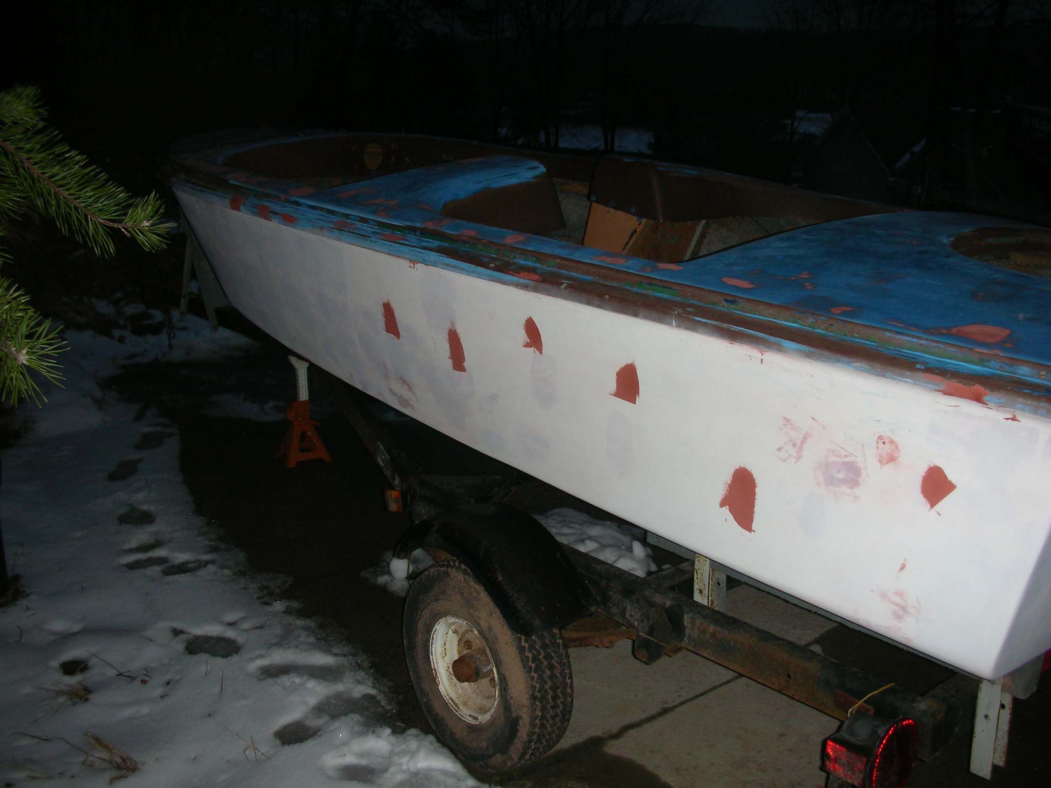

Re:starcraft did you et the steering wheels yet? 15 years 2 months ago #26163
got some bondo on and sanded almost perfect

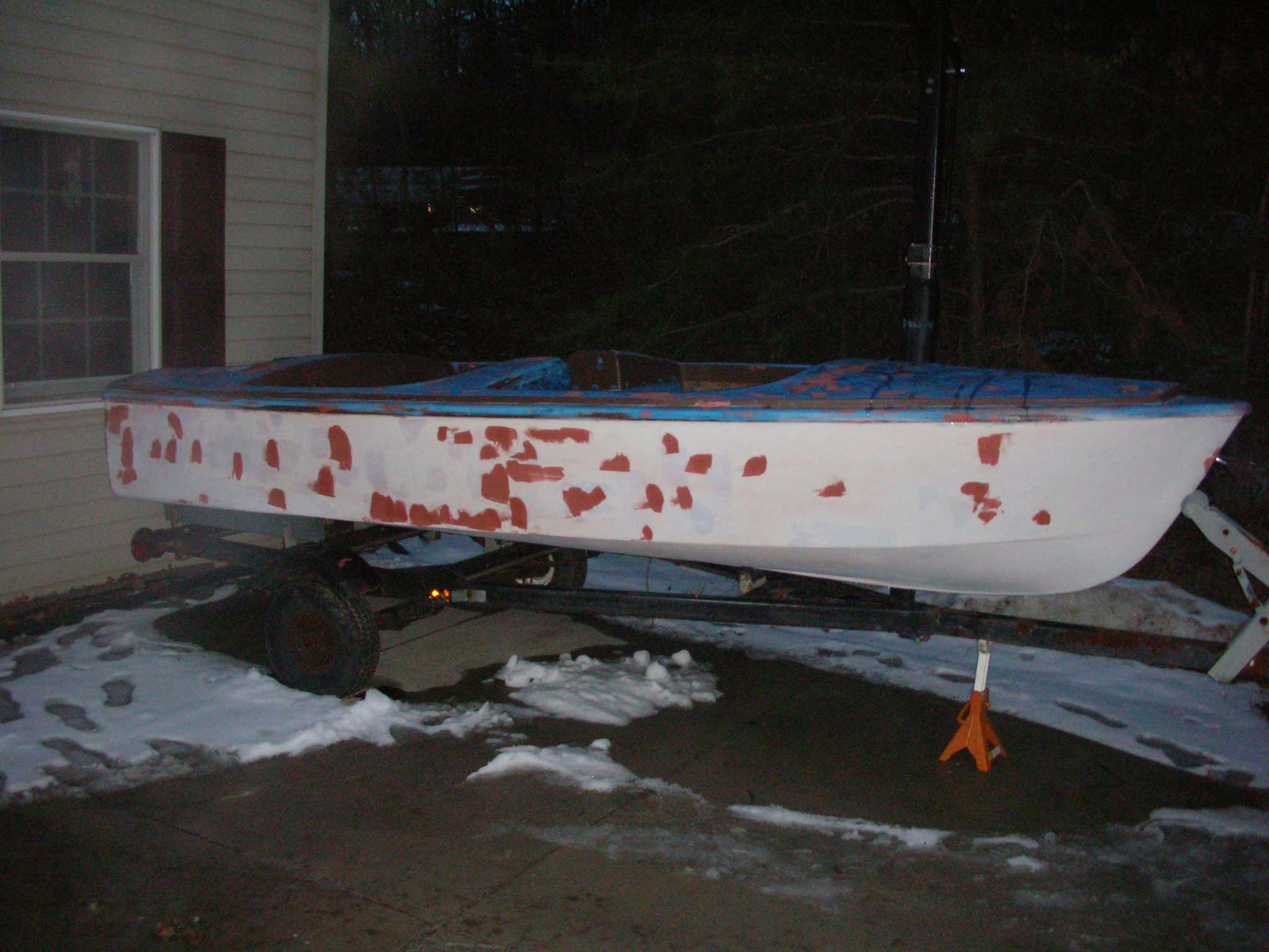

Re:starcraft did you et the steering wheels yet? 15 years 2 months ago #26165
more pics

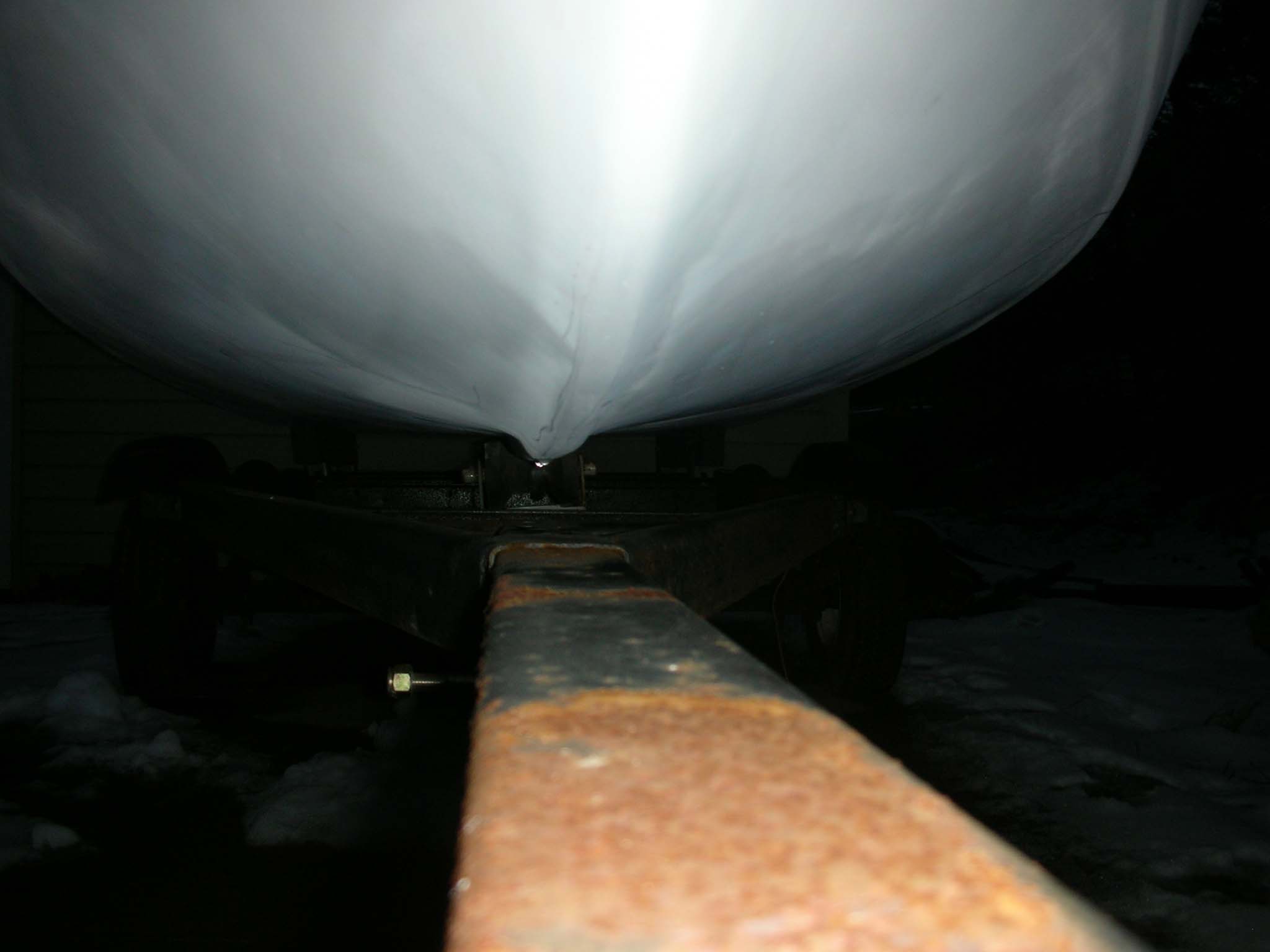

Re:starcraft did you et the steering wheels yet? 15 years 2 months ago #26166
bottom front to back

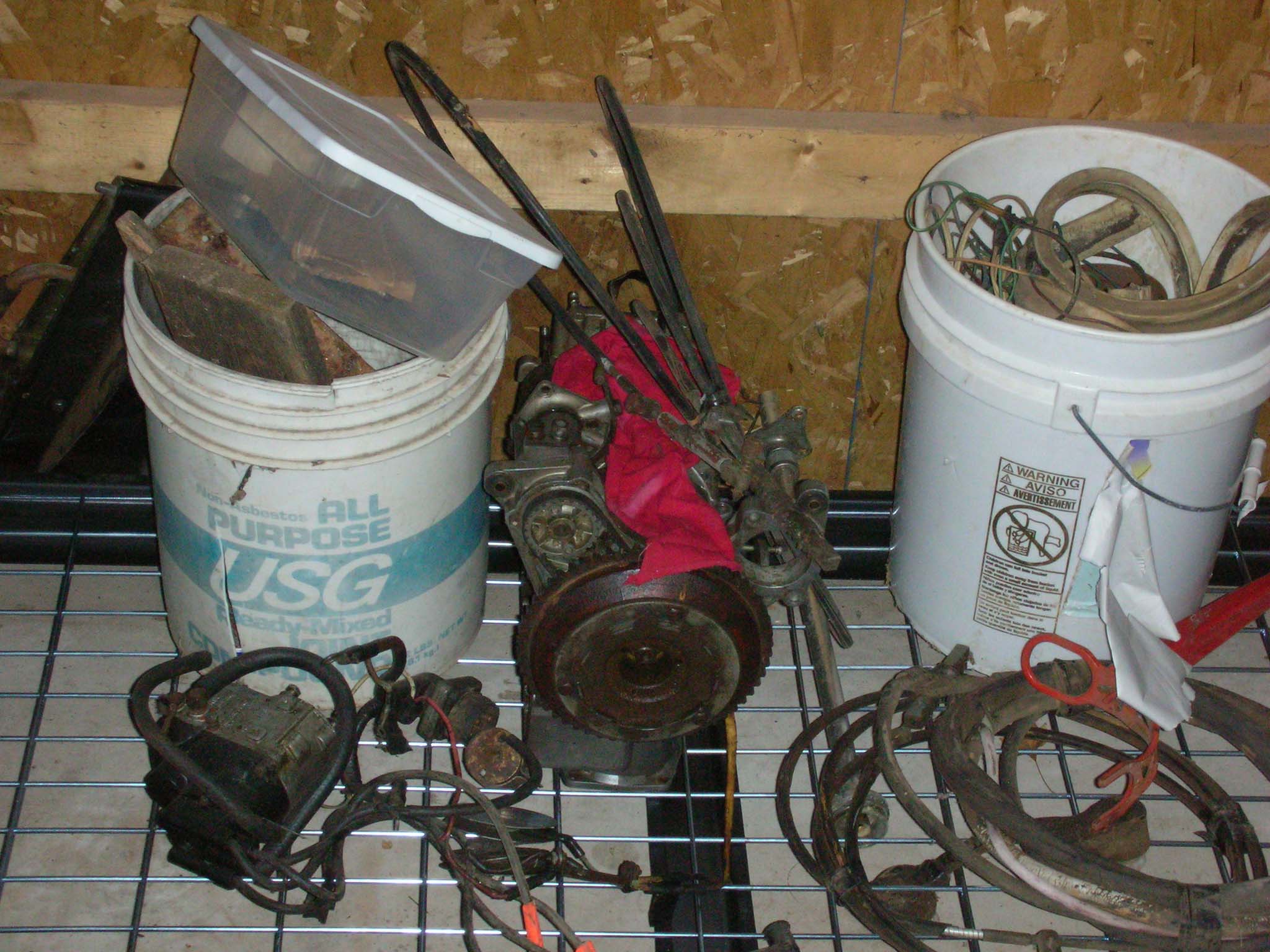

Re:starcraft did you et the steering wheels yet? 15 years 2 months ago #26174
noo i took a pic of it apart heres just the block which is stuck :/ bummer but i have all the pieces in a tub and gonna work on it when thee weather gets nicer and try to free it up

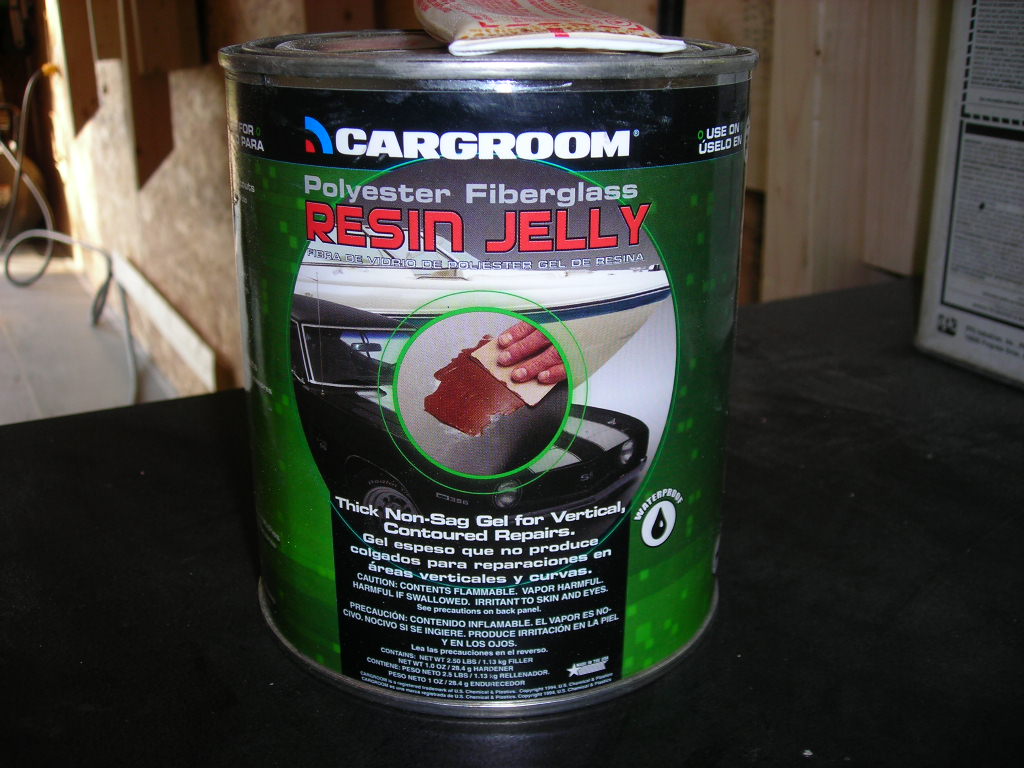

eric thats going to make you a nice boat,but is that automotive spot putty?it goes on nice but after time it tends to shrink,if you can get this fiberglass resin gel,it works great and sands very nicely,plus it should be a bit warmer when you do it,just trying to help,this gel is cheap about 11 bucks a quart,im sure you will like it better and its made for boats,but from what i see your a real go getter,if you need us we are here for you,john
Re:starcraft did you et the steering wheels yet? 15 years 2 months ago #26187
its just regular bondo and its been in the cold for a couple months so i think shrinking would be finish if thats what you mean by that
Re:starcraft did you et the steering wheels yet? 15 years 2 months ago #26194
  • john-gibson
  • Posts: 4014
  • Karma: 324
believe my eric ,you sould get the fiberglass resin,and read what the temp should be to put it on,tthe same goes for the bondo your using,probably 60 to 75 degrees,john
Re:starcraft did you et the steering wheels yet? 15 years 2 months ago #26196
i got this boat in the fall and thats when i did all this its been sitting since the temps got to cold
Re:starcraft did you et the steering wheels yet? 15 years 2 months ago #26199
  • john-gibson
  • Posts: 4014
  • Karma: 324
good then eric,then all you will have to do is fair out the edges of the putty,good luck buddy,john,by the way were you satisfied with your wheels?john
