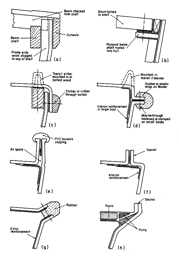

If there is a rub rail, remove the insert to get access to the fasteners. If riveted, drill them out. If screwed or bolted together, remove them mechanically.
The joint on most boats will be either a shoebox construction or a sandwich joint
If the inside of the seam is glassed over, it is most likely a singly ply of cloth "tape". It will probably peel right off if you can get it started.
In the event the hull and deck are bonded together at the seam with polyurethane goo, a heat gun and a stiff putty knife can break the seal effectively (but tediously)
If you attach a close up of the joint, it'll be helpful.

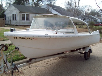

To make it easier to work on. I can get in the bow and flip it to do bottom.
Re:Seperating deck from hull??? 15 years 5 months ago #25889
it looks like a shoe box in the pic,but im not sure,if it had been the sanwich style,you could use an air powered body saw,its basicly a small recipricating saw,but watch it doesnt get away from you,john
