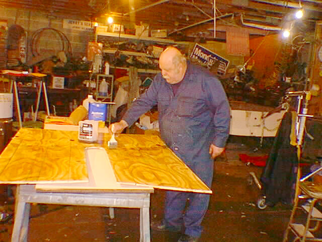

I see you're a big fan of Marine Plywood. CDX and Marine use the same glue, and both woods rot if they get wet. I use CDX and give it a couple coats of resin and Acetone 50/50. This does 2 things 1- it makes the outer layer water resistant, and 2- it adds tremendous strength to the plywood which becomes almost like a fiberglass. Any voids (which really don't affect strength enough to matter) I bondo over before covering with fiberglass. I know if you ever try it you will never buy Marine plywood again.
