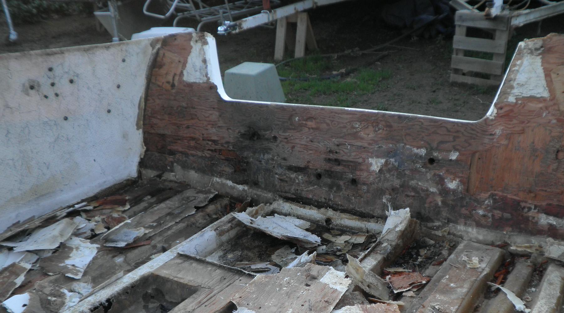

Here it is. Finishing touches tomorrow morning. Good night.

Great pictutorial Jamil, thanks for sharing. (New word, I just made it up. LOL) Gotta tackle that task soon on the CCSR. I've been researching the subject, and have a sincere question. Some folks mention sealing the plywood with penetrating epoxy, (thinned regular epoxy, am I right?). I understand the layers of glass applied both "faces" would probably accomplish the same thing, but what about the edges? Could/should a person seal them before installing the core? Just asking because I want to get it right. :)
Re:Transom Replacement 14 years 4 months ago #25868
Mark,
You're right on both counts. It is good practice when dealing with any organic core material to seal it with penetrating epoxy which leaches into the wood.
The most problematic portion of any plywood is the end grain. It acts as straws wicking moisture directly into the plies.
In the pictorial, in the photo of the fillet around the perimeter. I used thickened epoxy and a big syringe to fill the gaps between the hull and the transom blank, then ran the fillet to hide the seam. Because the gap was as much as 1/4" (and in some points, even bigger) the thickened epoxy has done a very effective job of sealing the end grain everywhere but at the top, which gets glassed and faired.
The reason you didn't see any of that in the pictutorial (to use your word) is because I didn't want to advertise that my cut was off by 1/4".
I'd like to personally thank you for the shame you have brought upon me and my family by addressing this issue in public and calling attention to my failure as both a professional and a human being
(I'm just giving you a hard time. You are absolutely right about sealing the end grain and it is good best-practice to do so. I'm confident that the repair was made effectively and the subsequent use of thickened epoxy in its place has not compromised the longevity of the repair, but it was definitely not the preferred way of doing it.)
I'd hoped no one would notice my transgression, but it seems you've paid close attention. Good eye, you were right. Now please knock it off :)

Great post, Only thing I dont understand is the five layers of glass to hold the transom in, thought the last layer should be cloth not matt? Does it matter as long as you start with matt... B..

Cloth is porous and allows water penetration. Mat is a better defense against water. Always start any lamination with mat. Never finish any lamination with cloth.
It took a little more than half a gallon of resin and half a quart of catalyst for the transom, tabbing, and stringer repair. But resin was also used to mix up fairing compound, fillets, and structural filler.
