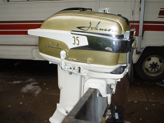

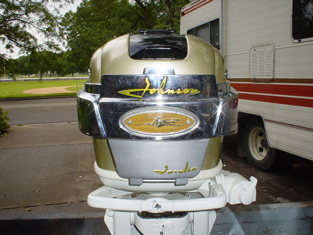

To hang all the motors off of. This is one I have wanted for a LONG time now. Yes, I DO Have the rest of it, it's still in the car, though, it was too dark to attempt unloading it tonight... It appears to be in pretty good shape, mostly intact. She's going to need a GOOD cleaning, though!
The Golden Javelin has always been a favorite of mine- I've been looking for one, but when they come up they are often VERY expensive, and/or they sell really fast... This one was 'lurking' in the Chicagoland area, in a garage. Hasn't seen the water (or the light of day!) for a few years- Perhaps decades.
The ONLY part that is missing from the cowl is the recoil cover- and, if I can't find an old one, I just found out that reproductions are available.

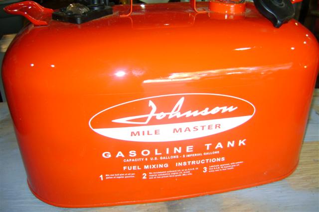

The covers are available, but I can't tell you who from. Looks like all the script is in tact too. Great find!! I always convert them to single gas line with a fuel pump. That old pressure tank is a pain in the butt, and dangerous. If you need any parts let me know.

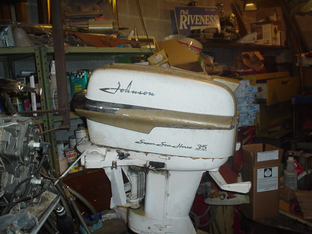

Congrats on the Golden! I got my '58 Super Seahorse on the bench tonight... good motors it seems.

The Super quiet already had it. You have to do some drilling and tapping and get a newer style pump, and a new tank. It's not hard to do. I can send some pictures, or talk you through it. If you have video calling, my Skype is jerry.gilkeson, my Yahoo IM is fiftiesflash, or if all else fails I'll send you my phone number (so 20th Century). I like your 54 Bel-air

That conversion is one of the first things I want to do. I'm not a fan of pressurized fuel tanks- Even though I run a gasoline tanker :)

Here's a link to how to do the conversion. Pretty easy to do.
www.sschapterpsa.com/ramblings/Converting_dual_fuel_line.htm

Rope covers
Email Sandy at this address.(This email address is being protected from spambots. You need JavaScript enabled to view it.) He recasts the aluminum covers. You will have to paint it yourself. Black for 1957 Javelins RJE-19 and White for 1956 Javelins RJE-18.
Sandy Lupo (This email address is being protected from spambots. You need JavaScript enabled to view it.) is a source for cast new aluminum recoil covers
About mid page to the left under Restoration/Cosmetic....thengo again to the middle of the page
www.javelin1957.com/

Frank Robb on AOMCI "Ask A Member" makes and sells a dandy conversion kit for changing to fuel pump...looks factory
In 57 and 58 one could order a motor with a fuel pump in place a twin hose system ...an upgrade
CAVU
Re:I think I need to buy more boats.... 15 years 5 months ago #25442
The link to the 18 HP change is totally different for the 35. If you can get a kit that might be best, although the pump is off any 59 or newer OMC you need the right hose connector, That's the hard part to come by.
