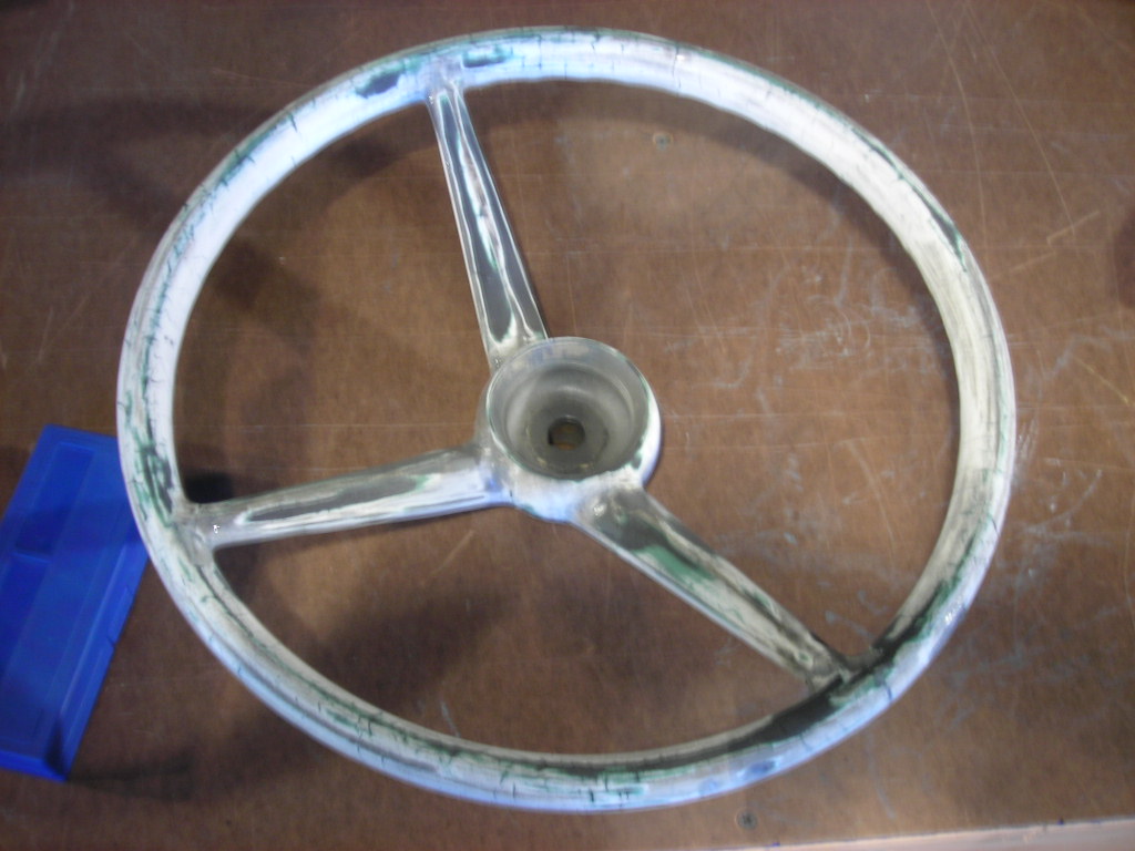

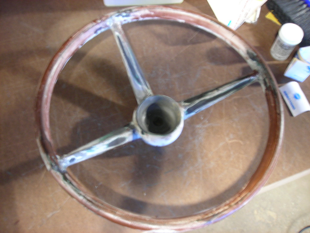

eric it should be done by tonight or in the morning,here it is with resin jelly(brown) to fill the small cracks,then more hand sanding then more filling and sanding,then primer and paint,john

Looking good, John. Soon it'll be as good as new- Or better!

John, On steering wheels I have used rubber bumper bondo. It flexes a little specially where cracked. Resin gets really hard, and doesn't flex. Just a thought.
Re:starcraft 15 your steering wheel . 15 years 5 months ago #25400
i used jb weld on mine. didn't take long to crack again. if i can get it off, its off to "Gibson Custom Boat Restoration"

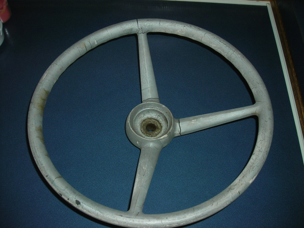

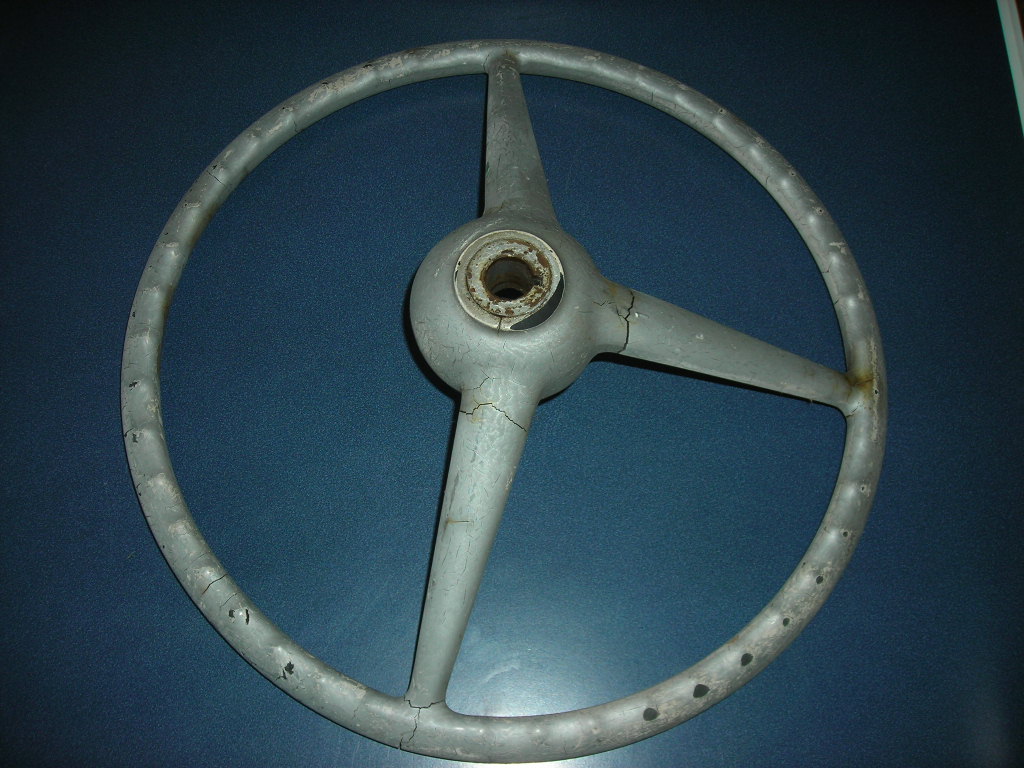

yeah jerry,thank you,this wheel is one of the worst ive ever seen,i had to fill some really big cracks with epoxy for rubber and put in some homemade pins,the resin is just for the very smallest of them,i already told starcraft it might crack again,it looked good in the pics ,but its bad,i told him its free and if it cracks ill give him another wheel,it might not be original,but it will be in good shape.the jelly resin pic is a before pic.not much left after sanding.

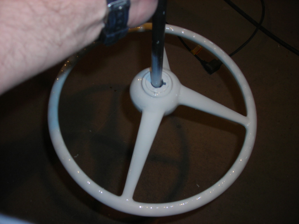

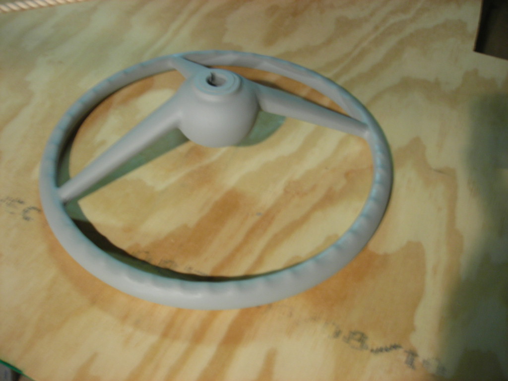

starcraft thanks for your patience ,i have the wheel in primer now,and im going to stay up all night to get them painted,i worked on them from 8 am,plus while the filler was drying i did my moms fiances mirror for his avalance,i had to paint it white too,im going to download some pics of your wheel,before and after,it will take me awhile im on dialup,ill let you know when the last pic is up,john darn it my pics seem blurred. im trying to get it to look like this,and your welcome,its my pleasure,its nice to see young folks get into the old boats,it might keep you out of trouble,lol,john ok im done posting pics untill tommorrow.
Re:starcraft 15 your steering wheel . 15 years 5 months ago #25513
That looks great i can not thank you enough for this cant wait to see it done :)

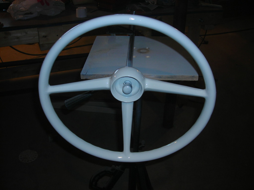

eric i spent most of the night priming ,filling the tiniest holes and cracks,then doing it again,im trying to get it as perfect as i can,i did get 2 1/2 hours of sleep,lol.it looks like there is no difference in the pics ,but there is,i put a little more resin on the pin holes and tiny cracks,now ill go down and sand it again then ,paint it white,wait a couple of hours then add the blue,im hoping to send it on monday,im going into town then .john,darn im having picture issues,i reset the camera to auto,and they are to big,ill go to the basement and redo them.john

lol,nope,i spent most of the time sanding,filling and waiting for the resin and primer to dry,lol,if you click on the pics at the top of the page and the before pics you can see just how bad it was,lol,im hoping that after i sand it this time ,im ready for paint,i sure hope so,lol,well the resin should be dry by now,time to go sand some more,lol,lol,john

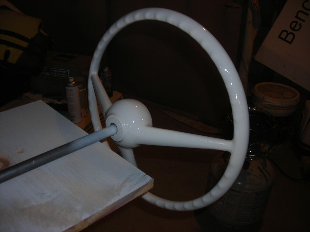

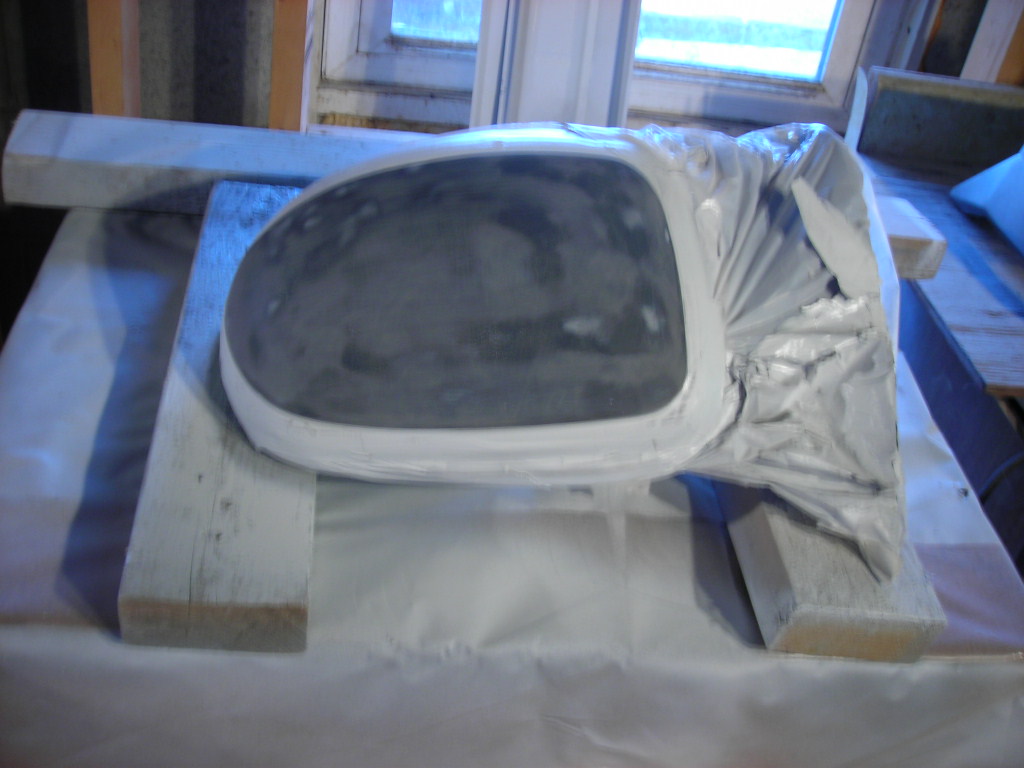

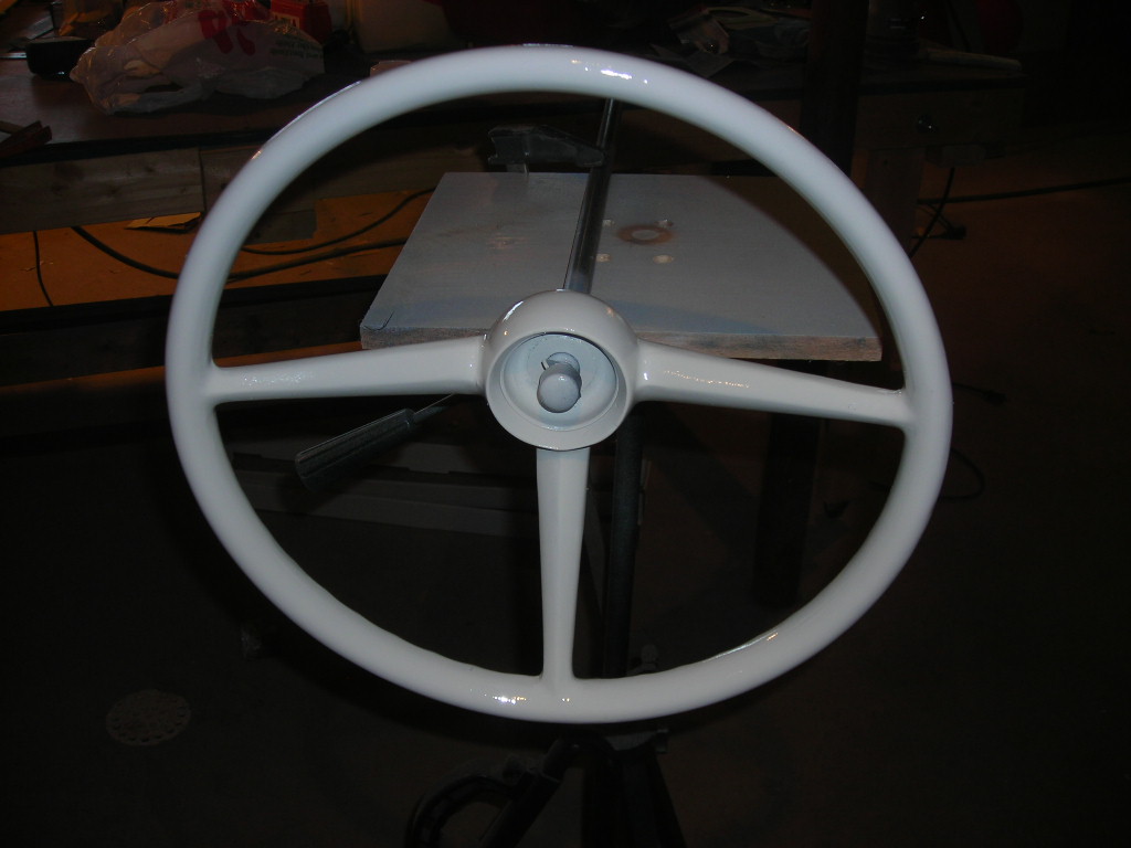

here is pics of it with the wheel not finished sanding and pics of the 1st of 3 coats of white,then in the morning ill paint the blue,on the spokes after the wheel has dried well,john,darn it the pics came out blue,ill be right back,i hate this old camera!going to try again,be right back,john

ok i finshed with the white paint,im going to let it dry over night,then comes a little bit of blue,there are 4 pics eric,john
Re:starcraft 15 your steering wheel . 15 years 5 months ago #25583
Looks good

thank you,one of the hardest parts is filling and sanding each one of those finger grips(knurls)by hand ,it was just alot of hand sanding ,from 220 grit all the way down to 1000,now its time for a little sleep,lol,john

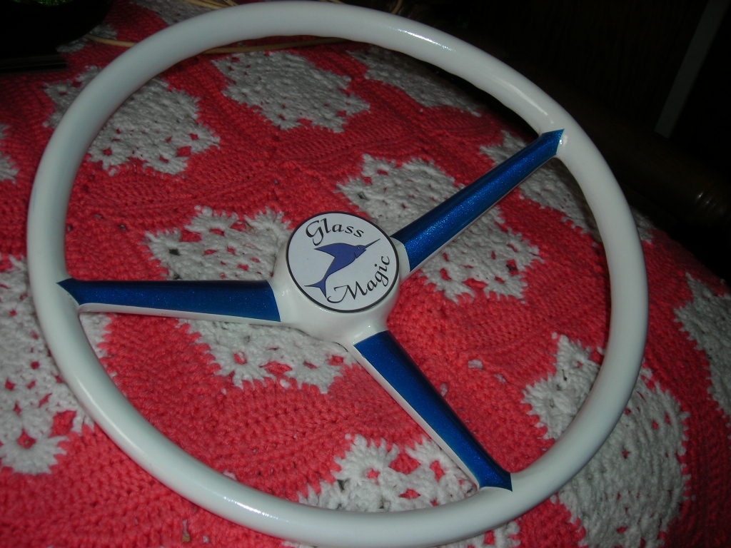

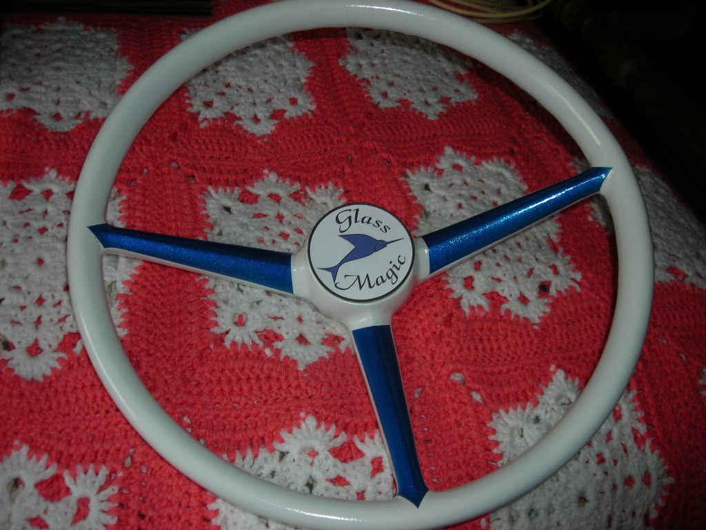

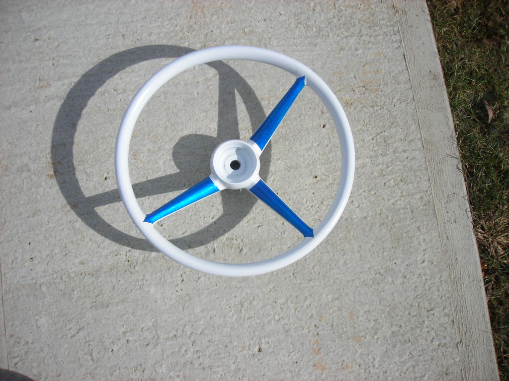

eric i finished your wheel,heres a few pics with the blue ,and 2 with a paper cutout of andrews center cap design.it will take me a little while to upload the pics on dial up,ill let you know when im done,john ,ok im done with pics,and i know you want it sent ,but im going to keep it an extra day ,just to make sure all the paint is hard and dry,i dont want the wraping for shipping to stick to it,thanks john
Re:starcraft 15 your steering wheel is finished!! 15 years 5 months ago #25673
That looks great i cant believe thats my wheel that i sent u it is awesome looking

Great job, John!
Makes a great frame for that center cap :)

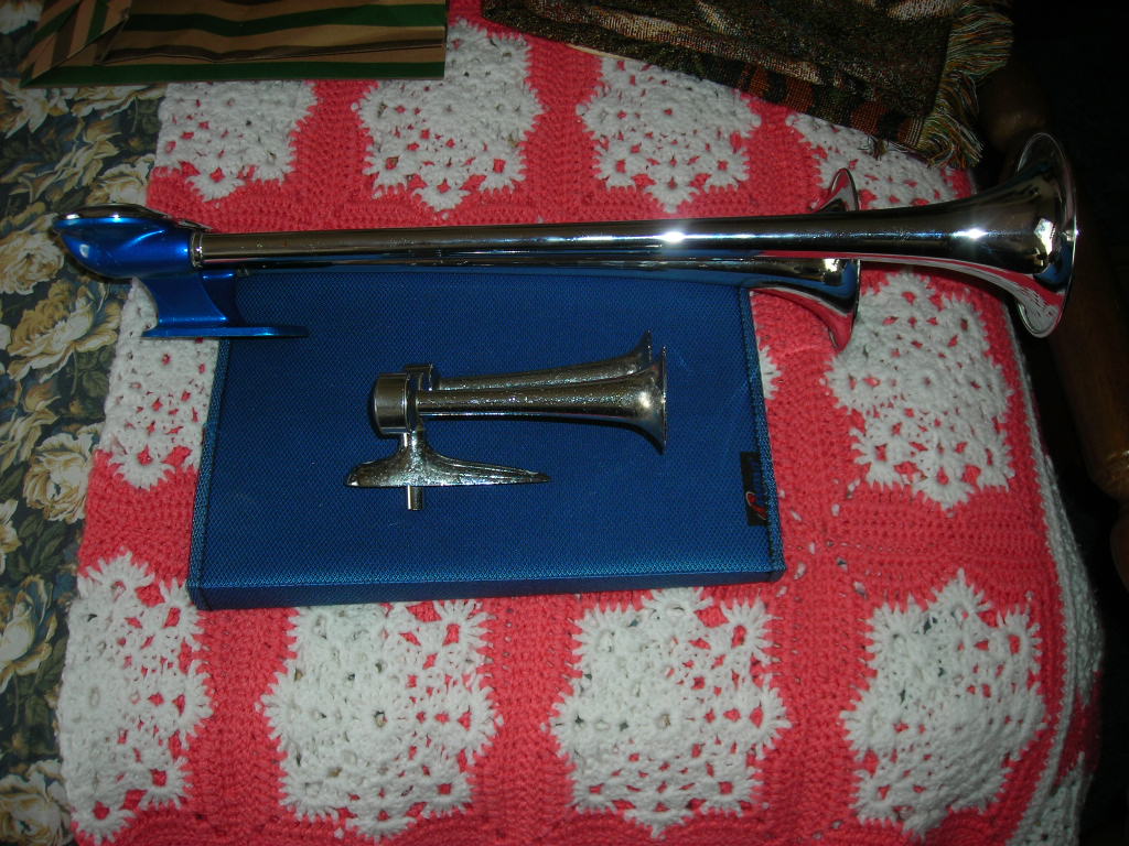

Man that is the WORST looking wheel I have ever seen, It looks like a Sleep depraved Old Man with a thawed out can of left over Rustoleum worked on it in a dimly lit dusty garage!!!! Uh Oh looks like the Don Rickles in me is coming out!!!!! :ohmy:
Seriously John, All I can say is WOW!!! Not sure how you continually keep hitting home runs but you ARE the BABE RUTH of Steering Wheel Restoration.
Keep on "Payin it Forward" ;)
Re:starcraft 15 your steering wheel is finished!! 15 years 5 months ago #25814
  • john-gibson
  • Posts: 4014
  • Karma: 324
roflmao,that was funny,but true,lol.

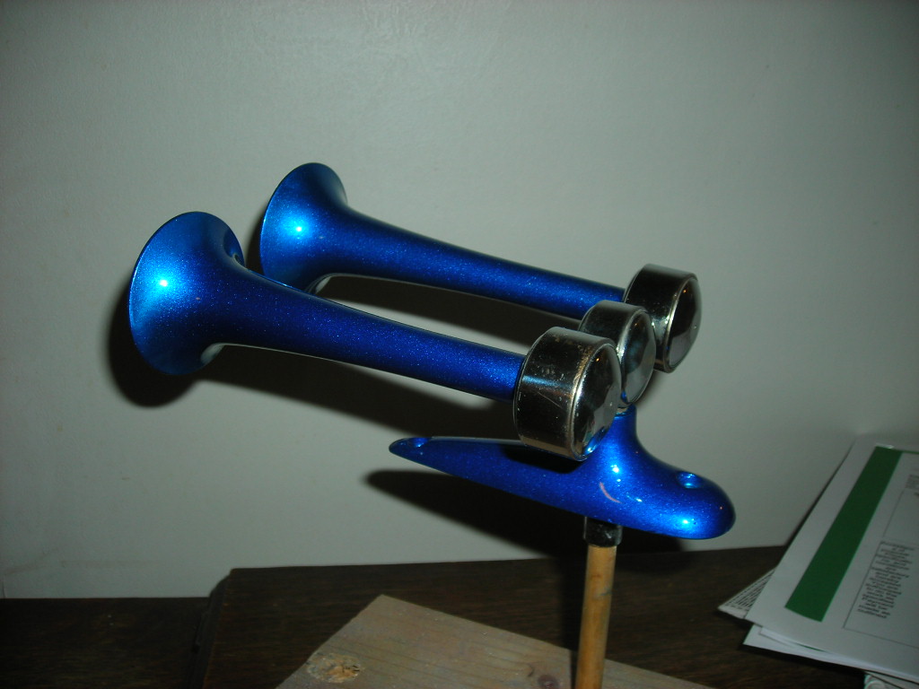

thanks mike,your going to be alittle disapointd but the horns i was going to send you,the guy from ebay said they worked great,so i didnt test them,and i made a rookie move and i didnt test them till today,they arent working.
foolish me,i trusted the guy,so after all that work,ill see if i can get them to work,if they dont you can still have them but im sending back the shipping money you sent,or you can have my prize horns also free plus ill pay the shipping,they are huge but they would look good on your flamingo,im so sorry my friend,its your choice,john p.s,,heres pics of both,i guess i only hit a single on the little ones,lol

Here's the deal. YOU, out of the generosity of your HEART, and the LABOR of your hands, offered these horns FOR FREE!!! I was LUCKY enough to have GUESSED a random number to win them. Nothing ventured Nothing gained. I WILL NOT accept ANYTHING. It is my DESIRE that you take that money and use it to SHIP something in the future to a needy person that I KNOW you will "PAY FORWARD" with your KIND AND GENEROUS HEART! You are "ONE OF A KIND", and I am honored to be associated with someone like you. As I have said before and will continue to say....
Keep on "PAYIN IT PORWARD!!!!"

flamingo,that was a very heartfelt message,and i felt it,thank you for such kind words.are you sure because you can have the big horns and the small ones free of charge ,i feel bad that i was that dumb,and i still feel i owe you something,and dont worry i will continue to pay it forward,to anyone that needs me,or some help,john.
p..mike you are one of the folks that makes this site great.
Re:starcraft 15 your steering wheel is finished!! 15 years 5 months ago #25945
Ok, The Next time You have NOTHING to do and Curiosity gets the best of you, Tear those horns apart and see IF you can make em work. IF and ONLY if you can Make em work WITHOUT spending ONE SINGLE DIME on them, then send em to me. IF not, use em as a Paper Weight. Use the money to help someone else. GOD has blessed me beyond measure with a job that pays me much more than I am worth, so I am MORE than happy to share this little bit with others. I KNOW you will use it where it NEEDS to be used. Don't worry ONE MORE MINUTE about this. I have a working electric horn that came Original to the boat and will use it. Now, if you ever run on to an Original Steering wheel for a 1961 Lonestar Flamingo, THEN we can talk!!!!!!!! :ohmy:

like i said your wheel was one of the worst i have seen,and i got it to look better,and i did my best,but in this case you just never know if it will crack again.
