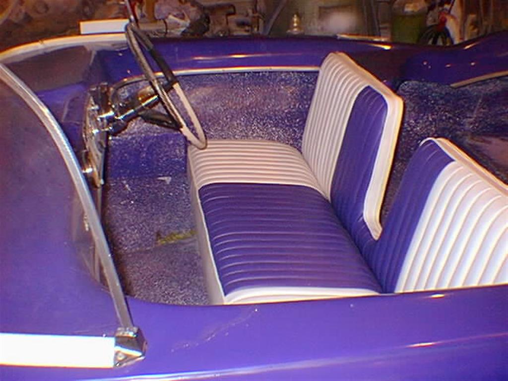

Re:Making Boat Seat Cushions 15 years 5 months ago #26407
Here are before and after pics of the interior of my Arabian. This was done with a 1970's Singer by a true amature. With a little time and extra fabric it turned out pretty good. It is off white with dark green piping. One trick that I found, if you are having trouble keeping your seams together you can staple them with a regular paper stapler along the outside edge and then remove the staples after you stitch it. I was having trouble keeping all of the pieces together as I stitched and this really made it easier. If I can do this anyone can.
Scott
