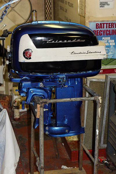

The '57 is repainted and MOSTLY put back together-
I like how the darker blue turned out.
I didn't bother putting the lower unit back on yet, since I need to replace the impeller, and won't be doing that 'till I get back home.
Why is it that I always have a couple of extra parts every time I put something back together??

I am usually someone who likes to keep things original, or as close as possible, But in this case, I liked the color of the LATER Evinrudes better... They switched to a darker blue, more like this one. They changed the cowl design a bit, too, in 1958.
The other 'issue' is money- The 'exact' factory matched paint from NY marine runs $20 something a can, plus shipping. Figure 2 cans, plus primer, and you're going to double the cost of the motor in paint alone. Now, I can justify that if it's going on some motors, and for some purposes, but for my 'needs' this motor will be just fine. It doesn't even have a boat to go on at the moment, since I found the Lark!
This motor was also an experiment- I've painted motors before, but not QUITE how I did this one. You can call this one a 'hardware store job', as there are NO specialty marine products used. The method I used was recommended by a friend who's painted LOTS of motors this way, and they all look great- So we'll see. If anyone is interested, I can share the tips and finer points, but it's really nothing too special. It looks good now, we'll see how it stands up long-term.

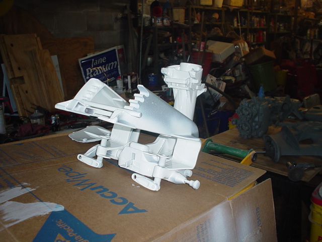

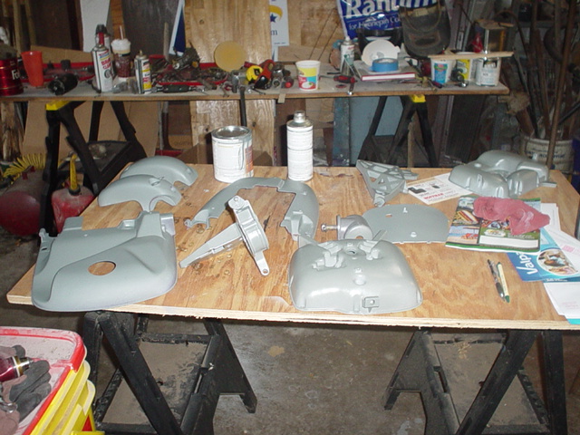

50s Flash wrote:
Let me guess, you didn't take it all apart and paint each part separately.
No, I took MOST of it apart... There really isn't much of a way around that, if you want a good looking paint job. As you know, it is very time consuming, but with all the angles, curves, and hard to reach places there is simply no way around it!
A previous owner had repainted parts of this motor, part of it was a copper color, part of it was a brushed-on enamel that was kind of close to the color of the original motor, with no metallic, though. So, I took most of it down to bare metal. A wire wheel on a grinder does wonders!
I used a dremel and hand sanding to get into all the nooks and crannies, and got it as clean as possible.
Then I primed it. I see a lot of discussions and debates out there about the 'right' way to prime- everyone seems to have an opinion. Since it's aluminum, You need a primer that is designed to coat bare aluminum. Lots of people seem to like Zinc Chromate- and there are also primers made and marketed for outboards/outdrives. There are also a few primers at the local home store that will work just fine- Sometimes the fact that something doesn't say MARINE on it only means it's going to cost you less, not that you can't use it on a boat!
At the advice of someone who's used it MANY, MANY times before, I used Rustoleum Bare aluminum primer. It comes in spray cans, goes on well, and leaves a nice white surface. I admit, I was a little worried about using rustoleum, but I've seen his motors- and they look FINE after a few years, so I gave it a shot. It is a lot less expensive than a 'marine' primer, and perhaps more importantly, it's more readily available.
One thing to pay attention to when you choose a primer is the recoat time- This is the time between when you first prime until you have to get your top coat on. Rustoleum is immediately to one hour. After that, you've got to wait 48 hours. It's in your best interest to get everything primed, then move right on to paint... The paint will stick to the primer best within the recoat time- It'll be an actual chemical bond between the paint and primer.
The paint on this one is a rustoleum as well... Their cobalt blue metallic is very close to the actual evinrude color... So close that you'd be hard-pressed to tell if they weren't side by side. I was worried about longevity, but again referred to someone who had used it before, and was VERY happy with the results over time. We'll see how it goes!
If you keep the limitations in mind, its amazing what you can do with rustoleum... There are a lot of people on the I-Boats forum that paint the entire boat with it. Do a google search for it, and you'll find a number of cars that have been painted with it- with amazing results. No, it's not on the same level as a multipart sprayed on finish, but then again it's a lot less expensive, and also within reach of anyone, since it doesn't require a lot of specialty equipment.

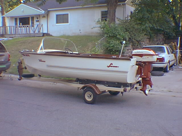

That interior is a long story. First coat was a 2 part poly base, then 17 cans of Accents, then a clear-coat with a nulling agent, so it wouldn't have a gloss, and not remove the specks when you walked on it. Total cost was over $500. The Gel-Coat for the outside was about $120. What's wrong with that picture?
Re:Project of the week.... 15 years 7 months ago #25973
longshaft on a shortshaft transom?
