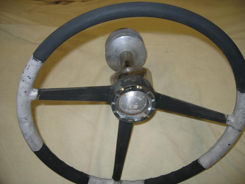

I would like to restore the steering wheel shown in the attached photo. Is it possible to remove the wheel from the shaft?
What are the colors of the center cap? The cap I have is faded.
I am also interested in any information about the boat it is attached to. It is registered as a 58. The nameplate says was built by the Lund Metalcraft Co., New York Mills, MN. The length of this runabout is 14'6".
Thank you in advance for any help.
Randy

There should be a nut holding the wheel onto the shaft under the cap Randy. (How the cap comes off, I haven't a clue, that's one I haven't seen before.) If you would post some pics of the Lund, I'm sure one of the knowledgeable folks here would be glad to help you identify it. (When I hear Lund, I think of aluminum fishing boats.) We'd love to see it.

I have the exact same wheel. Mine came off a 1958 Glen L Swish that has gone to greener pastures, so the year is about right. The center cap pops off and there is a nut underneath. Only the center cap comes off, the outer ring is held on by the nut. The shaft is tapered and is there is also a pin on the shaft behind the wheel that needs to be removed. That is a bit of a project.
I was planning on restoring the wheel and using it on my Tomahawk (until I found a gold fleck, similar to my Custom Craft. What I thought would look cool would be to install chrome rings between the colors. I have 4 NOS Impala wheel rings, but need 2 more to finish the wheel.
What is interesting is that this wheel has 3 areas of contrasting colors instead of 2, which is more common. Post a pic when you get it done.

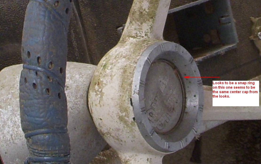

This is the wheel on the Aristo Craft, Dont have it home yet to look closer but seems to be the same one and theirs Definately a Snap ring.
