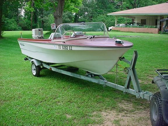

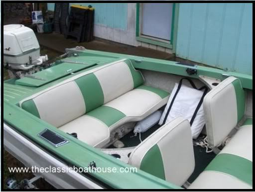

Great boat! Welcome to Fiberglassics. Here's my Flamingo.

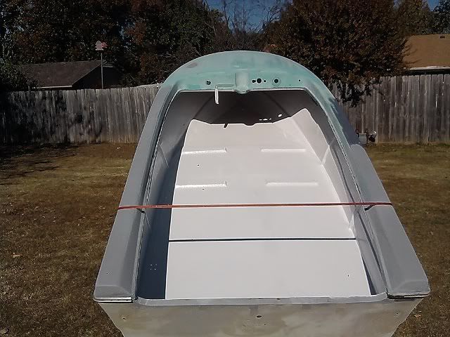

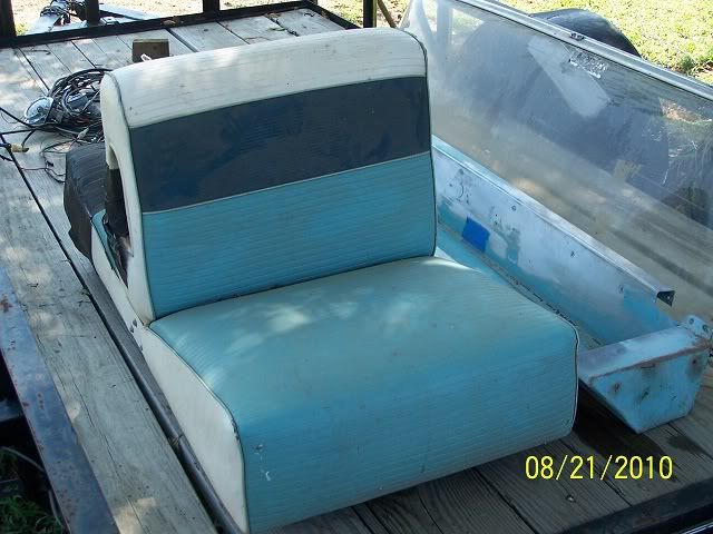

Here she is all stripped down.
Not bad for a 50 Year old Transom
She Came with Back to Back seats but I'm gunna build some bench seats cuz these are SHOT.

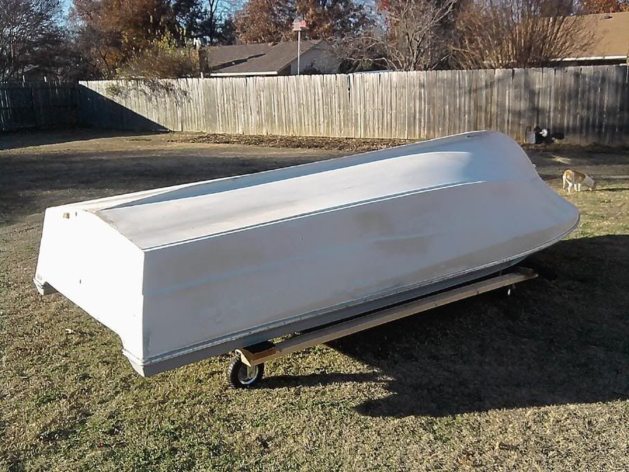

The Deck's all Painted.
And she's Flipped onto the Dolly

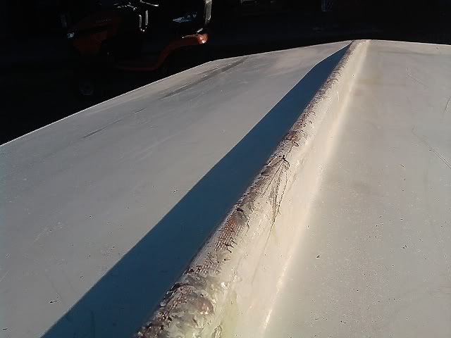

The Keel is gunna need some work

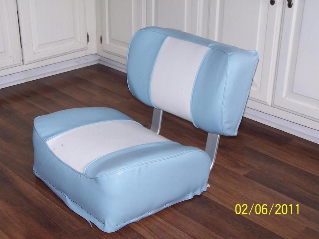

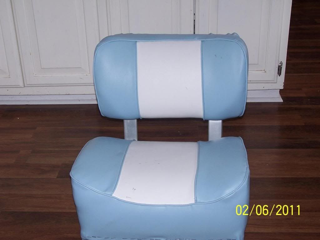

Well I made some videos of my sewing. Hope you enjoy.
And here's a pic of the final product.
I think it turned out pretty good for being my first time at sewing anything.
Next I'm gunna fabricte some bench seats and hope to make em look like these, except in blue and white.
Thanks go out to Andgott. He helped a lot with encouragement and tips on setting up the sewing machine and sewing techniques.

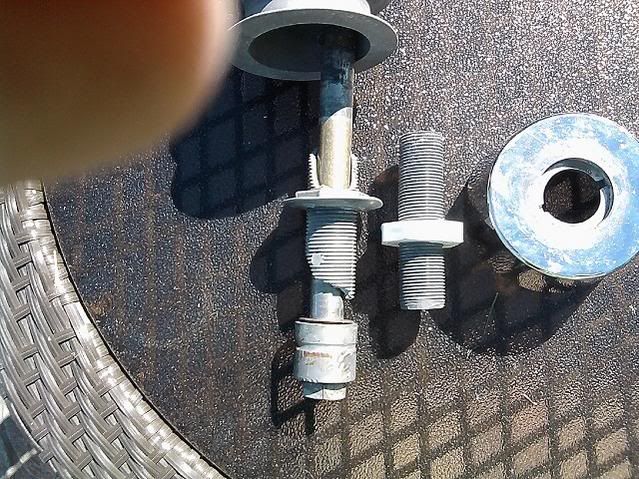

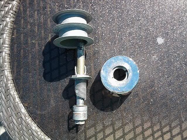

Before the flip I stripped everything off her. Had a Terrible time getting the Steering wheel off and it broke. I bought a replacement off of Ebay that wasn't an exact match so I will have to do some adaptation. The first thing I did was paint it to Match my color scheme. I think it came out ok.
The sleeve was made out of pot metal and it also broke
So I had to get creative. I bought a 3/4 inch 6" piece of Schedule 80 PVC Pipe(.79 Cents), a 1" Die to cut some threads($12), a 1" to 2" Threaded adapter($1.29) to cut off the NUT portion and Voila' a NEW IMPROVED Steering Shaft Sheath.
I am a big time purist and plan on keeping the old cable steering. The cable is in pristine condition as well as the pulleys and springs. I'm sure it will be fine when I'm finished.

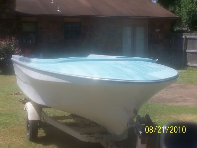

The Blue Flamingo is ALL DRESSED UP for the BALL!!! Final Coat of Color is ON!! I think she is BEE-U-TEE-FULL. Had some issues. I was 5 minutes from being done when the fitting on my air hose started spitting water on the bow of the boat. Needless to say I was NOT happy. But I sanded it all out and re-shot it and Now it is PERFECT. I am very Pleased. The picture of the Dash (pic #3) most accurately reflects the Real Life color, and the SHINE she has. I used Rustoleum Oil Based Paint with 85° Acrylic Enamel reducer and Acrylic Enamel Hardener. Paint is Hard as Nails in 4 hours. Very Glossy. Next is installing the Lights, Horn, Steering and wiring harness and doing all the electrical under the dash. May be a while Oklahoma HEAT WAVE. 105° in Tulsa Today.
(Click the Pics to Enlarge)
