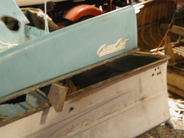

herters59 wrote:
Remove and replace
My '64 Skiflite 142's transom ply is almost that bad. I'm currently working at splitting the hull so I can dig it all out and epoxy new ply in.

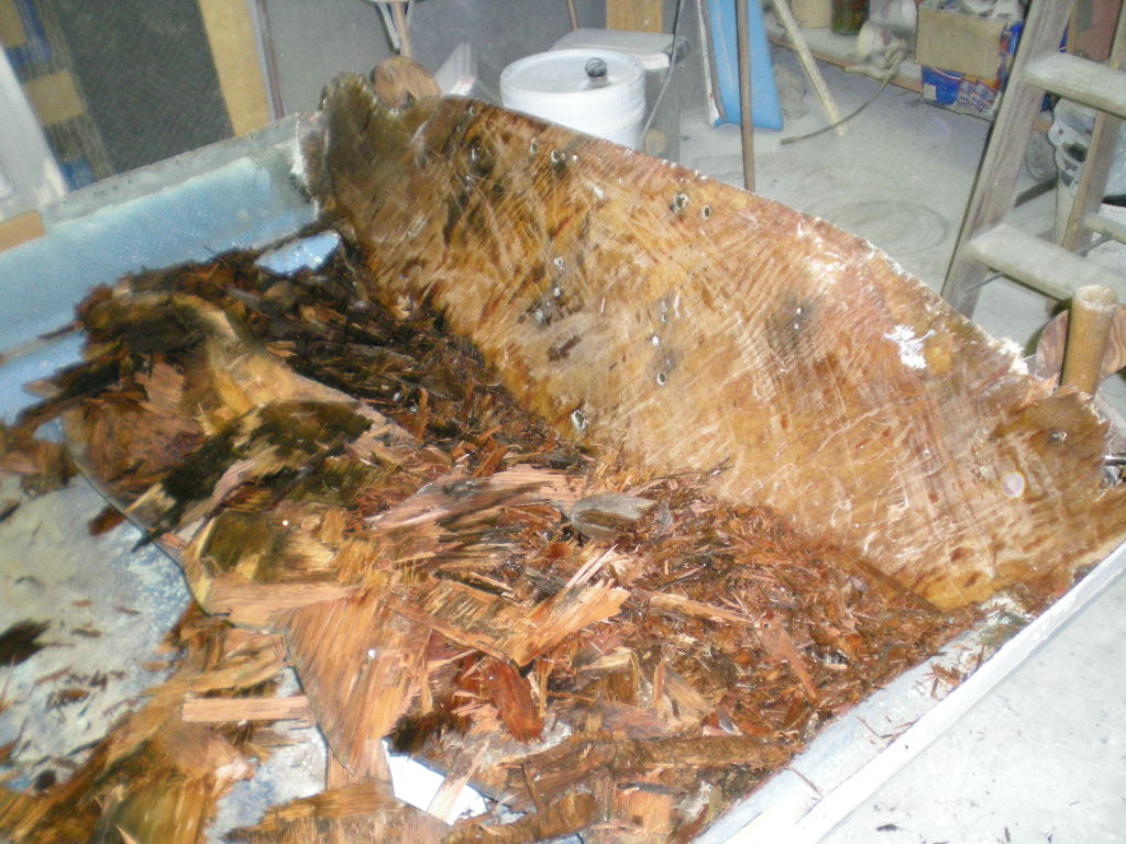

I'm beyond the "thud" stage, I grabbed an edge of (non-original) fiberglass skin and peeled it off, then grabbed a handful of "plywood" and pulled it out. I knew 12+ years ago when my brother last had it in the water that it needed a rebuilt transom. I'm just now getting around to it. I have various ideas about clamping the first layer in for a good epoxy bond. The later ply layers (3 x 1/2" total) can be screwed to the first when epoxying them in.
