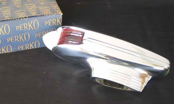

There were a couple of REALLY Nice lights on E-Bay that ended tonight. Many of them got kind of spendy- I scored a NICE one- But paid dearly-

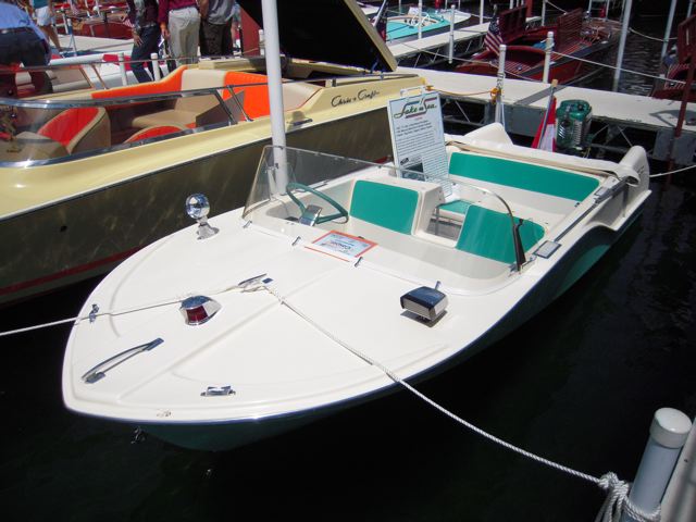

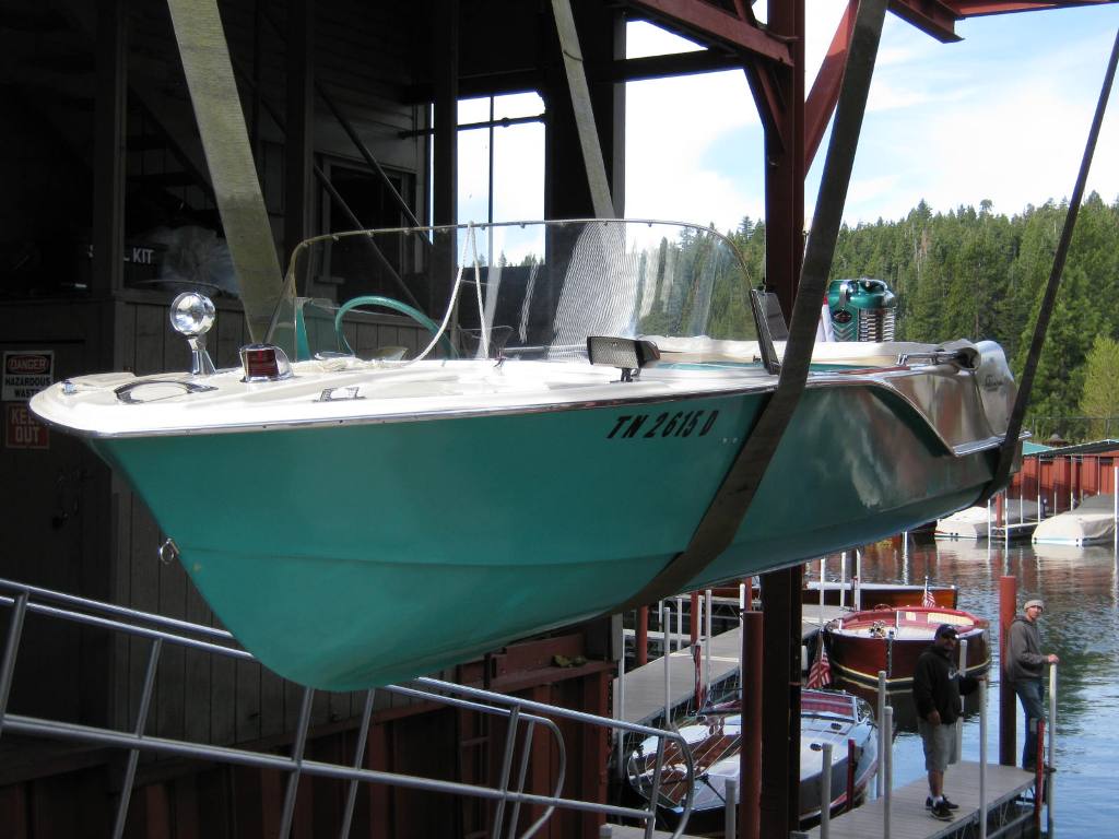

It went for more than I really wanted to spend, but I've got the perfect place for it- It is the closest thing I've seen to the missing bow light on my Volksboat. Of course, If I find the actual Volksboat light, I'll use that- But I don't think that's going to happen...
I'm REALLY thinking about 'investing' in a chroming setup... I've got at least one of each of the lights that was on E-Bay (except this one- I've never seen one of these!) they just need a rechrome to look as good as the ones on E-Bay... And, looking at what they go for on there, I could actually do it myself and save a bit :)
