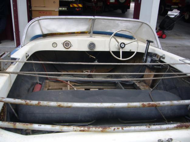

First nice problem will be the winshield, Broken.
Sterring wheel not the original.

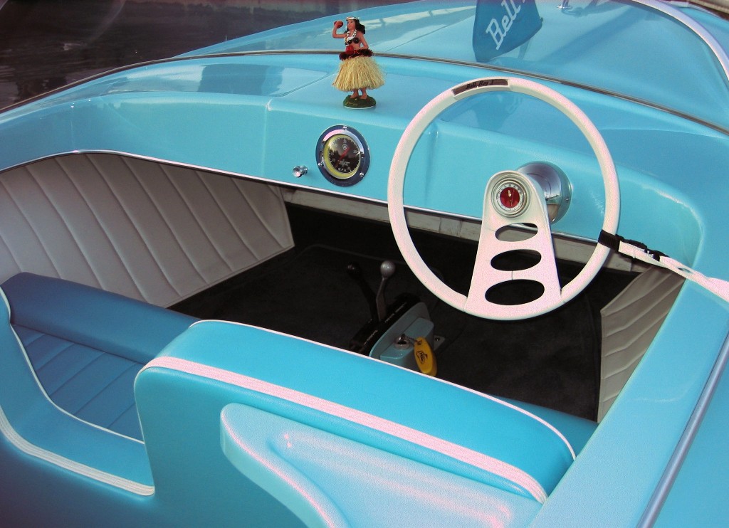

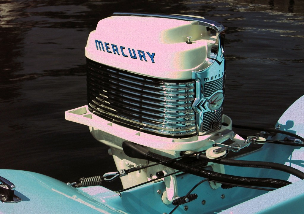

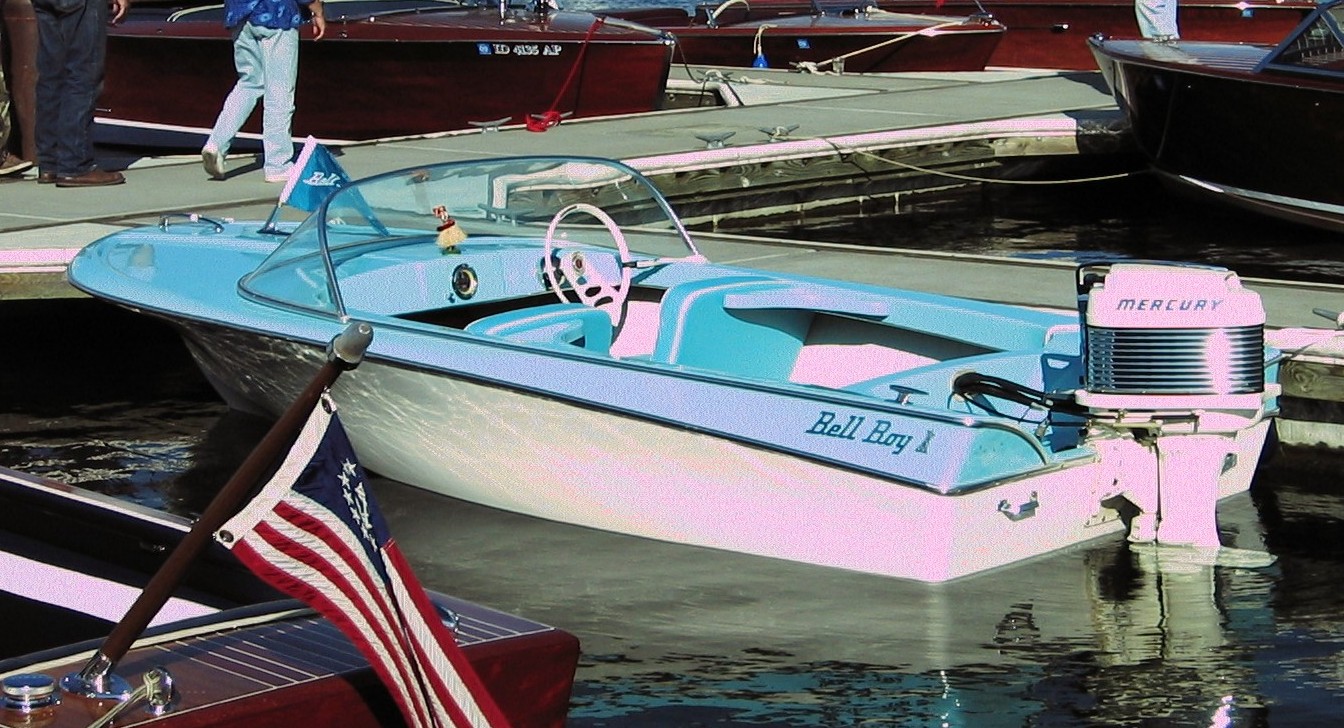

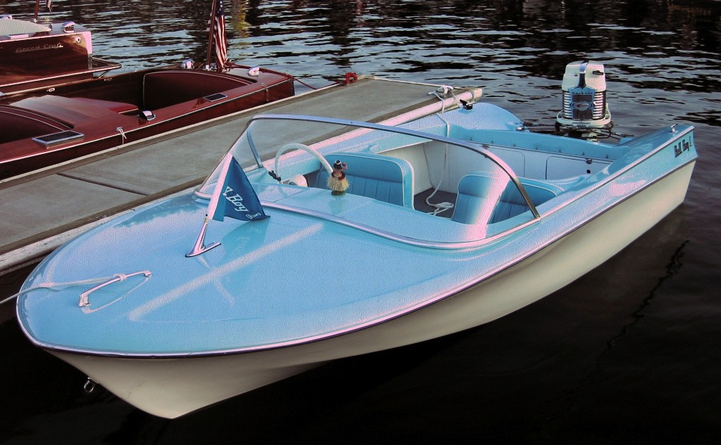

Not sure if this will help, but here are a few photos of a 1960 Bellboy Ballerina from a boat show in McCall, Idaho in 2009. The owner indicated that this was an all original boat.
Re:restore bell boy ballerina in Portugal 15 years 7 months ago #23914
  • Duke
  • Duke's Avatar
  • Posts: 14
Again...

that steering wheel is a very rare "vollrath" steering wheel,i have one in my 59 cutter jet de ville,i only know of 3 ,including mine and this one,at least this style of vollrath steering wheel is rare,john

Did Glasspar use that wheel in some G3's?

Do you think this type of sterring will look good there?

luv the controls on the floor.....ron

Thanks Duke.
Yes it does help, and a lot. These pictures together with the brochre can guide to restore the interior.
Most important.............. Motivation, shows me how it can look nice after some very serious work.

sorry guys i was talking about the steering wheel in duke's picture.
especially if it still has the center cap and name tag at the top.
neil im not sure but they might have.john

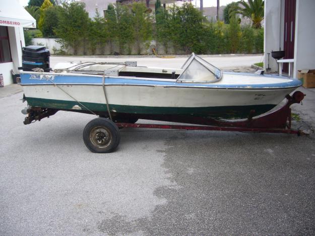

Started today to restore the boat as promissed. Got the hull ready to go into workshop to sand blast and paint it. Now struggling to find somewhere to have the windshield done here in Portugal, not easy.

The hull is in bad shape, the gel coat is comming off and in many areas we can actually see the fiber. I found a guy who is used in restoring boats and i think the final work wiil be great as i could see in other boats hw has restored. But you are right, not cheap, it´s going to cost me about 1200 euros but will look brandnew.

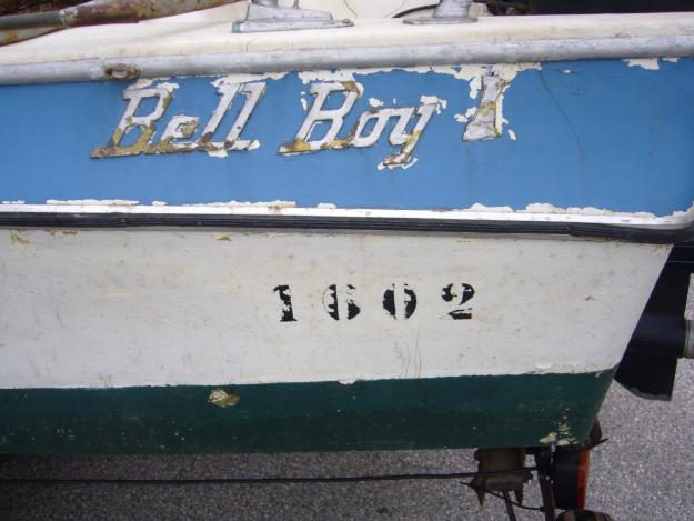

Hi sfumato,
at the moment I also restore a Bell Boy Ballerina.
Do you know where I can find the serialnumber or any number of the production? And I search for some spare parts (Lettering "Bell Boy")and so on. Can you give me some help with this problems?

Hello again!!!
Took longer then I expected, but finally assembling back my Bell Boy Ballerina.
I am putting on some photos of the Hull after being completly restored and painted.
This was two weeks ago.
I will keep on with photos of the work, so you boat entusiastics can keep up with the work done.
Gabriel
