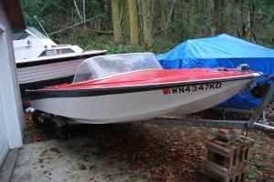

Maybe this is your old boat, it has been sitting a long time. There are not a lot of them around. I used to have one with a Merc 65 HP on it. It was way underpowered. I hit a large wake from a tour boat and split the bottom wide open. I looked at this one this summer at the old Northwood boat yard now Katz Marine. It would have been a really nice project. The gentleman who owned it brought it to the boat yard for an estimate to have it restored. If I remember right it was over 20 grand. Katz marine Restores old chris crafts for boat shows.

That 15 foot Jet-Star is only the second 3-point bottom Anthony I have ever seen. Where have they all disappeared (or biodegraded) to? Or maybe they just didn't make that many. I recently purchased a 16 foot Jet-Cat for a future restoration. My hull is good/clean but all bottom stringers and plywood floor need replacing.
My first connection with an Anthony 3-pointer was in 1960 or '61 when I got a ride in a new 15 foot Jet-Star; boy, did it ever impress this 'kid'! :)
