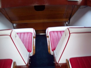

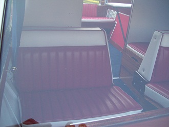

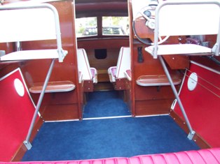

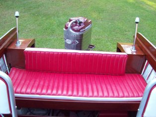

John and a few others have expressed some interest in a 'tutorial' showing how I made my boat seats... So, Today I did a little 'practice' seat, so I could take step by step photos of how it's done.
This is what we're going to end up with-
It's a basic, plywood based cushion, like you'd find in a seat. The same basic design could be used for seats, seat backs, settees- wherever. Of course, this one is smaller than most you'd make for a boat- But you just need to size it to however big you need...
