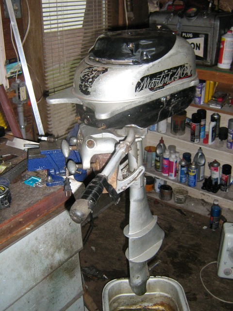

I finally got around to working on a 1950 Martin 40 that I picked up a long time ago. But one of the first thing I found was the spark plugs. All the catalogs I,ve checked say to use a J8C Champion plug but I found these to be too long and hit the casing. Doe,s anybody else have one of these and have they found a alternate plug? Thanks for any info.

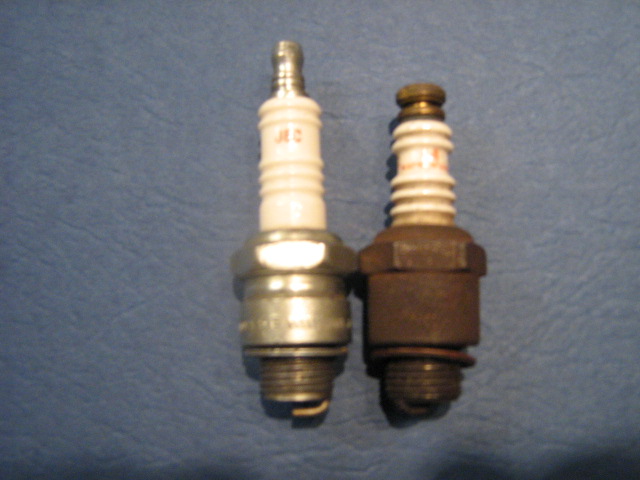

You can see the diferance between the original plug and the replacement. With the boot off I maybe have 3/16" clearance it's actually the gas tank it hits.I was hoping for a shorter plug or maybe a different brand that will be shorter.

The one on the right is a J8. The other is a J8C the new replacement.
