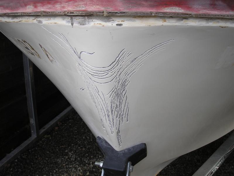

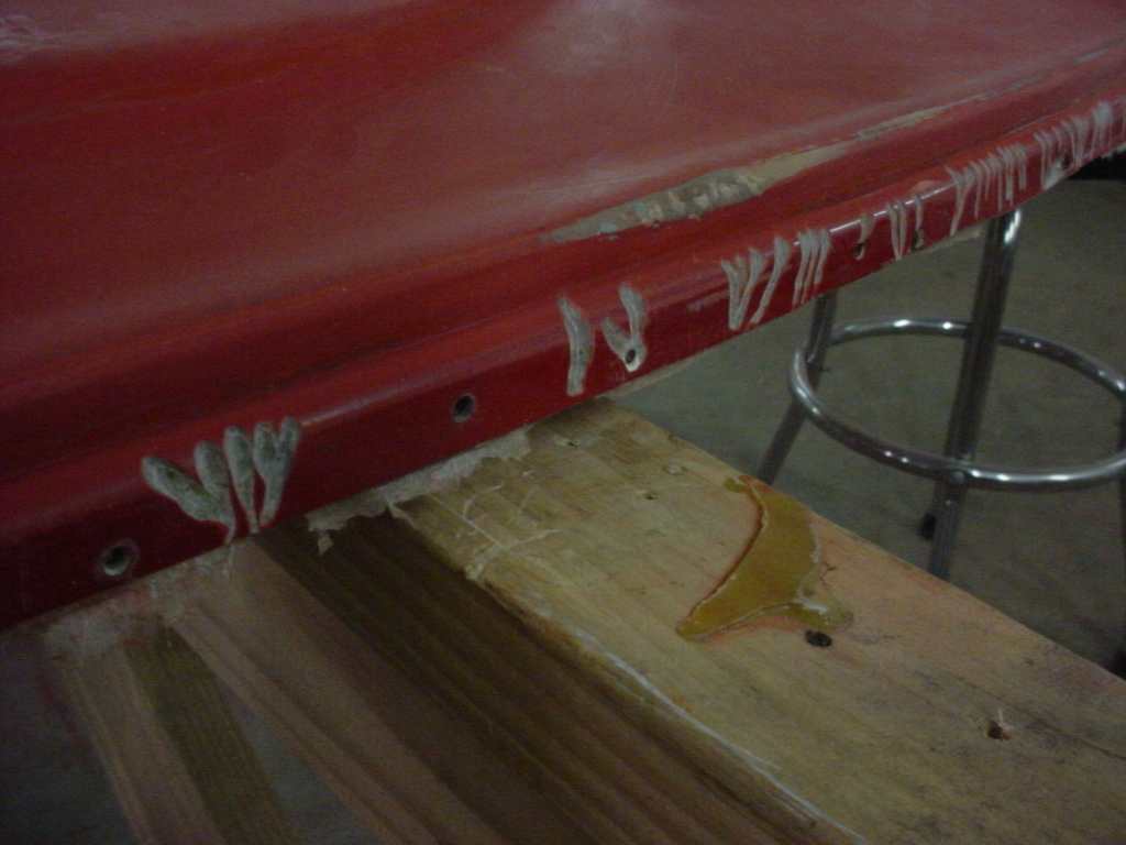

Grinding out all the little stress cracks with a dremel tool. slow going. ugh!

On this one I used a cone shaped rock bit. The cracks were VERY small and under the rubrail, but I didn't want to take any chances in them coming back later. I will fill them with pieces of fiberglass stranded mat/resin.

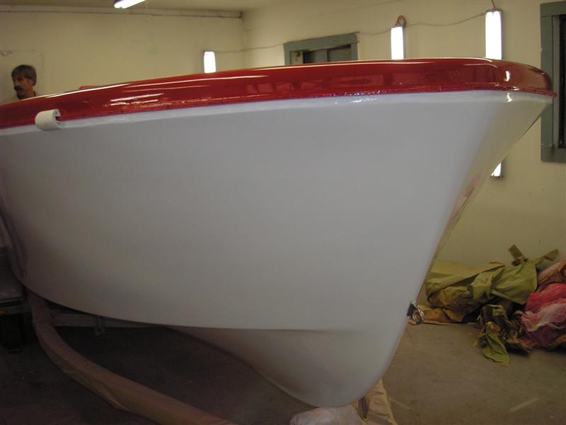

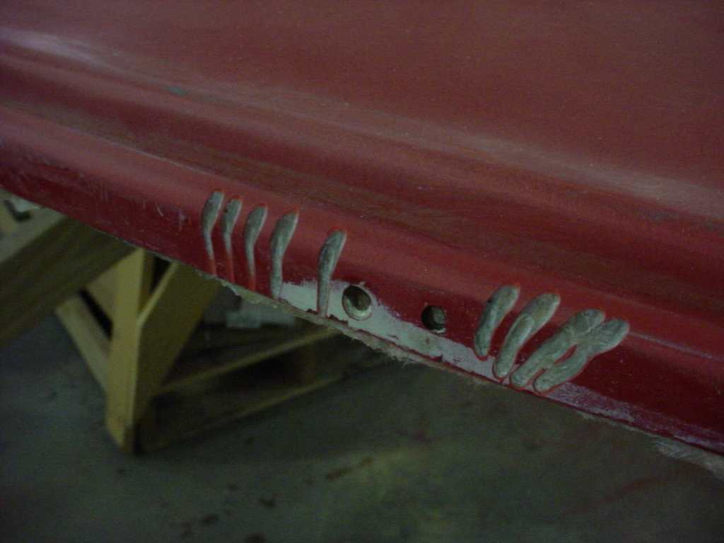

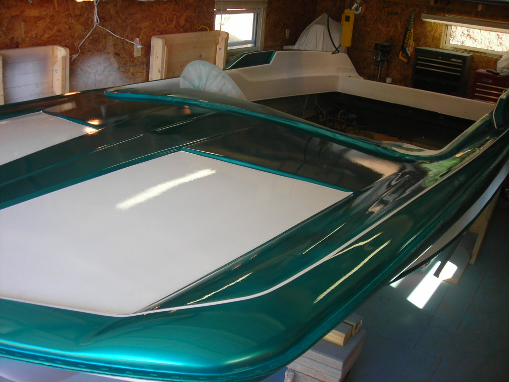

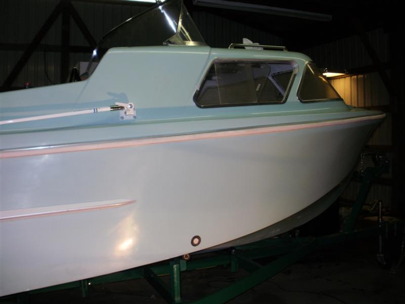

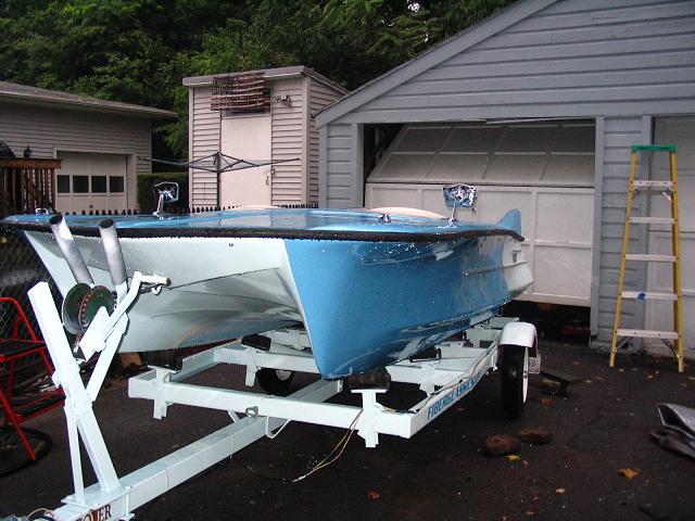

This is another boat I did but this time I filled with with Bondo with fiberglass strands because I was going to paint the boat. This was sprayed with Sterling paint

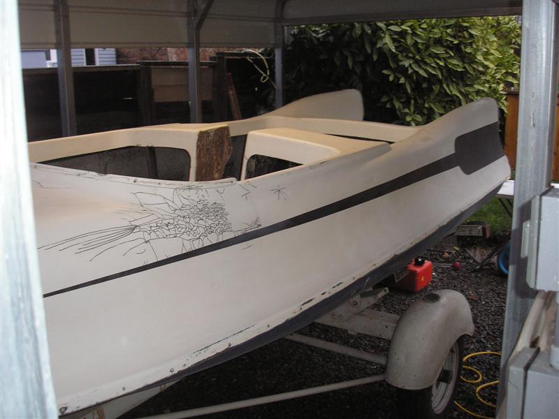

when i do stress cracks,for medium cracks i use polyester fiberglass resin,its works just like auto body filler but made for boats.easy to use and sand smooth.
and for tiny crazing cracks i just use epoxy filler primer,one coat, sand then another coat, sand and so on until its all smooth.dont use spot putty.it shrinks overtime.

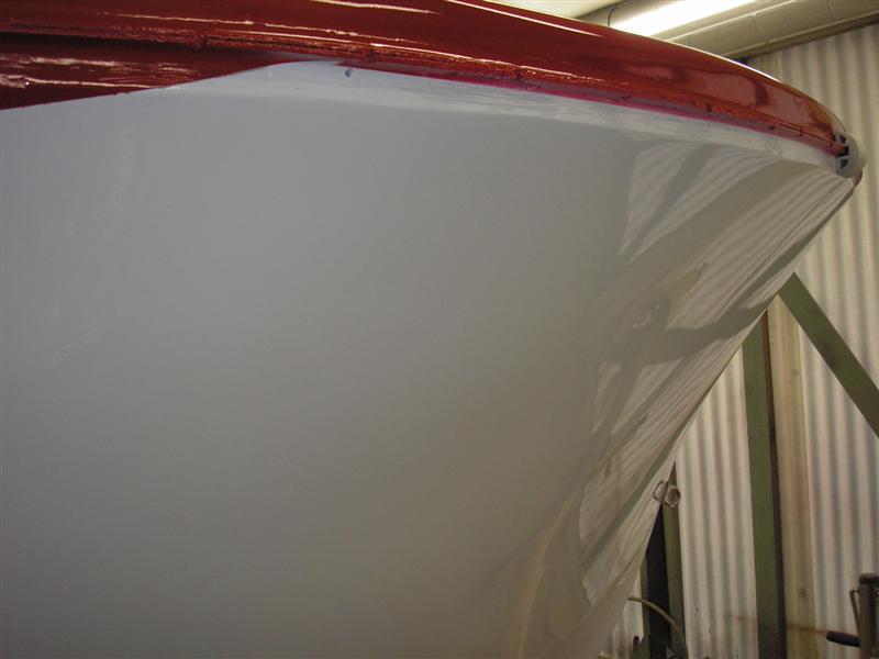

darn,its hard to see the gelcoat cracks n these pics,this is where i used filler primer

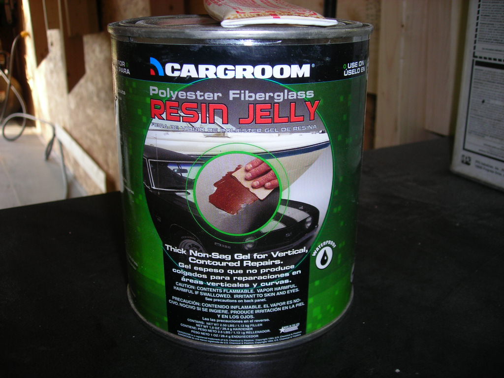

this is the putty i used.

I've alway just used mat/resin to fill mine with and have never tried a filler with strands in it. I've used the "kittyhair" as it's called before, but not on cracks. I've seen it crack with age so I was always afraid to try anything else. After cutting out all the cracks I take some 80 grit and feather the edges before laying the glass. Then I just grind it all flush to the original. I'm open to any and all ideas though, especially the ones that have seen good results after a few years under regular use.

I'll have to try the Fiberglass Resin Jelly - GREAT NAME sure looks like what you would want to use !!

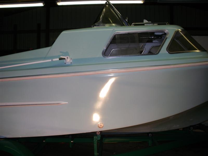

I got married in Gulf Shores Alabama then drove her back home to Bellingham Washington. Home of Uniflite and Bell Boy boats and about 30 miles from the home of Skagit Boats Heart of the San Juan Islands . If you ever get up in this neck of the woods look me up ? That goes for anybody out there that likes to go boating ! This is Bellingham Harbor and my friend John's Dorsett San Juan

Ok, I've been sick with the flu for the last week so nothing has progressed on the deck. I have been reading everyone's posts and wanted to see if anyone had repaired damage like this with "kitty hair" or resin jelly (I personally hate resin jelly) and had good results a few years down the road. I might be persuaded to try something new as long as I won't end up having the boat come back for me to redo the repair 2 years down the road.

hi doug,i personaly wouldnt use the resin jelly if the cracks are pretty big and deep,i would use your kitty hair method,then fill the top with the jelly resin,it sands smoothly no need for spot putty,which i definaly dont use,because it shrinks with time.john

Yeah, I don't like the idea of using resin jelly on anything thick at all. I've just always reglassed, but I am curious to how a fiber filled filler would hold up over time. This boats going to be used for skiing and family fun so it will take some beating over time.
