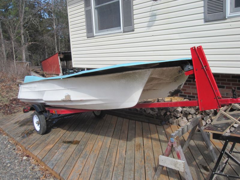

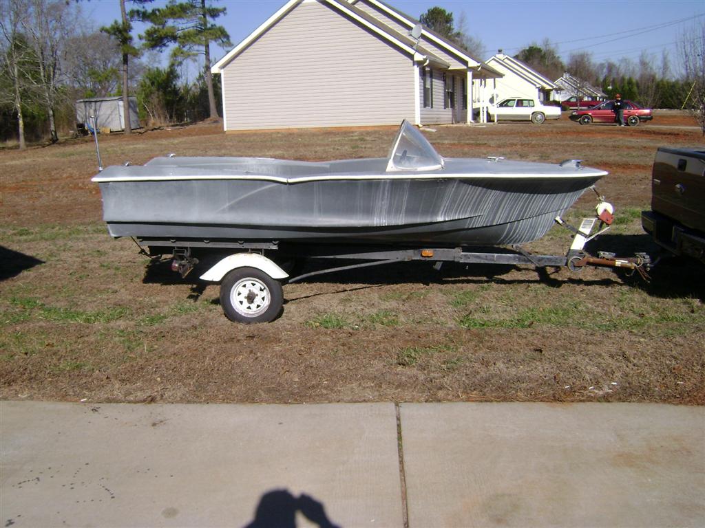

Finally got my new project home this evening, too dark to get any pics so I'll post the ones that were in the ad in the Glassifieds. It's definitely a project boat, but I'm enthusiastic about getting a closed bow runabout, with fins! (Stubby, but they're there.) Jon A delivered it to me at work yesterday, but I had to get the lights working on the trailer before towing it home as it gets dark before I get there. She pulled like a dream down the highway, but the shocks are shot so a little bouncy. I hope to get the trash cleaned out this weekend, and find a hull ID# somewhere.

Wow... That's a good looking project Mark! Can't wait to see the progress on it.

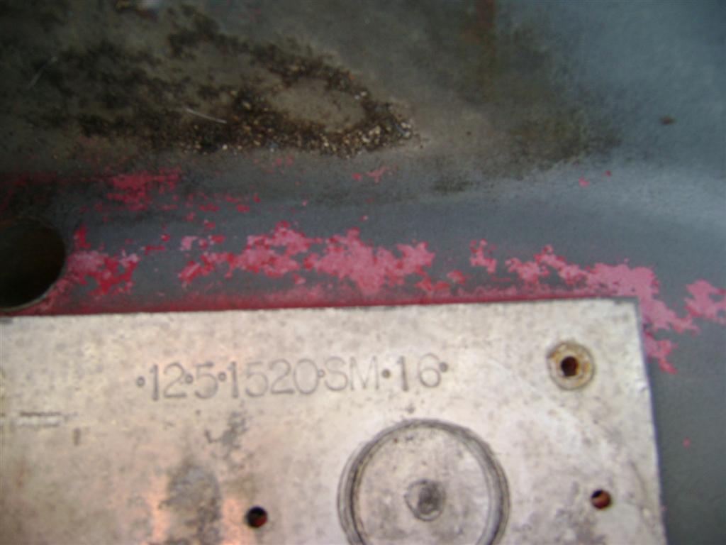

You're likely to find the ID # on the aluminum transom plate, IF it's still there... It'll be stamped on there. It'll be interesting to add it to the 'archives' over at nickel city classics- Especially to see it fits in the 'sequence'...

Jon and I looked all over the transom Andrew, we couldn't find any numbers anywhere. It looks to be the original trim pieces back there, but who knows. It may turn up after a good cleaning, the old girl is pretty nasty.

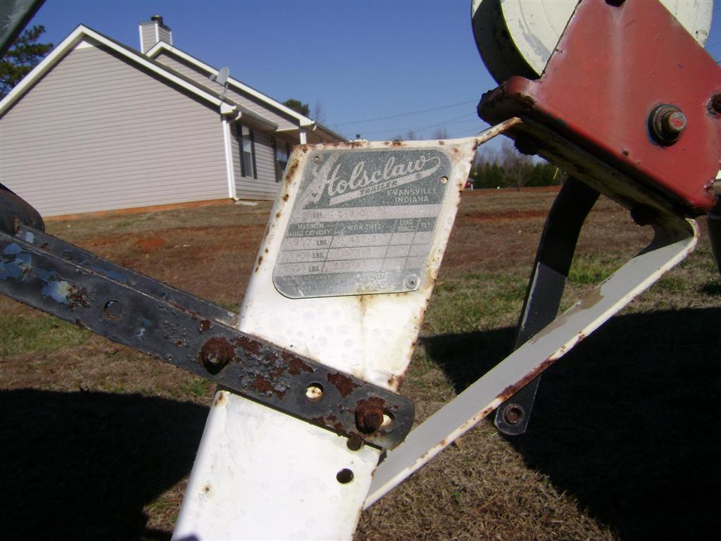

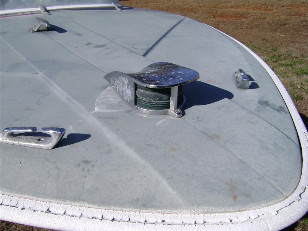

The Holsclaw still has an ID plate on the winch stand, I've never seen one like it before. It give model number, weight ratings with various tire/wheel combos, but didn't see a serial number on it either. Investigation time.

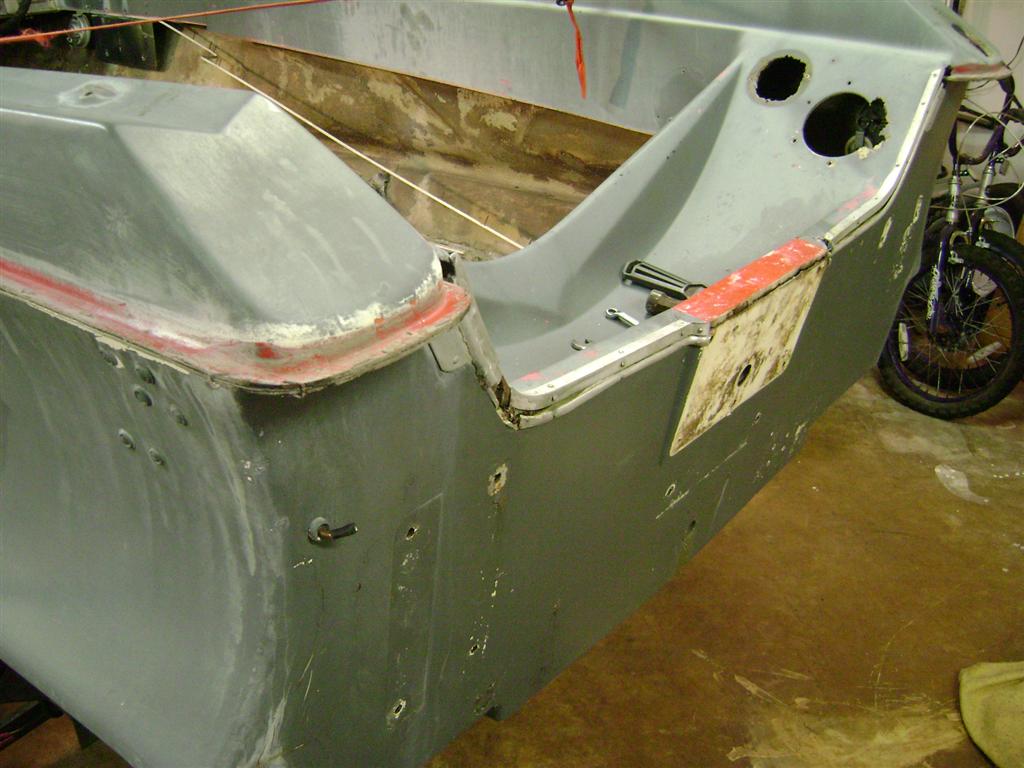

CONGRATS, Always liked the color of that rig, cant wait for a pic when you get a section polished. . Think you need a quick cover for Sunday night , weatherman sending more SNOW YOUR REGION.?
In your transom picture IF the 14" center Cap Plate was delivered to you , that is where MFG ID is Indented.? Small 1/8 " #'s imbossed in right , Inside edge , Up Side down. . LOts of scratches over the years may need fine emery paper , or look at glancing angle. Maybe format 10-11-0123 - SR

Hope you find some numbers.
This is what they looked like on Cheryl's boat:
Yours looks like a little later model.

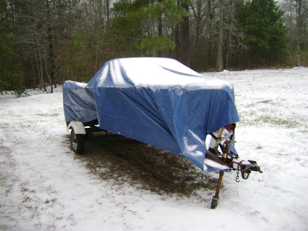

That's second on the "to do list" Larry. First is clean out the junk and make a dump run, then get a cover over it by tomorrow. (They're now calling for 5-8" of snow here, changing over to freezing rain and sleet Monday morning!)

Thanks John, it's gonna take a ton of work but I think it will be worth it. (To me, anyway!) Found the ID# and took some pics this morning;

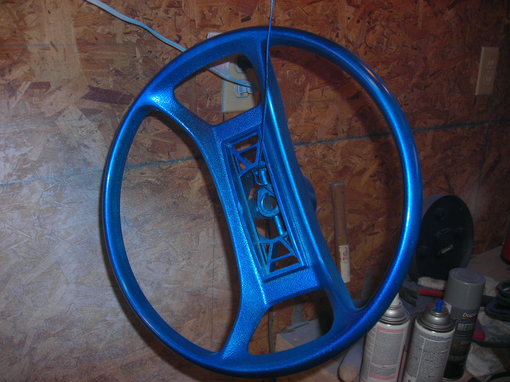

mark,it definatly will be worth it,i love the lines,i could have alot of fun painting that boat,2 or 3 tone.
that hardware is the same as on the sunray,i see the bowlight on ebay alot,thats where we got ours.
wefco carries a white rubrail that fit the sunray pretty good and would probably fit yours too.
if you need a new steering wheel i have one,its the one i painted blue,but i can paint it any color you want,if you want it let me know and its yours for free,john

Thanks for the info on the bow light and rub rail John, and the offer for the steering wheel. You've already been too kind-hearted to me, and it will be some time before I get to the point of needing a wheel. The inspection and assessment process is kinda on hold right now, as you can see below! (That's not snow, it' sleet, which is being followed by relentless freezing rain.) I'm not about to move the Glastron outside in this mess, so the CC will just have to wait patiently. LOL

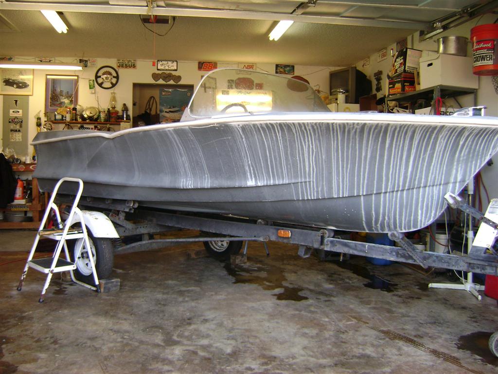

Re:Custom Craft Sea Ray 15 years 5 months ago #25019
  • MarkS's Avatar Topic Author

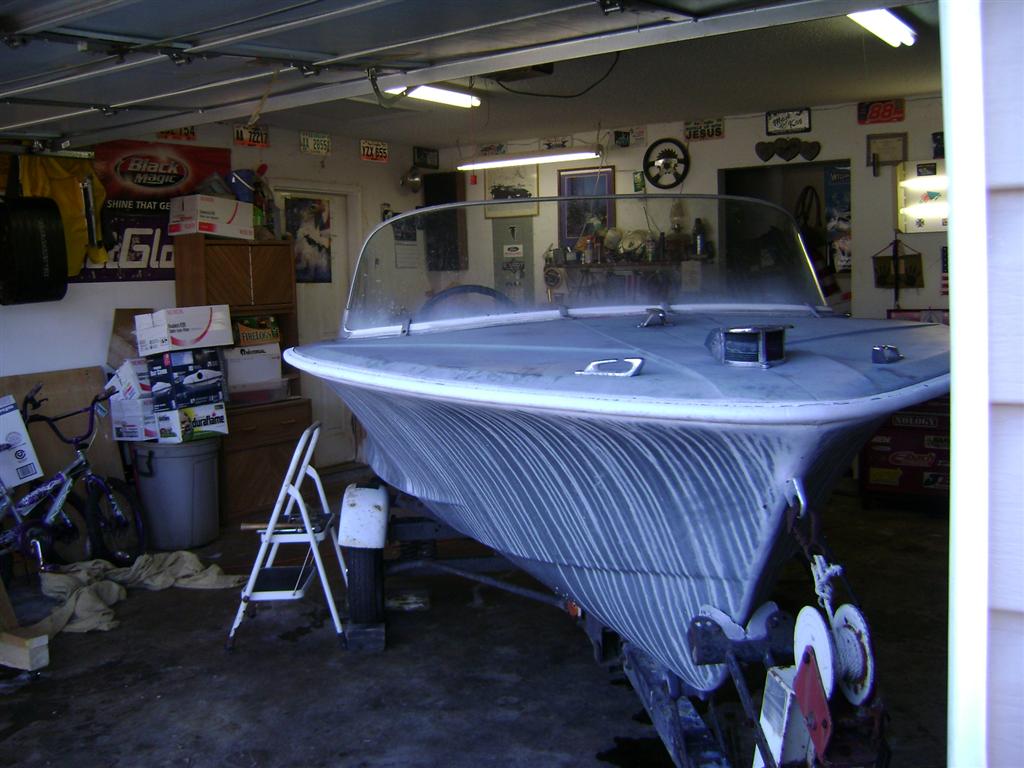

Finally got the CCSR moved into the garage, time to get "down and dirty". I like being able to work on the Merc a while, and move over to working on the boat when it gets a little tiresome or waiting for parts. (Just gotta remember to cover the motor when creating dust, etc.)

M: Good deal .. Valentine's Day Bath tomorrow..? Mid 60's temps all week . Got some wax on my new Brown baby. Interior varnish on Monday. . Yes I have motor check out also to evaluate. Title coming Snail mail, BUT also a engine parts manual (?).

Glad you could get her into the garage to work on. I like the idea of being able to go back and forth between the tower and the boat. By the way, you've got mail.

Larry - Yes, a bath is definitely in order as soon as I get the "crud" all scooped out of the inside. Probably won't happen until the weekend though.....

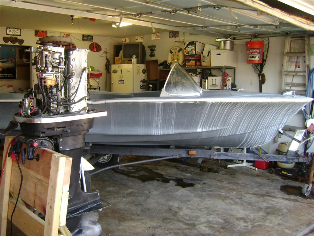

Re:Custom Craft Sea Ray 15 years 5 months ago #25076

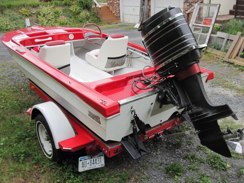

Mark, where did you get that big old merc?!?

I got lucky (for a change) on Craigs List and found the Merc about 60 miles from home Frank. There's a thread in the Merc forum on the acquisition and first evaluation on my motor; www.fiberglassics.com/glassic-forums/mercury-outpost/merc-1000-on-cl-what-do-you-think

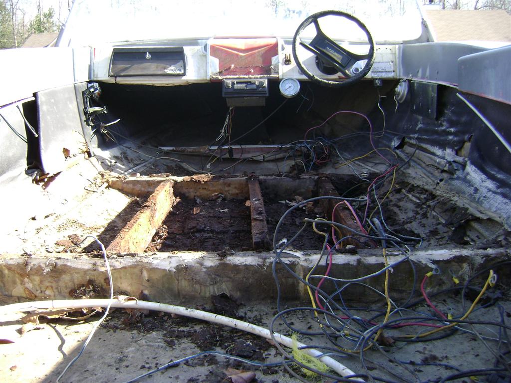

Re:Custom Craft Sea Ray 15 years 5 months ago #26410

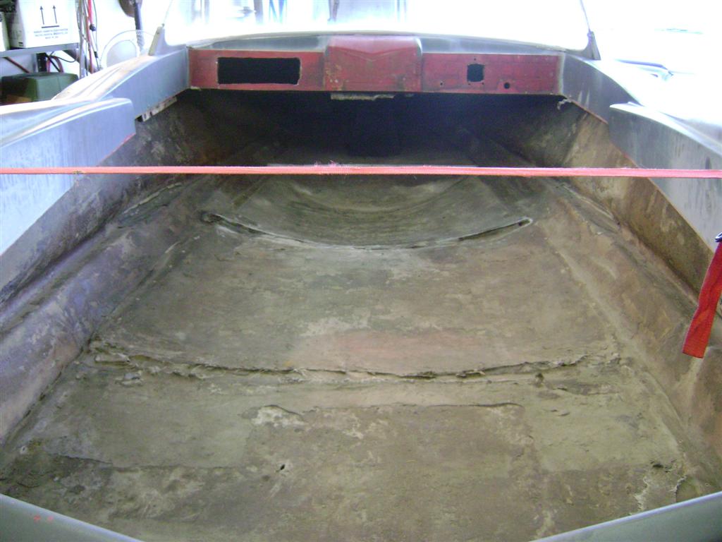

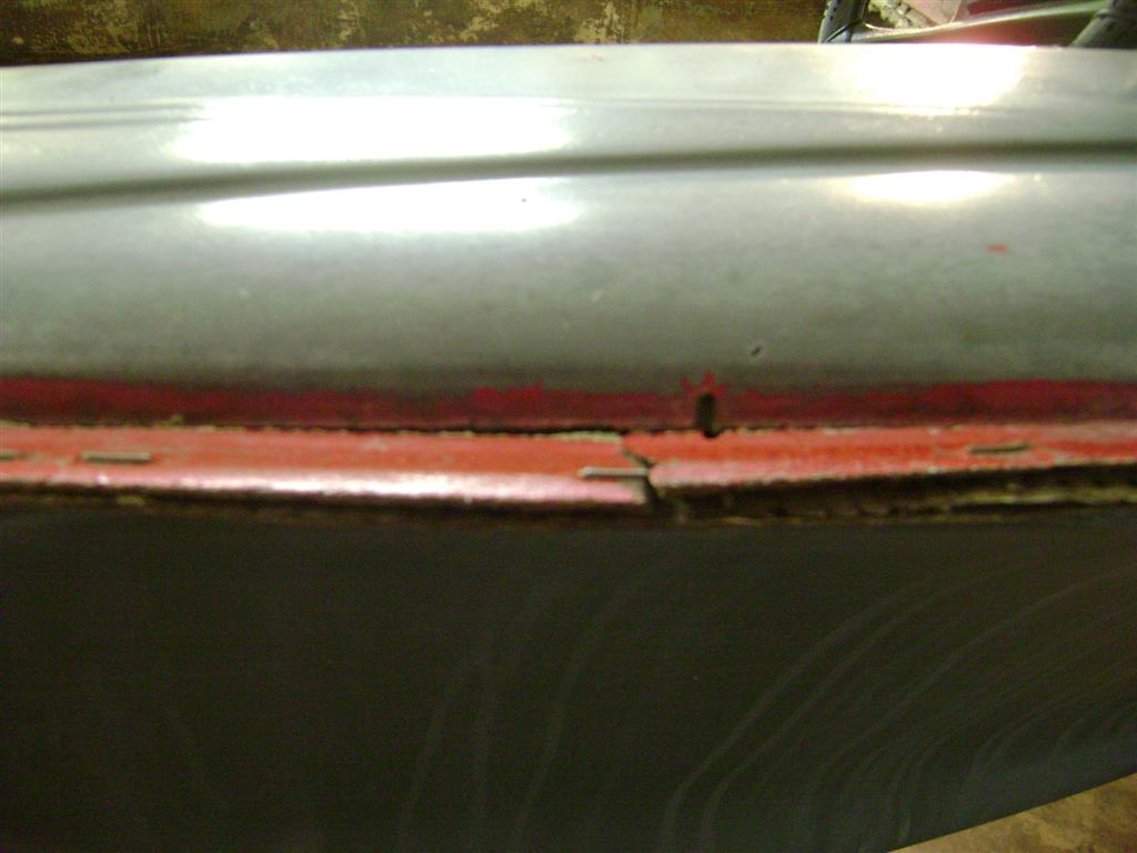

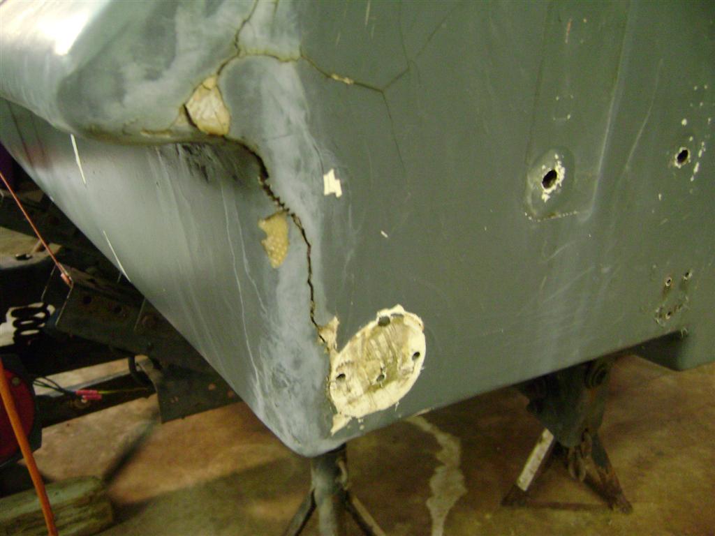

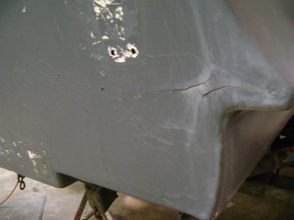

Finally got a chance to finish cleaning her out, got most of the junk hardware off the transom; Fiberglass repairs needed
Re:Custom Craft Sea Ray 15 years 5 months ago #26411

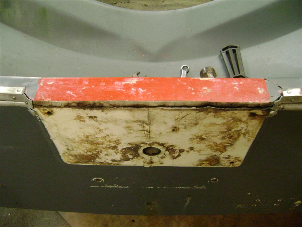

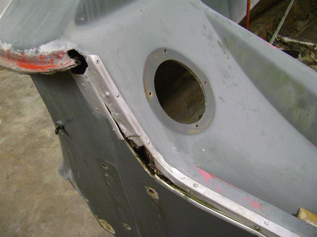

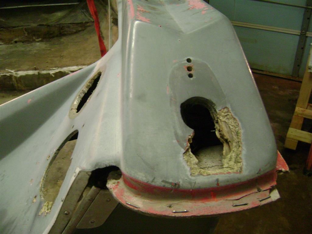

And some structure issues inside the transom; I would welcome some advise here on how to proceed with transom replacement. I know the deck should be pulled off, but with that much damage on the outside, I'm beginning to wonder???
Re:Custom Craft Sea Ray 15 years 5 months ago #26421
  • Andgott
  • Andgott's Avatar
  • Posts: 1245
  • Karma: 72
Looks like you're making some progress! You are almost to the stage where you'll step back, and say "What the HELL did I get myself into?" then, you'll get a bit farther along, and realize that it's all worth it :)
I can see a lot of similarities between that boat and my Custom Craft (a Tiger Ray), in the construction, as well as in the repairs that she's going to need- They are (were) even the same color! Though yours looks a bit worse off than mine in a few places.
It looks like a cap removal might be in order- It appears that the transom is going to need some repairs and probably some reinforcement. It seems that a lot of custom crafts were kind of underbuilt- they had some VERY complicated hull shapes, which were probably tough to build 'right'. I also think that a chop gun was used on a lot of them, rather than hand layup, due to the complexity of the hulls.... Which also made them weaker.
When you take it apart, do so carefully- It looks pretty weak back there. Support the hull well, too. It's going to sag, and you want it to all go back together again... You'll want to repair the 'lip' all the way around, it looks to be cracked in a few places, and it'll likely break in a few more spots when you seperate it.
Once you get it open, you'll have a better idea of what's going to be needed to do the transom right. Figure the ply is probably rotted out...

Oh I'm there with the "What the ...." Andrew! Thanks for the encouragement though. I'll take a break and revisit the rebuild in a few days. I'm thinking hard about raising the transom height to 20" for several reasons. I can then use my Merc 1000, less likely to swamp with the added height, and since it's gotta be rebuilt anyway....

M: I thought those staples looked familiar.. I am not a big fan
of lifting off the front deck.. Like you said if the transom height is being raised , just surgically cut the splashwell in a way to
reuse most of it. (Even two angles ,instead of straight across )
If you are doing away with pulley side steering can close up the left side circle. The right side may be smaller circle or needs re position, even forward (?) for a teleflex cable.. Maybe you were going hydraulic steering.
Part of the hobby to show your workmanship or design refurbish. A trip to Chatt to see all of Andrews collection would be worth while.
